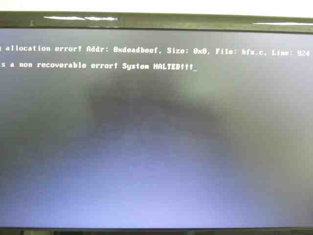

luxinhaus Posted March 25, 2015 Share Posted March 25, 2015 (edited) @ErmaC Hello again... found another issue on my old ICH7 board revision i tried: 2633 up to 2643 Last know working for me was 2529 Can you list all revision you would want me to test so we can pinpoint the bad commit Thanks Edited March 25, 2015 by luxinhaus Link to comment https://www.insanelymac.com/forum/topic/231075-chameleon-24svn-official-pkg-installer/page/111/#findComment-2122805 Share on other sites More sharing options...
ErmaC Posted March 25, 2015 Author Share Posted March 25, 2015 @ErmaC Hello again... found another issue on my old ICH7 board revision i tried: 2633 up to 2643 ich7error.jpg Last know working for me was 2529 What revision would you want me to test so we can pinpoint the bad commit Thanks Hi luxinhaus. Sorry but I'm really busy... Pls this are the changes for the trunk starting from 2529 until 2558 tonight or tomorrow I try to see where the issue id located. 2.558 Improve GMA detection for HD4x00 HSW cards. 2.557 Added new IDs for nVidia cards. 2.556 Refactor function patch_nvidia_rom (Credits Clover Team) 2.555 Update HDA data for internal HDAEnabler injector 2.554 Typo. 2.548 Move define stuff from cpu.h to platform.h 2.547 Update cpu define (Bungo) 2.546 Typo 2.545 Temp. comment out .IABootFiles hidden folder on boot partition. (credit Bungo) 2.544 Added Logging start time (credit Bungo) 2.543 Improve detection for HD4200, HD4400 and HD4600 (gma.c) 2.541 Added getRTCdatetime() Int 1Ah function 02h - RTC service (Credits to Bungo) 2.540 Typo, indenting and whitespace 2.539 Typo, indenting and whitespace 2.538 Typo (Credits to Bungo) 2.535 Use caching with ExFat filesystem by Zenith432 2.533 Update Chameleon.xcodeproj 2.532 Add sectorsize utility by Micky1979 see: http://www.insanelymac.com/forum/topic/302764-sectorsize-v11-a-tool-to-detect-the-physical-and-logical-sector-size-of-hard-disk-advanced-format-supported/ 2.529 Update languages for pkg Installer ErmaC Link to comment https://www.insanelymac.com/forum/topic/231075-chameleon-24svn-official-pkg-installer/page/111/#findComment-2122898 Share on other sites More sharing options...
Bronya Posted March 25, 2015 Share Posted March 25, 2015 @ErmaC Hello again... found another issue on my old ICH7 board revision i tried: 2633 up to 2643 ich7error.jpg Last know working for me was 2529 Can you list all revision you would want me to test so we can pinpoint the bad commit Thanks Hi ! on your picture "size 0x0 file hfs.c" <-- you installed osx system on hfs ? Link to comment https://www.insanelymac.com/forum/topic/231075-chameleon-24svn-official-pkg-installer/page/111/#findComment-2122902 Share on other sites More sharing options...

ErmaC Posted March 26, 2015 Author Share Posted March 26, 2015 @ErmaC Please give me time on this as i do not have the computer beside me. I will post my findings maybe tomorrow Thanks No problem. I have marked the "safe" IMHO commit (ex typo only) Anyway I have compiled some of it ("AS IS" I mean directly from the SVN)... 2.558 Improve GMA detection for HD4x00 HSW cards. 2.557 Added new IDs for nVidia cards. 2.556 Refactor function patch_nvidia_rom (Credits Clover Team) 2.555 Update HDA data for internal HDAEnabler injector Typo. 2.548 Move define stuff from cpu.h to platform.h 2.547 Update cpu define (Bungo) Typo 2.545 Temp. comment out .IABootFiles hidden folder on boot partition. (credit Bungo) 2.544 Added Logging start time (credit Bungo) 2.543 Improve detection for HD4200, HD4400 and HD4600 (gma.c) 2.541 Added getRTCdatetime() Int 1Ah function 02h - RTC service (Credits to Bungo) 2.540 Typo, indenting and whitespace Typo, indenting and whitespace Typo (Credits to Bungo) Use caching with ExFat filesystem by Zenith432 2.533 Update Chameleon.xcodeproj 2.532 Add sectorsize utility by Micky1979... Update languages for pkg Installer ErmaC Link to comment https://www.insanelymac.com/forum/topic/231075-chameleon-24svn-official-pkg-installer/page/111/#findComment-2123155 Share on other sites More sharing options...
luxinhaus Posted March 27, 2015 Share Posted March 27, 2015 (edited) @Ermac I tried all the versions you mentioned all the way up to 2588 and its all good I currently have no xcode in this computer so i cannot test other revisions, but im definitely sure that 2617 has the error. Is it possible for you to send me those that might have the bad commit from version 2590 to 2616 please Il do it once i get home, but cant able to test it until Monday. Thanks Edited March 27, 2015 by luxinhaus Link to comment https://www.insanelymac.com/forum/topic/231075-chameleon-24svn-official-pkg-installer/page/111/#findComment-2123450 Share on other sites More sharing options...

ErmaC Posted March 29, 2015 Author Share Posted March 29, 2015 @Ermac I tried all the versions you mentioned all the way up to 2588 and its all good I currently have no xcode in this computer so i cannot test other revisions, but im definitely sure that 2617 has the error. === timerValue 2 intermediate 0x0000000024C011BC saveTime 0x000000001C4EDC0D Memory allocation error! Addr: 0xdeadbeef, Size: 0x0, File: hfc.c, Line: 924 This is a non recoverable error! System HALTED!!! === “Memory allocation error at line 924 of hfs.c” issue with r2625. As luxinhaus noted, r2588 has no problem. i386-2610.zip Typo (remove struct as already defined by typedef) 2.609 - Correct Kabini FB name was "Abini" - Changed cards IDs order now is low to hight - Add new cards ID (kNull FB) 2.608 Add IDs for GeForce GTX 960 and Quadro k1200 (nvidia.c) i386-2607.zip Indent 2.606 DEBUG option for last booted partition 2.605 Temp disabled feature introduced in commit 2562 (Added ability to auto-select last booted partition as the boot volume), cause AllocateKernelMemory error. i386-2604.zip Fix instant restart after kexts are being force loaded (Introduced from commit 2561) 2.603 Sanitize 16-bit assembly (Merge from Zenith432 branch) i386-2602.zip Fix bug in malloc_init, use bios for enableA20() (Merge from Zenith432 branch) 2.601 Update ATI/AMD gfx FB (Credits to pjalm) 2.600 Update Intel gfx cards IDs. 2.599 Add visible output on bad kernel compression. i386-2598.zip Slightly improve decive selection name - add os version. (credits to meklort) i386-2593.zip Typo. i386-2592.zip Merge Interrupt Management changes from Zenith432 branch 2.591 Fix KernelPanic for x32 machine located in fake_efi.c (Big thanks for testing to luxinhaus) 2.590 Typo. ErmaC Link to comment https://www.insanelymac.com/forum/topic/231075-chameleon-24svn-official-pkg-installer/page/111/#findComment-2124065 Share on other sites More sharing options...
luxinhaus Posted March 30, 2015 Share Posted March 30, 2015 @ErmaC Im back The bad commit was in rev 2602 4 Link to comment https://www.insanelymac.com/forum/topic/231075-chameleon-24svn-official-pkg-installer/page/111/#findComment-2124182 Share on other sites More sharing options...
