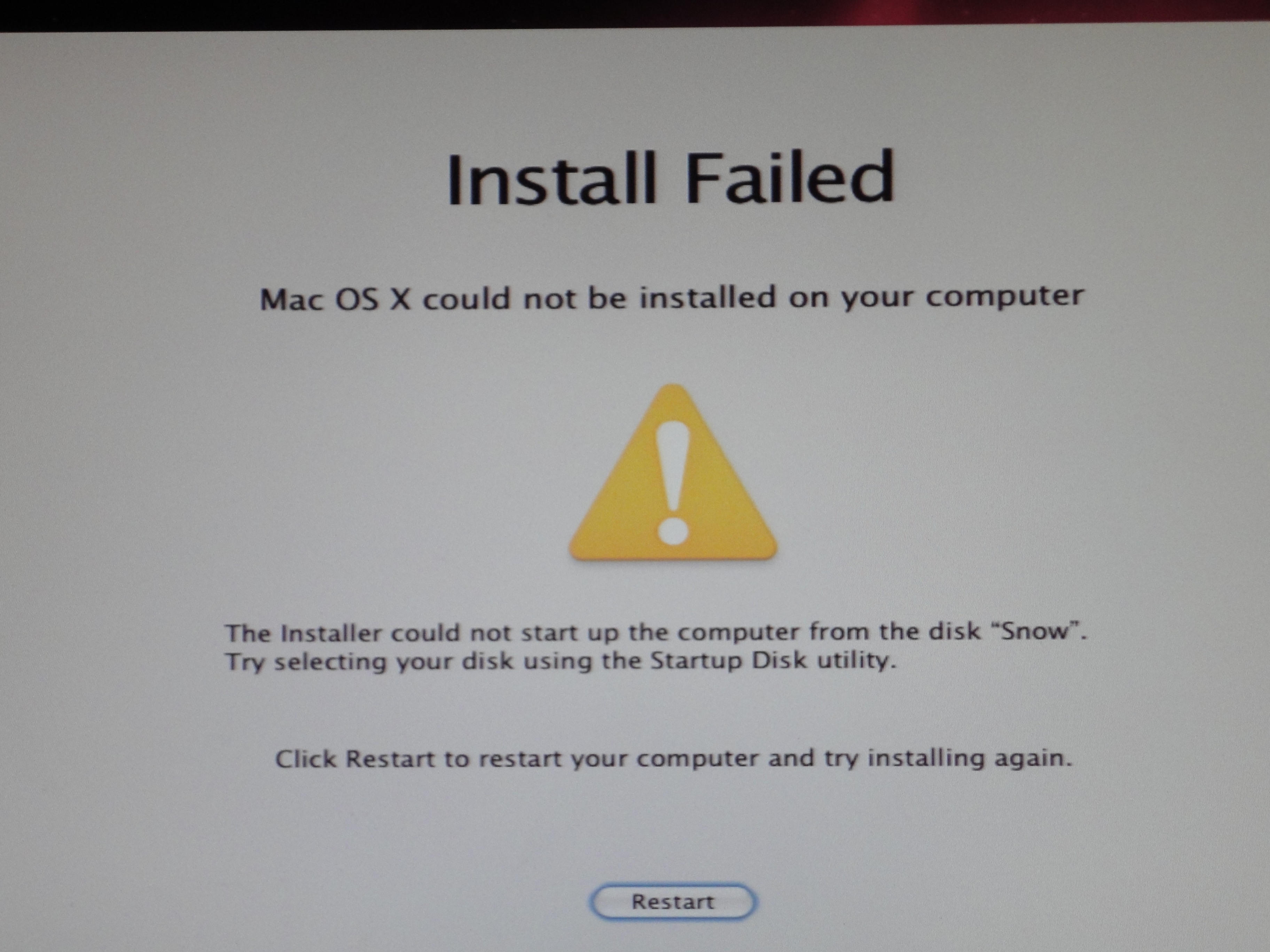

cbgugu Posted September 23, 2010 Share Posted September 23, 2010 yes you can it is from ide kext is un stable will replace it but better to use sata dvd I just got me a sata dvd drive and it is still a no go toward the end of the Snow leopard install i get the following message. I use SL retail disk 10.6.3 could that be the problem? Link to comment https://www.insanelymac.com/forum/topic/227592-amd-and-retail-snow-leopard-1065-1068-finalguide/page/9/#findComment-1553151 Share on other sites More sharing options...
tsj5j Posted September 23, 2010 Share Posted September 23, 2010 I just got me a sata dvd drive and it is still a no go toward the end of the Snow leopard install i get the following message. I use SL retail disk 10.6.3 could that be the problem? This is perfectly normal. Since the kernel is modded, the installer will throw this error at the very end. Just reboot and continue on with the tutorial. nearly you run your mac on safe mode -xi linked above updated kernel work on 64bit if you readed it I tried the legacy kernel, and OSX didn't detect my HDD #2 and HDD #3. I had to turn off AHCI and change it to IDE for it to detect my HDD #2. When I use the legacy kernel, Quicktime crashes when I play h.264 videos. Any solution? Valve/Source games use Quicktime to play in-game videos and as a result the games crash. Link to comment https://www.insanelymac.com/forum/topic/227592-amd-and-retail-snow-leopard-1065-1068-finalguide/page/9/#findComment-1553166 Share on other sites More sharing options...

Mohamed Khairy Posted September 24, 2010 Author Share Posted September 24, 2010 I just got me a sata dvd drive and it is still a no go toward the end of the Snow leopard install i get the following message. I use SL retail disk 10.6.3 could that be the problem? if it fail at the end of setup like .5 cm before end it is normal it is due to legacy kernel new kernel with fly patching fixed it i will release new boot cd and tools This is perfectly normal.Since the kernel is modded, the installer will throw this error at the very end. Just reboot and continue on with the tutorial. I tried the legacy kernel, and OSX didn't detect my HDD #2 and HDD #3. I had to turn off AHCI and change it to IDE for it to detect my HDD #2. When I use the legacy kernel, Quicktime crashes when I play h.264 videos. Any solution? Valve/Source games use Quicktime to play in-game videos and as a result the games crash. what is your motherboard name and for quick time there are no solution till now for this new kernel so wait it will be fixed nearly you can use legacy_kernel1.4 pkg it nearly make quicktime work but it isn't contain fly patching kernel Ok guys, I was (finally) able to install the update and thanks to the patch it looks like that 32bit programs run also in 64 bit mode. BUT I have a brand new problem...iTunes doesn't load up anymore. It just does not start (neither in 32bit mode)...no crash/errors at all. Any thoughts?? Now I have anv 10.4 kernel (the last one) Chameleon 2.0 rc 3 if you use latest kernel in this page http://osx86.co/f36/legacy-kernel-10-4-0-updated-t6578/ copy this two files amd ins patcher from link below to /usr/bin http://rapidshare.com/files/419965215/amd_...her_V2.zip.html then run terminal and type this commands sudo -s amd_insn_patcher /usr/lib/libSystem.B.dylib /usr/lib/libSystem.B.dylib.patched cp /usr/lib/libSystem.B.dylib.patched /usr/lib/libSystem.B.dylib amd_insn_patcher /usr/lib/dyld /usr/lib/dyld.patched cp /usr/lib/dyld.patched /usr/lib/dyld amd_insn_patcher /System/Library/Frameworks/CoreServices.framework/Versions/A/Frameworks/CarbonCore.framework/Versions/A/CarbonCore /System/Library/Frameworks/CoreServices.framework/Versions/A/Frameworks/CarbonCore.framework/Versions/A/CarbonCore.patched cp /System/Library/Frameworks/CoreServices.framework/Versions/A/Frameworks/CarbonCore.framework/Versions/A/CarbonCore.patched /System/Library/Frameworks/CoreServices.framework/Versions/A/Frameworks/CarbonCore.framework/Versions/A/CarbonCore amd_insn_patcher /System/Library/QuickTime/QuickTimeComponents.component/Contents/MacOS/QuickTimeComponents /System/Library/QuickTime/QuickTimeComponents.component/Contents/MacOS/QuickTimeComponents.patched cp /System/Library/QuickTime/QuickTimeComponents.component/Contents/MacOS/QuickTimeComponents.patched /System/Library/QuickTime/QuickTimeComponents.component/Contents/MacOS/QuickTimeComponents amd_insn_patcher /System/Library/QuickTime/AppleProResDecoder.component/Contents/MacOS/AppleProResDecoder /System/Library/QuickTime/AppleProResDecoder.component/Contents/MacOS/AppleProResDecoder.patched cp /System/Library/QuickTime/AppleProResDecoder.component/Contents/MacOS/AppleProResDecoder.patched /System/Library/QuickTime/AppleProResDecoder.component/Contents/MacOS/AppleProResDecoder Link to comment https://www.insanelymac.com/forum/topic/227592-amd-and-retail-snow-leopard-1065-1068-finalguide/page/9/#findComment-1553450 Share on other sites More sharing options...
