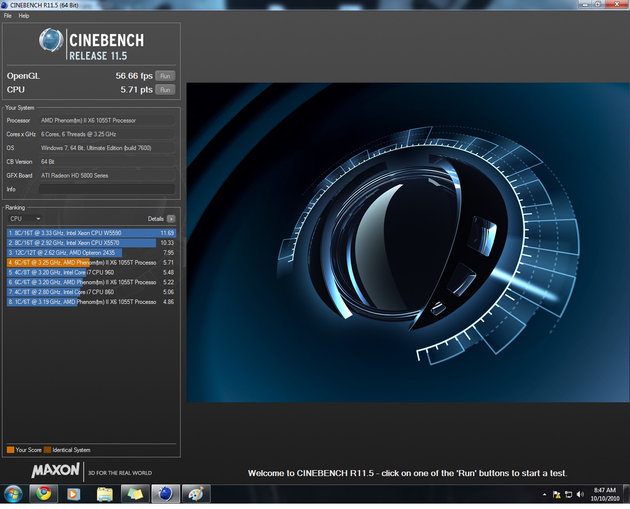

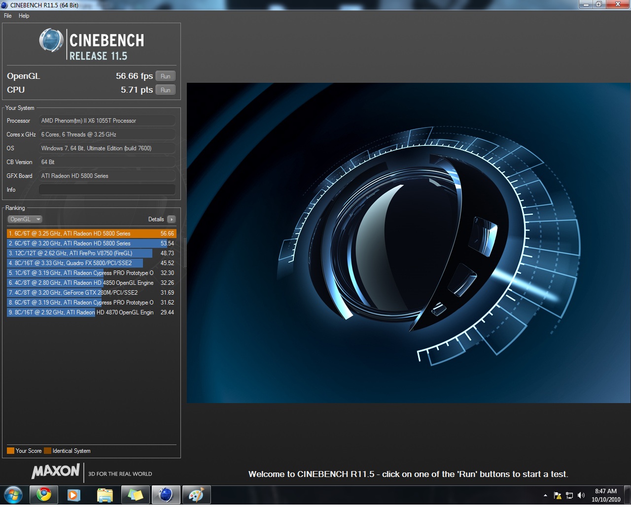

sirbow2 Posted October 10, 2010 Author Share Posted October 10, 2010 the screenie was taken form windows with benches from both windows 7 and OSX. the cpu is clocked to 3.2GHz Windows 7 64 BIT=5.71 rating OSX 64BIT= 5.22 rating OSX 32BIT= 4.86 rating gpu benches from cinbench: HiS Ati Radeon HD 5850 Windows 7 64bit=56.66 rating OSX 64Bit=53.54 as you can see according to windows (which gives more accurate benches as osx isnt meant for PC's) that my Phenom II X6 @ 3.2Ghz is a little better than the i7 960 !!!! ... i wonder what the benches would be if i OCed to 4Ghz..... Link to comment https://www.insanelymac.com/forum/topic/225717-tutorial-amd-1068-retail-snow-leopard-guide/page/5/#findComment-1562169 Share on other sites More sharing options...
davoid Posted October 11, 2010 Share Posted October 11, 2010 the screenie was taken form windows with benches from both windows 7 and OSX. the cpu is clocked to 3.2GHz Windows 7 64 BIT=5.71 rating OSX 64BIT= 5.22 rating OSX 32BIT= 4.86 rating gpu benches from cinbench: HiS Ati Radeon HD 5850 Windows 7 64bit=56.66 rating OSX 64Bit=53.54 as you can see according to windows (which gives more accurate benches as osx isnt meant for PC's) that my Phenom II X6 @ 3.2Ghz is a little better than the i7 960 !!!! :censored2: ... i wonder what the benches would be if i OCed to 4Ghz..... Hey, this is great. All the more reason to get one I reckon. BUT, one quick question based on the MOBO, and one I should have considered. Do the Sata III ports work on your OSX build? I was just about to press 'order' and realised there are only 2 dedicated Sata II ports, and as Mac doesn't support Sata III yet, I wonder if they are backwards compatible on the OSX86 version. Cheers, D Link to comment https://www.insanelymac.com/forum/topic/225717-tutorial-amd-1068-retail-snow-leopard-guide/page/5/#findComment-1562515 Share on other sites More sharing options...
