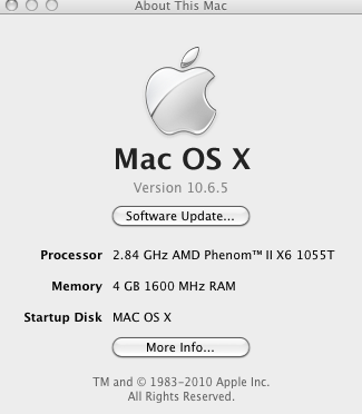

diawollo Posted December 22, 2010 Share Posted December 22, 2010 My system: CPU AMD 1055T MOB Gigabyte 890GPA-UD3H Video Radeon HD5770 RAM 4GB 1600Mhz I am successfully dual booting win7 and SL 10.6.5. First installed windows, then used 10.6.3 retail DVD, created new partition in my usb drive, then copied install dvd to that partition, applied OSInstall.mpkg patch to allow install to MBR. Then I used empire EFI boot CD to load retail installation from usb stick and installed SL. After installation booted from boot cd again into SL, installed 10.6.5 combo update(make sure you dont restart after installation), then applied myHack 1.1.4 with no kexts selected, then copied all the needed kexts to my extra folder (can be found in the attachment). Also replaced boot and mach_kernel files. Installed netkas 5770 drivers (vervet) and network (RealtekR100), for sound there is voodoohda alc892 adaptation, however for me the sound has distortion therefore I am looking for other solutions. Also I couldnt find working sleepenabler.kext and with current mach_kernel I am not able to boot into 64bit. Apart from that I have fast and stable system. There is also macdrive or paragon hfs 8 available for windows, it is very useful if you have problems with booting and want to replace or edit some files. Archive.zip Link to comment https://www.insanelymac.com/forum/topic/225717-tutorial-amd-1068-retail-snow-leopard-guide/page/8/#findComment-1606918 Share on other sites More sharing options...
diawollo Posted December 22, 2010 Share Posted December 22, 2010 disabling C1E in bios seems to resolve sound issue My system:CPU AMD 1055T MOB Gigabyte 890GPA-UD3H Video Radeon HD5770 RAM 4GB 1600Mhz I am successfully dual booting win7 and SL 10.6.5. First installed windows, then used 10.6.3 retail DVD, created new partition in my usb drive, then copied install dvd to that partition, applied OSInstall.mpkg patch to allow install to MBR. Then I used empire EFI boot CD to load retail installation from usb stick and installed SL. After installation booted from boot cd again into SL, installed 10.6.5 combo update(make sure you dont restart after installation), then applied myHack 1.1.4 with no kexts selected, then copied all the needed kexts to my extra folder (can be found in the attachment). Also replaced boot and mach_kernel files. Installed netkas 5770 drivers (vervet) and network (RealtekR100), for sound there is voodoohda alc892 adaptation, however for me the sound has distortion therefore I am looking for other solutions. Also I couldnt find working sleepenabler.kext and with current mach_kernel I am not able to boot into 64bit. Apart from that I have fast and stable system. There is also macdrive or paragon hfs 8 available for windows, it is very useful if you have problems with booting and want to replace or edit some files. Link to comment https://www.insanelymac.com/forum/topic/225717-tutorial-amd-1068-retail-snow-leopard-guide/page/8/#findComment-1607278 Share on other sites More sharing options...

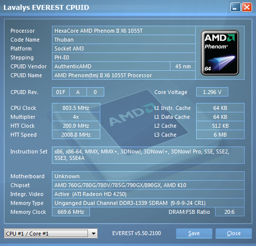

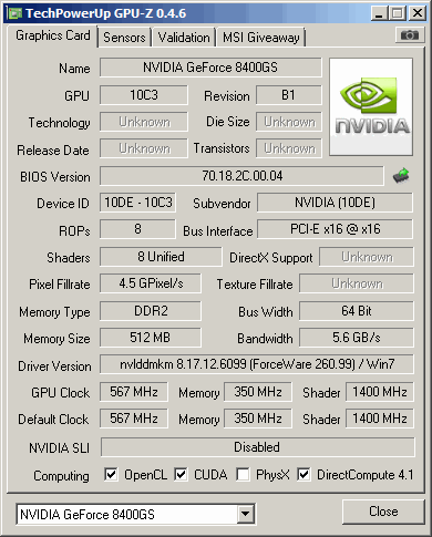

sirbow2 Posted December 31, 2010 Author Share Posted December 31, 2010 Could you please tell me your BIOS setting and what video/graphics card are you using? My struggle is, in AHCI mode I only get one SATA port out of 5, now either I can connect a SATA HD on it or a SATA DVD. I feel cursed. Above all stupid on-board ATI Radeon HD4250. Went and bought another stupid card "GALAXY" 8400GS 512RAM, as every other manufacturer is working. Here: http://www.insanelymac.com/forum/index.php...39203&st=40 Mobo: Gigabyte GA-880GM-UD2H (rev. 1.3) Cpu: AMD Phenom II x6 1055T I dunno, all I can say is make sure you set the 2 (maybe 3) option in bios to ahci And use the 3 blue sata ports closes to the mobo. The built in gfx should work fine, just no gl or qe/ci. Do you have a actuall gfx card? Link to comment https://www.insanelymac.com/forum/topic/225717-tutorial-amd-1068-retail-snow-leopard-guide/page/8/#findComment-1611881 Share on other sites More sharing options...
kalmdave Posted December 31, 2010 Share Posted December 31, 2010 I dunno, all I can say is make sure you set the 2 (maybe 3) option in bios to ahci And use the 3 blue sata ports closes to the mobo. The built in gfx should work fine, just no gl or qe/ci. Do you have a actuall gfx card? Yes, it's GALAXY GeForce 8400GS 512RAM. Ati Radeon HD 4250 is onboard. Man you are lucky. Link to comment https://www.insanelymac.com/forum/topic/225717-tutorial-amd-1068-retail-snow-leopard-guide/page/8/#findComment-1611947 Share on other sites More sharing options...
