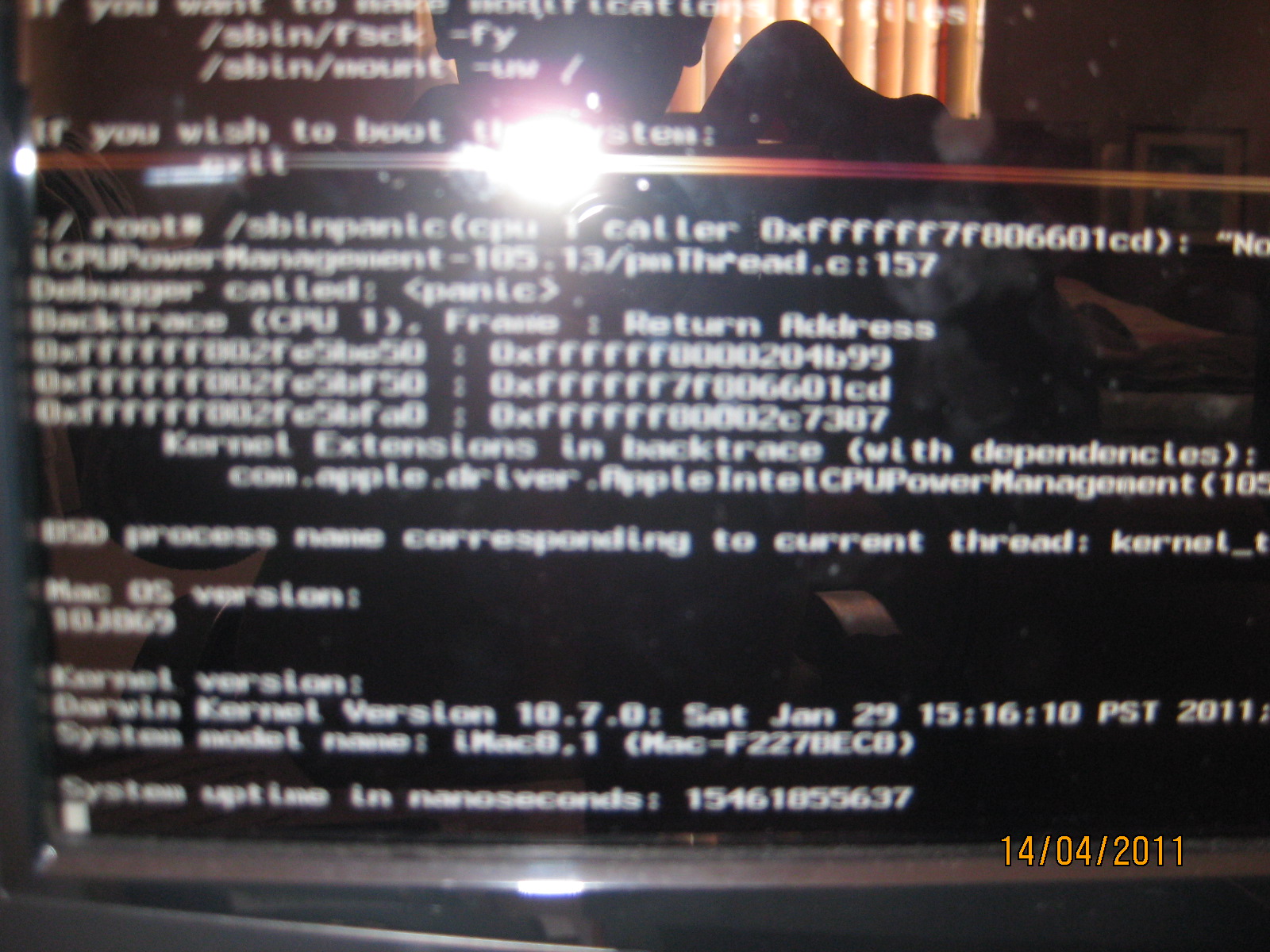

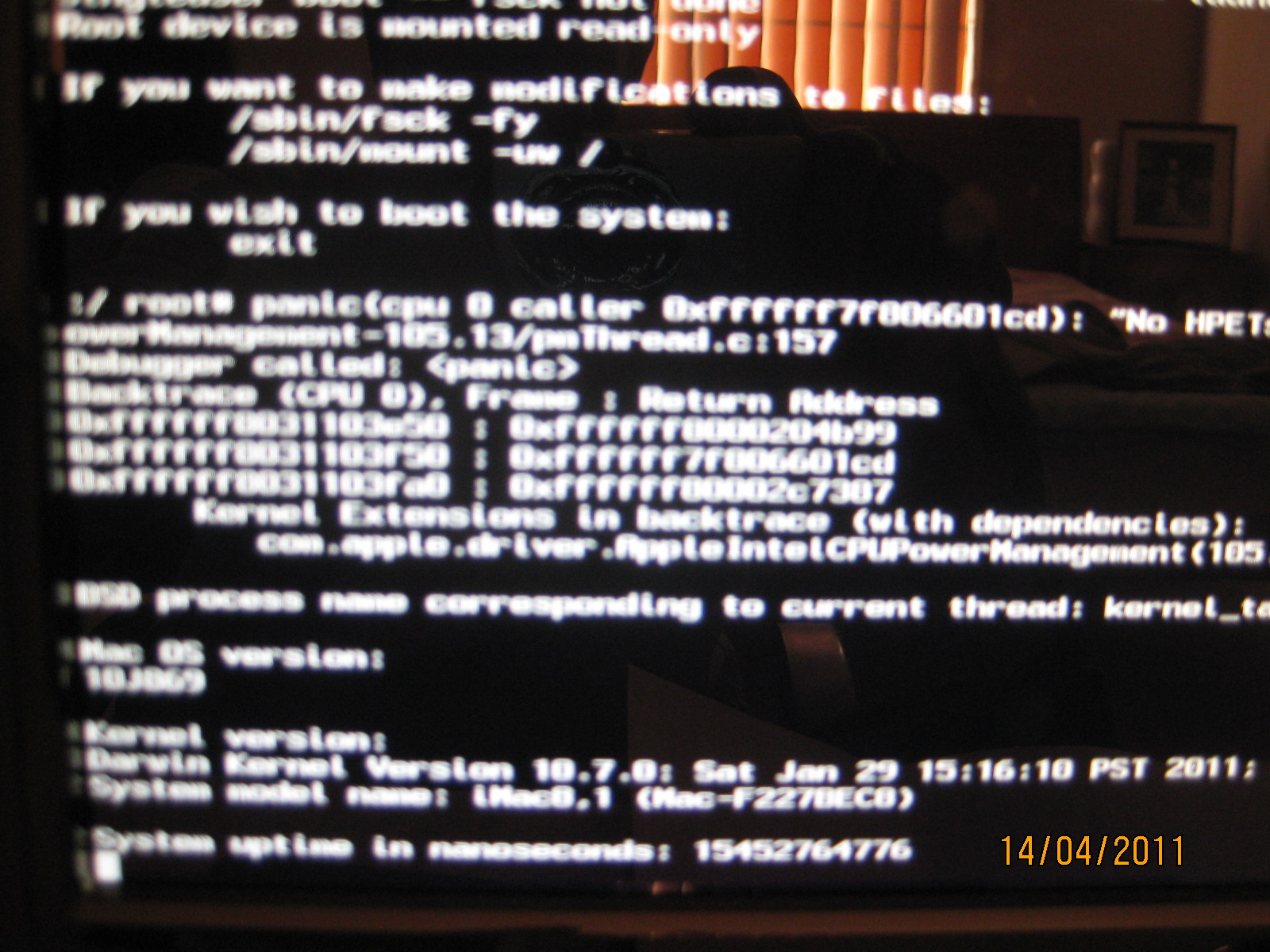

mathewfer Posted April 14, 2011 Share Posted April 14, 2011 Hi oldnapalm, I tried the steps unfortunately I could not get the wake up from sleep to work. I got reboot, shutdown, RTC patched in DSDT & also LPC patch is still there in DSDT. After all those changes, the current status is this; - I got kernel panic with AppleIntelCPUPowerManagement. See the attachements for screen photo. This photo is taken after booting with -s & I could not do any work because of the kernel panic - system stuck. I had to boot with the iATKOS S3 DVD to fix the boot. - After the DSDT patch & bootloader upgrade, I could get away with the "EvOreboot.kex" & "LegacyAppleRTC.kext". - I setup the below in file com.apple.Boot.plist in /Extra folder. But now, I deleted that file. - AppleLPS is now loaded I also see that AppleIntelCPUPowerManagement is loaded now, not sure it is filly loaded. I have below files now in /Extra; 192-168-1-101:~ mathew$ cd /Extra/ 192-168-1-101:Extra mathew$ ls -la total 632 drwxr-xr-x@ 6 root wheel 204 14 Apr 16:32 . drwxrwxr-x 31 root admin 1122 13 Apr 22:38 .. drwxr-xr-x 6 root wheel 204 15 Apr 2011 Extensions -rw-r--r-- 1 root wheel 296196 11 Apr 23:01 Extensions.mkext -rw-r--r-- 1 root wheel 21611 14 Apr 15:22 dsdt.aml drwxr-xr-x 3 root wheel 102 13 Apr 17:33 themes 192-168-1-101:Extra mathew$ ls -la Extensions total 0 drwxr-xr-x 6 root wheel 204 15 Apr 2011 . drwxr-xr-x@ 6 root wheel 204 14 Apr 16:32 .. drwxr-xr-x 4 root wheel 136 11 Apr 23:01 AppleACPIPS2Nub.kext drwxr-xr-x 3 root wheel 102 14 Feb 2010 Disabler.kext drwxr-xr-x 3 root wheel 102 9 Mar 2010 VoodooPS2Controller.kext drwxr-xr-x 3 root wheel 102 15 Feb 2010 fakesmc.kext 192-168-1-101:Extra mathew$ pwd /Extra 192-168-1-101:Extra mathew$ Do you have any idea about the com.apple.Boot.plist file & the kernel panic error? If we have some way to work around it, please do let me know so that I will try next. Thank you for helping me so far & I am sure we will have a fix for this wake up soon - only one left to fix. <?xml version="1.0" encoding="UTF-8"?> <!DOCTYPE plist PUBLIC "-//Apple Computer//DTD PLIST 1.0//EN" "http://www.apple.com/DTDs/PropertyList-1.0.dtd"> <plist version="1.0"> <dict> <key>Kernel</key> <string>mach_kernel</string> <key>Kernel Flags</key> <key>GenerateCStates</key> <string>Yes</string> <key>GeneratePStates</key> <string>Yes</string> </dict> </plist> 192-168-1-101:~ mathew$ sudo kextstat -k | grep AppleLP* 61 0 0x348d1000 0x3000 0x2000 com.apple.driver.AppleLPC (1.4.12) <14 5 4 3> 192-168-1-101:~ mathew$ sudo kextstat -k | grep AppleIntelC* 17 0 0x2e97c000 0x1e000 0x1d000 com.apple.driver.AppleIntelCPUPowerManagement (105.13.0) <7 6 5 4 3 1> 31 0 0x2ebf4000 0x9000 0x8000 com.apple.driver.AppleIntelPIIXATA (2.5.1) <30 14 5 4 3> 73 0 0x34d29000 0x7000 0x6000 com.apple.driver.AppleIntelMeromProfile (19) <72 6 5 4 3> 76 0 0x34def000 0x11000 0x10000 com.apple.driver.AppleIntelIntegratedFramebuffer (6.2.6) <70 14 13 7 5 4 3 1> 85 0 0x35175000 0x36000 0x35000 com.apple.driver.AppleIntelGMA950 (6.2.6) <74 70 14 7 5 4 3 1> 192-168-1-101:~ mathew$ sudo kextstat -k | grep Apple* 15 1 0x2e9b7000 0x42000 0x41000 com.apple.driver.AppleACPIPlatform (1.3.5) <14 13 7 6 5 4 3> 17 0 0x2e97c000 0x1e000 0x1d000 com.apple.driver.AppleIntelCPUPowerManagement (105.13.0) <7 6 5 4 3 1> 21 2 0x2e9b2000 0x3000 0x2000 com.apple.kext.AppleMatch (1.0.0d1) <4 1> 25 0 0x2ea40000 0x3000 0x2000 com.apple.driver.AppleAPIC (1.4) <4 3> 26 0 0x2eabb000 0x4000 0x3000 com.apple.driver.AppleSMBIOS (1.6) <7 4 3> 28 0 0x2ebde000 0x16000 0x15000 com.apple.driver.AppleUSBEHCI (4.1.8) <27 14 7 5 4 3 1> 29 0 0x2eaa8000 0x6000 0x5000 com.apple.driver.AppleRTC (1.3.1) <13 5 4 3 1> 31 0 0x2ebf4000 0x9000 0x8000 com.apple.driver.AppleIntelPIIXATA (2.5.1) <30 14 5 4 3> 33 0 0x2eaae000 0x4000 0x3000 com.apple.driver.AppleACPIButtons (1.3.5) <32 15 13 7 6 5 4 3 1> 34 1 0x2e964000 0x3000 0x2000 com.apple.driver.AppleEFIRuntime (1.4.0) <7 6 5 4 3> 36 0 0x2ebd2000 0x6000 0x5000 com.apple.driver.AppleEFINVRAM (1.4.0) <34 7 5 4 3> 38 0 0x34766000 0x27000 0x26000 com.apple.driver.AppleFWOHCI (4.7.1) <37 14 7 6 5 4 3 1> 40 0 0x34886000 0x12000 0x11000 com.apple.driver.AppleUSBHub (4.1.7) <27 5 4 3 1> 41 0 0x2ebc9000 0x3000 0x2000 com.yourcompany.driver.AppleACPIPS2Nub (1.0.0d1) <13 7 5 4 3 1> 43 0 0x34675000 0x10000 0xf000 com.apple.driver.AppleUSBUHCI (4.1.5) <27 14 7 5 4 3 1> 45 0 0x3478d000 0x6000 0x5000 com.apple.AppleFSCompression.AppleFSCompressionTypeZlib (1.0.0d1) <6 4 3 2 1> 58 0 0x34915000 0x4000 0x3000 com.apple.driver.AppleUSBComposite (3.9.0) <27 4 3 1> 61 0 0x348d1000 0x3000 0x2000 com.apple.driver.AppleLPC (1.4.12) <14 5 4 3> 63 2 0x34cf1000 0xa000 0x9000 com.apple.driver.AppleSMC (3.1.0d3) <13 7 5 4 3> 67 1 0x34d30000 0x9000 0x8000 com.apple.driver.Apple16X50Serial (3.0) <65 14 5 4 3> 68 0 0x34905000 0x2000 0x1000 com.apple.driver.Apple16X50ACPI (3.0) <67 13 4 3> 72 7 0x34f37000 0x2c000 0x2b000 com.apple.iokit.AppleProfileFamily (41) <14 7 6 5 4 3 1> 73 0 0x34d29000 0x7000 0x6000 com.apple.driver.AppleIntelMeromProfile (19) <72 6 5 4 3> 76 0 0x34def000 0x11000 0x10000 com.apple.driver.AppleIntelIntegratedFramebuffer (6.2.6) <70 14 13 7 5 4 3 1> 83 0 0x3505a000 0x7000 0x6000 com.apple.driver.AppleMCCSControl (1.0.17) <70 14 7 5 4 3 1> 85 0 0x35175000 0x36000 0x35000 com.apple.driver.AppleIntelGMA950 (6.2.6) <74 70 14 7 5 4 3 1> 93 0 0x2e52d000 0x3000 0x2000 com.apple.driver.AppleProfileCallstackAction (20) <72 5 4 3 1> 95 0 0x2e575000 0x3000 0x2000 com.apple.driver.AppleProfileKEventAction (10) <72 4 3 1> 97 0 0x2e59f000 0x3000 0x2000 com.apple.driver.AppleProfileRegisterStateAction (10) <72 4 3 1> 98 0 0x2e5d0000 0x3000 0x2000 com.apple.driver.AppleProfileThreadInfoAction (14) <72 6 4 3 1> 99 0 0x2e5d9000 0x3000 0x2000 com.apple.driver.AppleProfileTimestampAction (10) <72 5 4 3 1> 100 0 0x2e5ac000 0x3000 0x2000 com.apple.driver.AppleProfileReadCounterAction (17) <72 6 4 3> 192-168-1-101:~ mathew$ Mathew Link to comment https://www.insanelymac.com/forum/topic/223205-dsdt-editor-and-patcher/page/27/#findComment-1669984 Share on other sites More sharing options...
oldnapalm Posted April 14, 2011 Author Share Posted April 14, 2011 -rw-r--r-- 1 root wheel 296196 11 Apr 23:01 Extensions.mkext You have to update this mkext after removing kexts. drwxr-xr-x 3 root wheel 102 14 Feb 2010 Disabler.kext Did you ckeck what this kext disables? Do you have any idea about the com.apple.Boot.plist file & the kernel panic error? You need that plist in /Extra. About KP, do you have HPET enabled in BIOS? If you do but still have "no HPETs available" KP, try applying the HPET patch to your DSDT. This patch is for Gigabyte mobos (ASUS usually don't need it) so you will probably have to change "Return (ATT3)" to match your DSDT (maybe "Return (CRS)"). Link to comment https://www.insanelymac.com/forum/topic/223205-dsdt-editor-and-patcher/page/27/#findComment-1670120 Share on other sites More sharing options...
