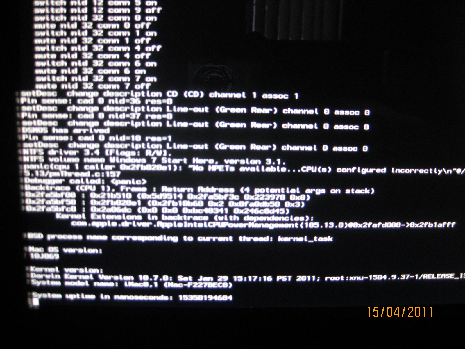

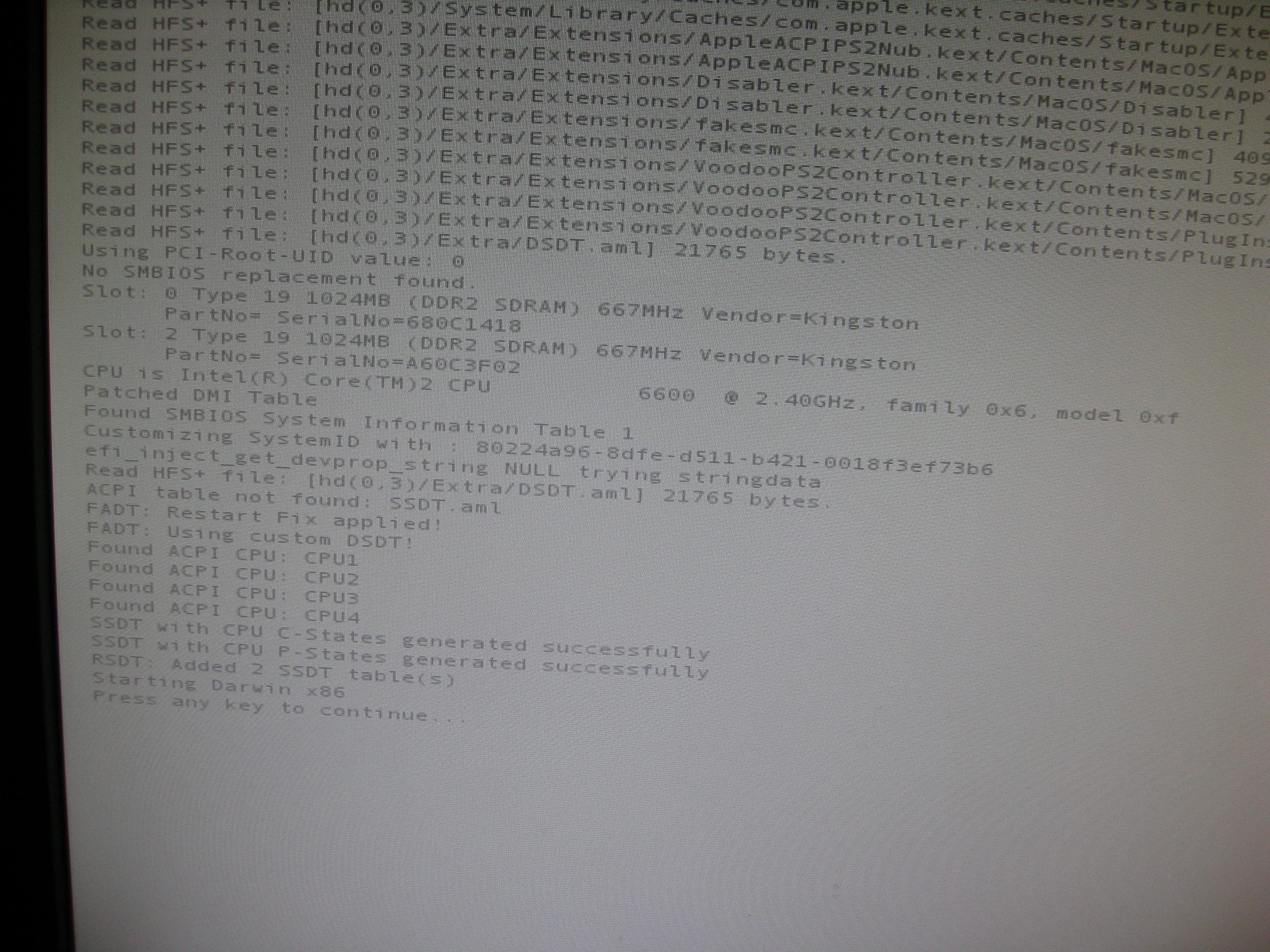

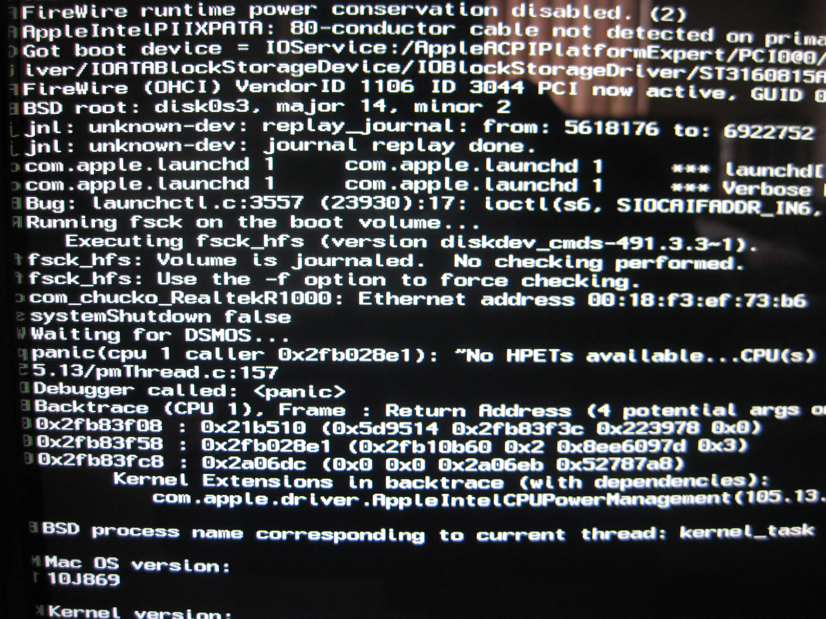

mathewfer Posted April 15, 2011 Share Posted April 15, 2011 Hi oldnapalm/MaLd0n, Thanks for the replies. Today I tried the below but wake up from sleep is NOT fixed yet; I still get the KP with "no HPETs available". - Added the below in com.apple.Boot.plist in /Library/Preferences/SystemConfiguration folder. The addition is done by the GUI - Chemeleon in SystemPreferences. There is no com.apple.Boot.plist file in /Extra directory. This file is being read properly. See below the screen captures. com.apple.Boot.plist <?xml version="1.0" encoding="UTF-8"?> <!DOCTYPE plist PUBLIC "-//Apple//DTD PLIST 1.0//EN" "http://www.apple.com/DTDs/PropertyList-1.0.dtd">'>http://www.apple.com/DTDs/PropertyList-1.0.dtd"> <plist version="1.0"> <dict> <key>Boot Graphics</key> <string>Yes</string> <key>Default Partition</key> <string>hd(0,1)</string> <key>ForceHPET</key> <string>Yes</string> <key>GenerateCStates</key> <string>Yes</string> <key>GeneratePStates</key> <string>Yes</string> <key>Kernel</key> <string>mach_kernel</string> <key>Kernel Flags</key> <string></string> <key>Legacy Logo</key> <string>Yes</string> <key>Quiet Boot</key> <string>No</string> <key>Theme</key> <string>Default</string> <key>Timeout</key> <string>8</string> <key>arch</key> <string>i386</string> </dict> </plist> - There is no settings for HPET in my BIOS. I will send an email to ASUS asking whether it is internally enabled or what. - Added the below HPET in DSDT; # Change methods _STA and _CRS into device HPET (to avoid AppleIntelCPUPowerManagement panic) # into method label _STA parent_hid PNP0103 remove_entry; into device name_hid PNP0103 insert begin Method (_STA, 0, NotSerialized)\n {\n Return (0x0F)\n } end; into method label _CRS parent_hid PNP0103 remove_entry; into device name_hid PNP0103 insert begin Method (_CRS, 0, NotSerialized)\n {\n Return (CRS)\n } end - Deleted Disablee.kext in /Extra & ran the below command to rebult Extensions.mkext in /Extra sudo kextcache -v 2 -t -m /Volumes/MAC\ OS/Extra/Extensions.mkext /Volumes/MAC\ OS/Extra/Extensions/ - info.plist for Disabler.kext is as below & it looks like AppleIntelCPUPowerManagement is disabled with that. <?xml version="1.0" encoding="UTF-8"?> <!DOCTYPE plist PUBLIC "-//Apple//DTD PLIST 1.0//EN" "http://www.apple.com/DTDs/PropertyList-1.0.dtd"> <plist version="1.0"> <dict> <key>CFBundleDevelopmentRegion</key> <string>English</string> <key>CFBundleExecutable</key> <string>Disabler</string> <key>CFBundleGetInfoString</key> <string>Kernel Extension Disabler 1.0.1, Copyright © 2008 by Kabyl</string> <key>CFBundleIdentifier</key> <string>net.osrom.kext.Disabler</string> <key>CFBundleInfoDictionaryVersion</key> <string>6.0</string> <key>CFBundleName</key> <string>Kernel Extension Disabler</string> <key>CFBundlePackageType</key> <string>KEXT</string> <key>CFBundleVersion</key> <string>1.0.1</string> <key>IOKitPersonalities</key> <dict> <key>IntelCPUPowerManagement</key> <dict> <key>CFBundleIdentifier</key> <string>net.osrom.kext.Disabler</string> <key>IOClass</key> <string>Disabler</string> <key>IOMatchCategory</key> <string>AppleIntelCPUPowerManagement</string> <key>IOProbeScore</key> <integer>100</integer> <key>IOProviderClass</key> <string>IOResources</string> <key>IOResourceMatch</key> <string>IOKit</string> </dict> <key>AppleUpstreamUserClientDisabler</key> <dict> <key>CFBundleIdentifier</key> <string>net.osrom.kext.Disabler</string> <key>IOClass</key> <string>Disabler</string> <key>IOMatchCategory</key> <string>AppleUpstreamUserClientDriver</string> <key>IOProbeScore</key> <integer>1000</integer> <key>IOProviderClass</key> <string>IOFramebuffer</string> <key>IOResourceMatch</key> <string>IOKit</string> </dict> <key>Just for loading</key> <dict> <key>CFBundleIdentifier</key> <string>net.osrom.kext.Disabler</string> <key>IOClass</key> <string>Disabler</string> <key>IOMatchCategory</key> <string>Disabler</string> <key>IOProviderClass</key> <string>IOResources</string> <key>IOResourceMatch</key> <string>IOKit</string> </dict> </dict> <key>OSBundleLibraries</key> <dict> <key>com.apple.kpi.iokit</key> <string>8.0.0</string> <key>com.apple.kpi.libkern</key> <string>8.0.0</string> </dict> <key>OSBundleRequired</key> <string>Root</string> </dict> </plist> - As a side not/fix, I deleted "VoodooHDA.kext" from /S/L/E folder, applied AD1988B.txt patch in DST & restart with -f but I did not get the audio working. As it is not so important, I installed the VoodooHDA.kext back again via Kext Helper b7 tool. - At the last step, I added IRQs.txt patch to DSDT but still I get KP. Currently, I used the latest patched dsdt & the above com.apple.Boot.plist file but I had to keep the Disabler.kext in /Extra to get the MAC OS UP & no wake up still. Please see the attachments here. The white one taken with the current setting at the boot "Wait=yes". I still believe we have few more options to try to get the wake up & if you still have any more ideas, please do let me know. Once again thank you so much for your continued support do far on this. 3rd image shows S & P state generated successfully etc. @nd image i NOT clear. Mathew Link to comment https://www.insanelymac.com/forum/topic/223205-dsdt-editor-and-patcher/page/28/#findComment-1670561 Share on other sites More sharing options...
oldnapalm Posted April 15, 2011 Author Share Posted April 15, 2011 About audio, I believe you have to apply the HDEF patch before applying the AD1988B one, I forgot that. Did you try removing ForceHPET=yes from boot.plist after patching HPET in DSDT? Edit: do you have the HPET device in DSDT? Link to comment https://www.insanelymac.com/forum/topic/223205-dsdt-editor-and-patcher/page/28/#findComment-1670634 Share on other sites More sharing options...

mathewfer Posted April 17, 2011 Share Posted April 17, 2011 Hi oldnapalm, Thank you again for the reply. Sorry, KP with sound comes when VodooHDA & HDFE+AD1988B patch is applied which is obvious. When VoodooHDA is removed, I do not get the KP & I see the AppleHDA is loaded properly but I do not get the sound. EDIT: Sorry I just realised that I did not use the "AD1988bFix.kext" all these attempts with DSDT audio patching/testing. Am I supposed to just copy it to install with "Kext Helper b7" or replace "AppleHDA.kext with that or what? Also for my knowledge what is the difference that makes with regard to VoodooHDA kext that works for sound? If you are recommending "AD1988bFix.kext" over VoodooHDA, I will try that with the Audo DSDT patch & I believ it should work. Regarding the sleep, I will NOT get the KP when ForceHPET=yes in a.c.B.plist is present & when I select Apple_Logo->Sleep, it reboots the PC. Before, when I do Apple_logo->Sleep, it goes to sleep but never wake-up. When ForceHPET=yes removed in a.c.b.plist is removed, I get the KP. Is there a way to fix in DSDT with ForceHPET=yes in a.c.B.plist to get the sleep/wake up to work? I am thinking when ForceHPET=yes in a.c.B.plist is present, there is no KP & I see AppleIntelCPU kext getting loaded properly with out any "no HPET Device" error. I think it could be due to may be not having HPET support in BIOS in my ASUS BOX. Also I applied your new HPET patch today. Patch order & it is attached here now. DTGP->GMA950Desktop->Shutdown_ASUS->RTC->HDFE->AD1988B->LCP->HPET>IRQ. If you see anything wrong in this ALM, please let me know. By the way, do you think SleepEnabler-10.6.7.kext helps me in case no HPET support in my BIOS? In the mean time, I will let you when I get a reply from ASUS. Thanks for your support so far. Mathew dsdt_17_Apr.aml.zip Link to comment https://www.insanelymac.com/forum/topic/223205-dsdt-editor-and-patcher/page/28/#findComment-1671228 Share on other sites More sharing options...
oldnapalm Posted April 17, 2011 Author Share Posted April 17, 2011 Does KP persist even after applying "New HPET" patch? Patch order doesn't matter, only HDEF must be applied before AD1988B. You should leave original AppleHDA.kext in /S/L/E and put AD1988bFix.kext in /E/E. Link to comment https://www.insanelymac.com/forum/topic/223205-dsdt-editor-and-patcher/page/28/#findComment-1671443 Share on other sites More sharing options...

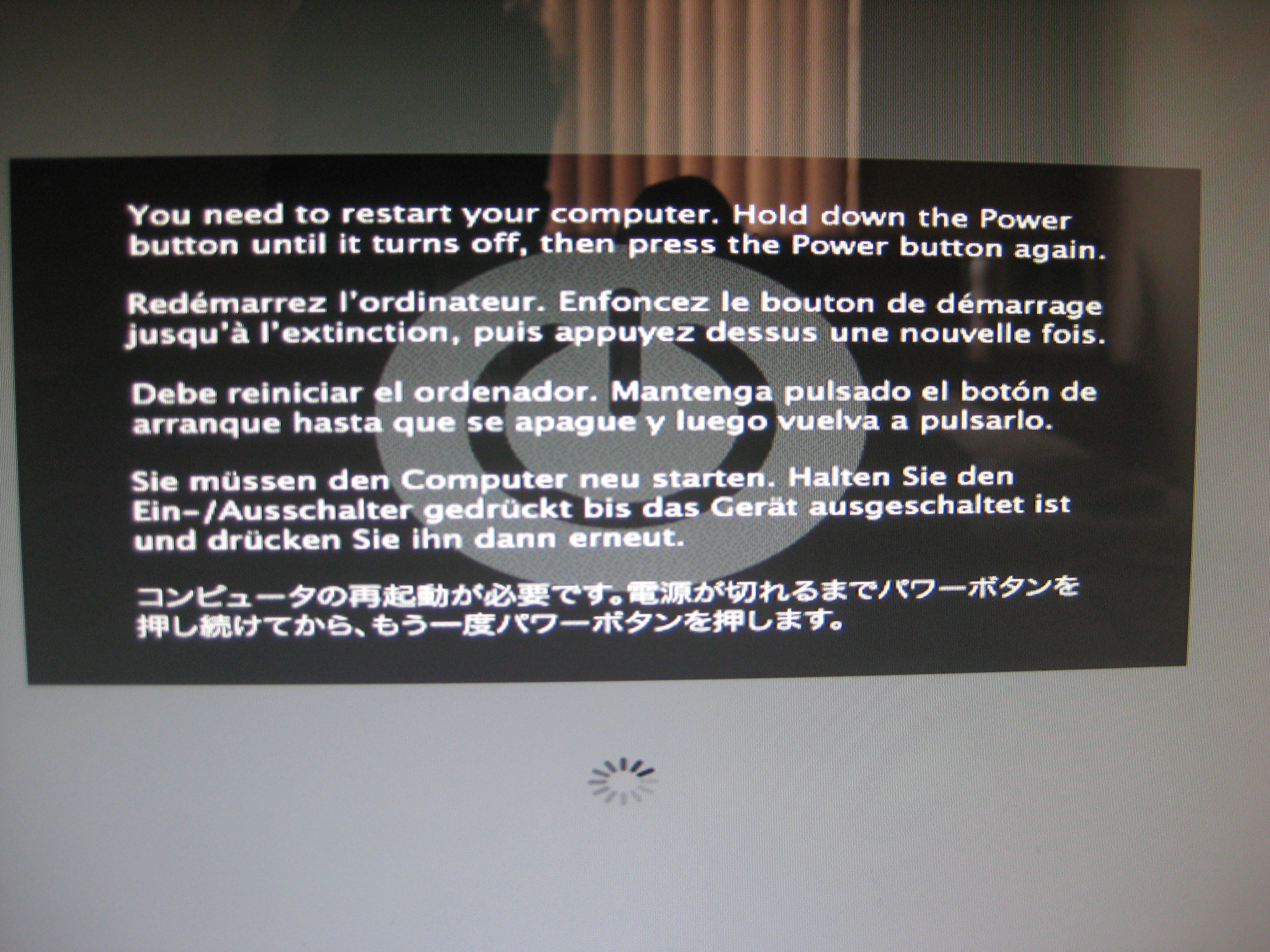

mathewfer Posted April 18, 2011 Share Posted April 18, 2011 Hi oldnapalm, After applying new HPET patch, I do not get KP when if I set the ForceHPET=yes in c.a.B.p in /L/P/S. But the problem is when I select Sleep from Apple menu, PC reboots. Now I do not have the "Disabler.kext" in /Extra folder. Is there a way to fix this further with your new HPET patch? For the Audio, I copied the AD1988bfix.kext & applied the patch as you said but I do not get Audio. In System Preferences-->Audio, It does not show any Audio Devices to select. I have attached the info on AppleHDA. What am I doing wrong here for audio? Please let me know what should be my next step for sleep/wake up & audio? Thanks again. The new dsdt.aml created today, I applied in the below order; DTGP-->GMA950Desktop-->Shutdown_ASUS-->RTC-->HDFE-->AD1988B-->LCP_new-->HPET_new-->IRQ 192-168-1-101:Extensions mathew$ ls -l total 0 drwxr-xr-x@ 3 root wheel 102 18 Apr 15:06 AD1988bFix.kext drwxr-xr-x 4 root wheel 136 11 Apr 23:01 AppleACPIPS2Nub.kext drwxr-xr-x 3 root wheel 102 9 Mar 2010 VoodooPS2Controller.kext drwxr-xr-x 3 root wheel 102 15 Feb 2010 fakesmc.kext 192-168-1-101:Extensions mathew$ <?xml version="1.0" encoding="UTF-8"?> <!DOCTYPE plist PUBLIC "-//Apple//DTD PLIST 1.0//EN" "http://www.apple.com/DTDs/PropertyList-1.0.dtd"> <plist version="1.0"> <dict> <key>Boot Graphics</key> <string>Yes</string> <key>Default Partition</key> <string>hd(0,1)</string> <key>ForceHPET</key> <string>Yes</string> <key>GenerateCStates</key> <string>Yes</string> <key>GeneratePStates</key> <string>Yes</string> <key>Kernel</key> <string>mach_kernel</string> <key>Kernel Flags</key> <string></string> <key>Legacy Logo</key> <string>Yes</string> <key>Quiet Boot</key> <string>No</string> <key>Theme</key> <string>Default</string> <key>Timeout</key> <string>8</string> <key>arch</key> <string>i386</string> </dict> </plist> 192-168-1-101:~ mathew$ sudo kextstat -k Password: Index Refs Address Size Wired Name (Version) <Linked Against> 13 12 0x2fa0d000 0x4000 0x3000 com.apple.iokit.IOACPIFamily (1.3.0) <7 6 4 3> 14 18 0x2fa29000 0x11000 0x10000 com.apple.iokit.IOPCIFamily (2.6) <7 5 4 3> 15 1 0x2fa77000 0x42000 0x41000 com.apple.driver.AppleACPIPlatform (1.3.5) <14 13 7 6 5 4 3> 16 0 0x2fb1d000 0x1e000 0x1d000 com.apple.driver.AppleIntelCPUPowerManagement (105.13.0) <7 6 5 4 3 1> 17 10 0x2fb4d000 0x18000 0x17000 com.apple.iokit.IOStorageFamily (1.6.2) <7 6 5 4 3 1> 18 0 0x2fb81000 0x11000 0x10000 com.apple.driver.DiskImages (289) <17 7 6 5 4 3 1> 19 0 0x2fbdc000 0x8000 0x7000 com.apple.nke.applicationfirewall (2.1.11) <7 6 5 4 3 1> 20 2 0x2fa68000 0x3000 0x2000 com.apple.kext.AppleMatch (1.0.0d1) <4 1> 21 0 0x2fbe4000 0x5000 0x4000 com.apple.security.quarantine (0) <20 7 6 5 4 2 1> 22 0 0x2fbe9000 0x8000 0x7000 com.apple.security.sandbox (1) <20 7 6 5 4 2 1> 23 0 0x2fa6b000 0x3000 0x2000 com.apple.security.TMSafetyNet (6) <7 6 5 4 2 1> 24 0 0x2faeb000 0x3000 0x2000 com.apple.driver.AppleIntelCPUPowerManagementClient (105.13.0) <7 6 5 4 3 1> 25 0 0x2fbf1000 0x3000 0x2000 com.apple.driver.AppleAPIC (1.4) <4 3> 26 0 0x35662000 0x4000 0x3000 com.apple.driver.AppleSMBIOS (1.6) <7 4 3> 27 7 0x35796000 0x34000 0x33000 com.apple.iokit.IOUSBFamily (4.1.8) <14 7 5 4 3 1> 28 0 0x2fb3b000 0x10000 0xf000 com.apple.driver.AppleUSBUHCI (4.1.5) <27 14 7 5 4 3 1> 29 0 0x357f4000 0x6000 0x5000 com.apple.driver.AppleRTC (1.3.1) <13 5 4 3 1> 30 0 0x2fbf4000 0x3000 0x2000 com.yourcompany.driver.AppleACPIPS2Nub (1.0.0d1) <13 7 5 4 3 1> 31 0 0x2fbfd000 0x3000 0x2000 com.apple.driver.AppleHPET (1.5) <13 7 5 4 3> 32 3 0x35820000 0x3c000 0x3b000 com.apple.iokit.IOHIDFamily (1.6.5) <7 6 5 4 3 1> 33 0 0x3577d000 0x4000 0x3000 com.apple.driver.AppleACPIButtons (1.3.5) <32 15 13 7 6 5 4 3 1> 34 0 0x35781000 0x4000 0x3000 org.netkas.fakesmc (2) <13 7 4 3> 35 1 0x35785000 0x3000 0x2000 com.apple.driver.AppleEFIRuntime (1.4.0) <7 6 5 4 3> 36 0 0x3578d000 0x6000 0x5000 com.apple.driver.AppleEFINVRAM (1.4.0) <35 7 5 4 3> 37 2 0x35910000 0x17000 0x16000 com.apple.iokit.IONetworkingFamily (1.10) <7 6 5 4 3 1> 38 0 0x35944000 0x11000 0x10000 com.chucko.driver.RealtekR1000 (2.0.0d1) <37 14 5 4 3 1> 40 0 0x3595b000 0x16000 0x15000 com.apple.driver.AppleUSBEHCI (4.1.8) <27 14 7 5 4 3 1> 41 3 0x35971000 0xd000 0xc000 com.apple.iokit.IOATAFamily (2.5.1) <5 4 3 1> 42 0 0x35993000 0x9000 0x8000 com.apple.driver.AppleIntelPIIXATA (2.5.1) <41 14 5 4 3> 43 2 0x3599c000 0x43000 0x42000 com.apple.iokit.IOFireWireFamily (4.2.6) <5 4 3 1> 44 0 0x35a25000 0x27000 0x26000 com.apple.driver.AppleFWOHCI (4.7.1) <43 14 7 6 5 4 3 1> 45 1 0x35a50000 0x6000 0x5000 org.voodoo.driver.PS2Controller (1.1.0) <13 7 5 4 3 1> 46 0 0x3567d000 0x2000 0x1000 com.apple.iokit.IOUSBUserClient (4.1.5) <27 7 5 4 3 1> 47 0 0x35b1c000 0x12000 0x11000 com.apple.driver.AppleUSBHub (4.1.7) <27 5 4 3 1> 49 0 0x35b33000 0x6000 0x5000 com.apple.AppleFSCompression.AppleFSCompressionTypeZlib (1.0.0d1) <6 4 3 2 1> 50 0 0x35b39000 0x5000 0x4000 com.apple.BootCache (31) <7 6 5 4 3 1> 51 5 0x35b4d000 0x1a000 0x19000 com.apple.iokit.IOSCSIArchitectureModelFamily (2.6.5) <5 4 3 1> 52 0 0x35b41000 0x5000 0x4000 com.apple.iokit.IOATAPIProtocolTransport (2.5.1) <51 41 5 4 3 1> 53 0 0x35eb9000 0x4000 0x3000 org.voodoo.driver.PS2Keyboard (1.1.0) <45 32 7 6 5 4 3 1> 54 0 0x35ed9000 0xe000 0xd000 com.apple.iokit.IOATABlockStorage (2.6.0) <41 17 5 4 3 1> 55 0 0x35ebd000 0x3000 0x2000 com.apple.driver.XsanFilter (402.1) <17 5 4 3 1> 56 3 0x35f1d000 0x8000 0x7000 com.apple.iokit.IOCDStorageFamily (1.6) <17 5 4 3 1> 57 2 0x35f35000 0x6000 0x5000 com.apple.iokit.IODVDStorageFamily (1.6) <56 17 5 4 3 1> 58 1 0x35f4a000 0x5000 0x4000 com.apple.iokit.IOBDStorageFamily (1.6) <57 56 17 5 4 3 1> 59 0 0x35f69000 0x18000 0x17000 com.apple.iokit.IOSCSIMultimediaCommandsDevice (2.6.5) <58 57 56 51 17 5 4 3 1> 60 0 0x35f98000 0x7000 0x6000 com.apple.iokit.SCSITaskUserClient (2.6.5) <51 17 5 4 3 1> 61 0 0x35a4c000 0x4000 0x3000 com.apple.driver.AppleUSBComposite (3.9.0) <27 4 3 1> 62 0 0x35ffc000 0xb000 0xa000 com.apple.iokit.IOUSBMassStorageClass (2.6.5) <51 27 17 5 4 3 1> 63 0 0x36017000 0x18000 0x17000 com.apple.iokit.IOSCSIBlockCommandsDevice (2.6.5) <51 17 5 4 3 1> 65 1 0x361c3000 0x7000 0x6000 com.apple.iokit.IOHDAFamily (1.9.9f12) <5 4 3 1> 66 6 0x361f1000 0x22000 0x21000 com.apple.iokit.IOGraphicsFamily (2.2) <14 7 5 4 3> 67 0 0x3629d000 0x18000 0x17000 com.apple.driver.AppleHDAController (1.9.9f12) <66 65 14 5 4 3 1> 68 0 0x3623a000 0x11000 0x10000 com.apple.driver.AppleIntelIntegratedFramebuffer (6.2.6) <66 14 13 7 5 4 3 1> 69 1 0x3624b000 0xd000 0xc000 com.apple.iokit.IONDRVSupport (2.2) <66 14 7 5 4 3> 70 0 0x3617b000 0x3000 0x2000 com.apple.driver.AppleLPC (1.4.12) <14 5 4 3> 71 1 0x3621d000 0xb000 0xa000 com.apple.driver.IOPlatformPluginFamily (4.5.0d5) <6 5 4 3> 72 2 0x36263000 0xa000 0x9000 com.apple.driver.AppleSMC (3.1.0d3) <13 7 5 4 3> 73 0 0x36278000 0x10000 0xf000 com.apple.driver.ACPI_SMC_PlatformPlugin (4.5.0d5) <72 71 14 13 7 6 5 4 3> 74 2 0x36288000 0x9000 0x8000 com.apple.iokit.IOSerialFamily (10.0.3) <7 6 5 4 3 1> 75 1 0x362f0000 0x9000 0x8000 com.apple.driver.Apple16X50Serial (3.0) <74 14 5 4 3> 76 0 0x35f15000 0x2000 0x1000 com.apple.driver.Apple16X50ACPI (3.0) <75 13 4 3> 77 7 0x363f9000 0x2c000 0x2b000 com.apple.iokit.AppleProfileFamily (41) <14 7 6 5 4 3 1> 78 0 0x36233000 0x7000 0x6000 com.apple.driver.AppleIntelMeromProfile (19) <77 6 5 4 3> 79 0 0x3634a000 0x9000 0x8000 com.apple.iokit.IOFireWireIP (2.0.3) <43 37 5 4 3 1> 81 1 0x361ca000 0x4000 0x3000 com.apple.kext.OSvKernDSPLib (1.3) <5 4> 82 1 0x36332000 0x18000 0x17000 com.apple.iokit.IOAudioFamily (1.8.0fc1) <81 5 4 3 1> 84 0 0x3650e000 0x36000 0x35000 com.apple.driver.AppleIntelGMA950 (6.2.6) <69 66 14 7 5 4 3 1> 85 0 0x2fa61000 0x7000 0x6000 com.apple.driver.AppleMCCSControl (1.0.17) <66 14 7 5 4 3 1> 86 0 0x35f5e000 0x4000 0x3000 com.apple.driver.AudioIPCDriver (1.1.6) <82 5 4 3 1> 88 0 0x3581a000 0x6000 0x5000 com.apple.iokit.IOUSBHIDDriver (4.1.5) <32 27 5 4 3 1> 89 0 0x362f9000 0x5000 0x4000 com.apple.driver.AppleUpstreamUserClient (3.5.4) <66 14 13 7 5 4 3 1> 90 0 0x363f3000 0x6000 0x5000 com.apple.Dont_Steal_Mac_OS_X (7.0.0) <72 7 4 3 1> 92 0 0x364dc000 0x9000 0x8000 com.apple.iokit.IOBluetoothSerialManager (2.4.0f1) <74 7 5 4 3 1> 94 0 0x364f6000 0xb000 0xa000 com.apple.iokit.IOSurface (74.2) <7 5 4 3 1> 95 0 0x2f6f3000 0xa000 0x9000 com.apple.filesystems.autofs (2.1.0) <7 6 5 4 3 1> 96 3 0x4688f000 0x60000 0x5f000 com.apple.filesystems.ntfs (3.4) <7 6 5 4 1> 97 0 0x2f6d6000 0x3000 0x2000 com.apple.driver.AppleProfileCallstackAction (20) <77 5 4 3 1> 100 0 0x2f6cb000 0x3000 0x2000 com.apple.driver.AppleProfileKEventAction (10) <77 4 3 1> 102 0 0x2f71f000 0x3000 0x2000 com.apple.driver.AppleProfileRegisterStateAction (10) <77 4 3 1> 103 0 0x2f728000 0x3000 0x2000 com.apple.driver.AppleProfileThreadInfoAction (14) <77 6 4 3 1> 104 0 0x2f72b000 0x3000 0x2000 com.apple.driver.AppleProfileTimestampAction (10) <77 5 4 3 1> 105 0 0x2f701000 0x3000 0x2000 com.apple.driver.AppleProfileReadCounterAction (17) <77 6 4 3> 106 1 0x362c0000 0xd000 0xc000 com.apple.filesystems.msdosfs (1.6.3) <7 5 4 1> 107 0 0x3673f000 0xe000 0xd000 com.apple.nke.asp_tcp (5.0) <7 6 5 4 3 1> 108 0 0x46cb5000 0x57000 0x56000 com.apple.filesystems.afpfs (9.7) <7 6 5 4 3 1> 192-168-1-101:~ mathew$ AppleHDA_info.tiff Link to comment https://www.insanelymac.com/forum/topic/223205-dsdt-editor-and-patcher/page/28/#findComment-1671803 Share on other sites More sharing options...

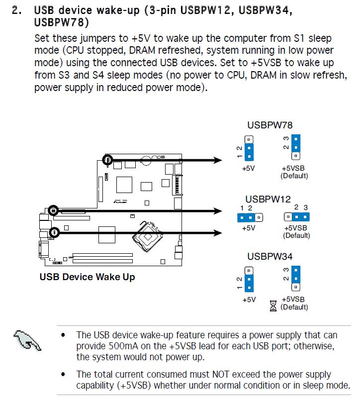

mathewfer Posted April 18, 2011 Share Posted April 18, 2011 Hi oldnapalm, Yes, I need ForceHPET=yes even after applying the patch otherwise, if I remove it, I get the KP. I use a PS/2 keyboard & an USB mouse. I will check & try the USB settings on motherboard. Will update you today. It looks like OSX wakeup is different to Windows 7 because Windows 7 wake up works. For the audio, I will capture it from a Ubuntu live CD & will send them to you soon. In the worest case, it does not matter, I can use VoodooHDA as it did not effect updates. Yes, after iATKOCS S3 install (10.6.3), I ran 10.6.6 & 10.6.7 combo to see how things sustain & sound was ok with VoodooHDA but I like all to be much closer to Apple retail. Thanks again for your support so far. EDIT/Update: ASUS repleid to my email regarding HPET support in BIOS saying -->"This option won't be added to this model due to hardware limitation" So it looks like there is no BIOS or hardware support in my ASUS MB/box for HPET. Do you have any other suggestions to get the sleep/wakeup? Any idea for SleepEnabler10.6.7 as an alternative fix? By the way, see below the attached MB setting & I checked they are with default (+5VSB) & BIOS settings is with S3 Mathew Link to comment https://www.insanelymac.com/forum/topic/223205-dsdt-editor-and-patcher/page/28/#findComment-1672031 Share on other sites More sharing options...
