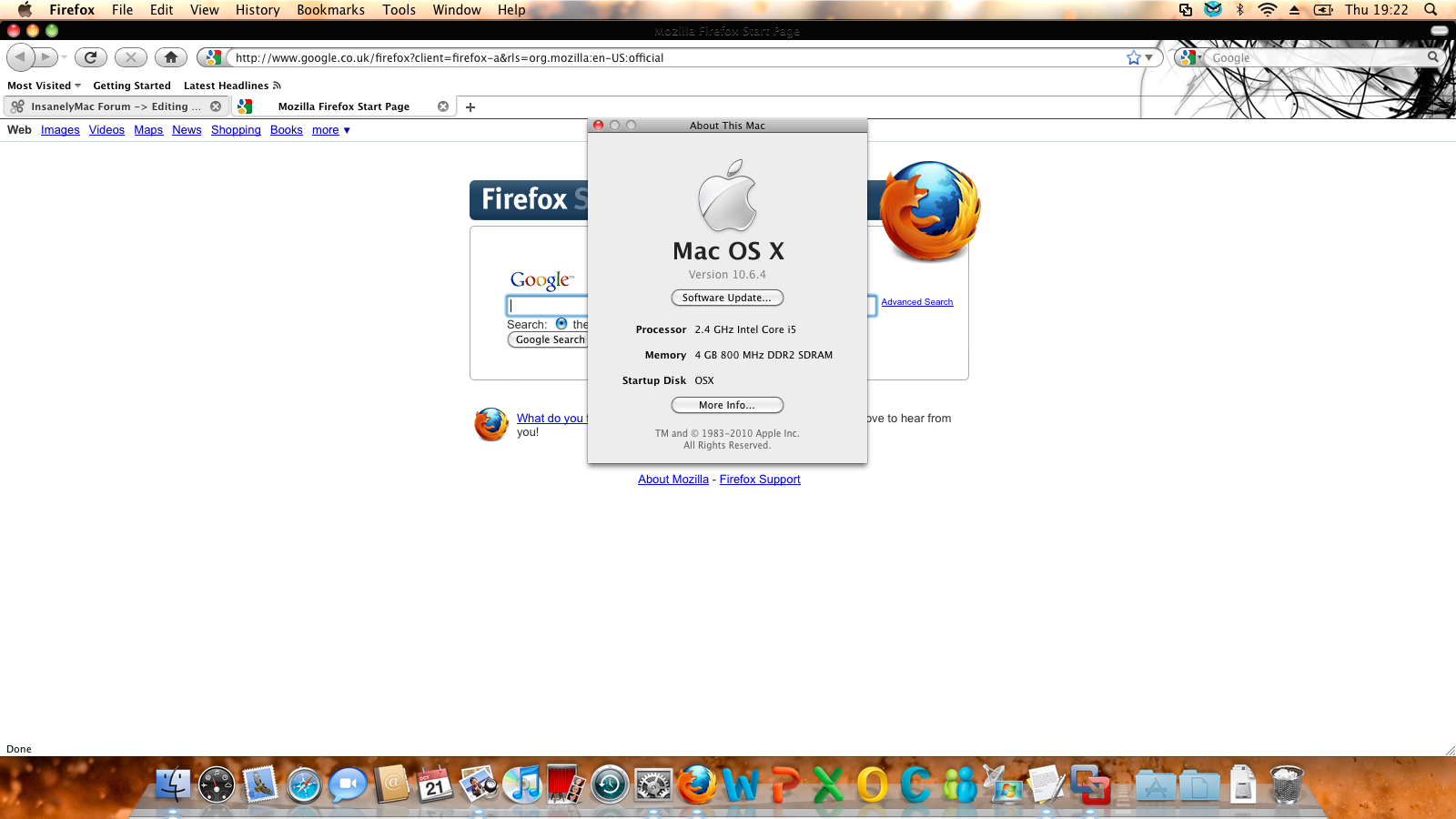

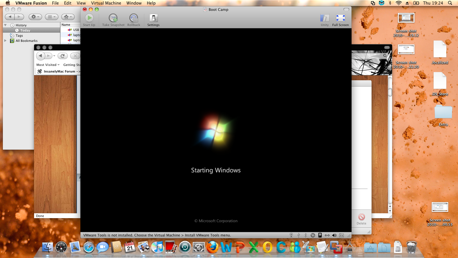

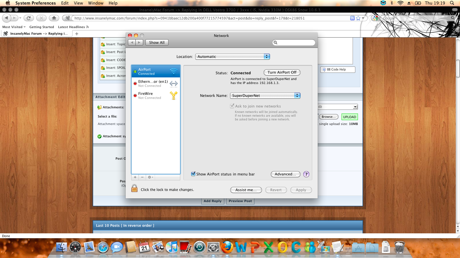

Using 10.6.4, i think ethernet works though? Does yours show up? I do recommend DW1510 card to replace the 1520 very simple and works OTB.
Mine shown below. And VMware works in 10.6.4 + Better graphics driver for GT330m (notice transparency on top menu bar, i dun think it was there in 10.6.3)

I see "en1" with "status: inactive" when I run ifconfig in terminal. However, there is no airport in my network setup. I can get more info when I get home, but I'm bored at work and figured I would see what help I might be able to get.
