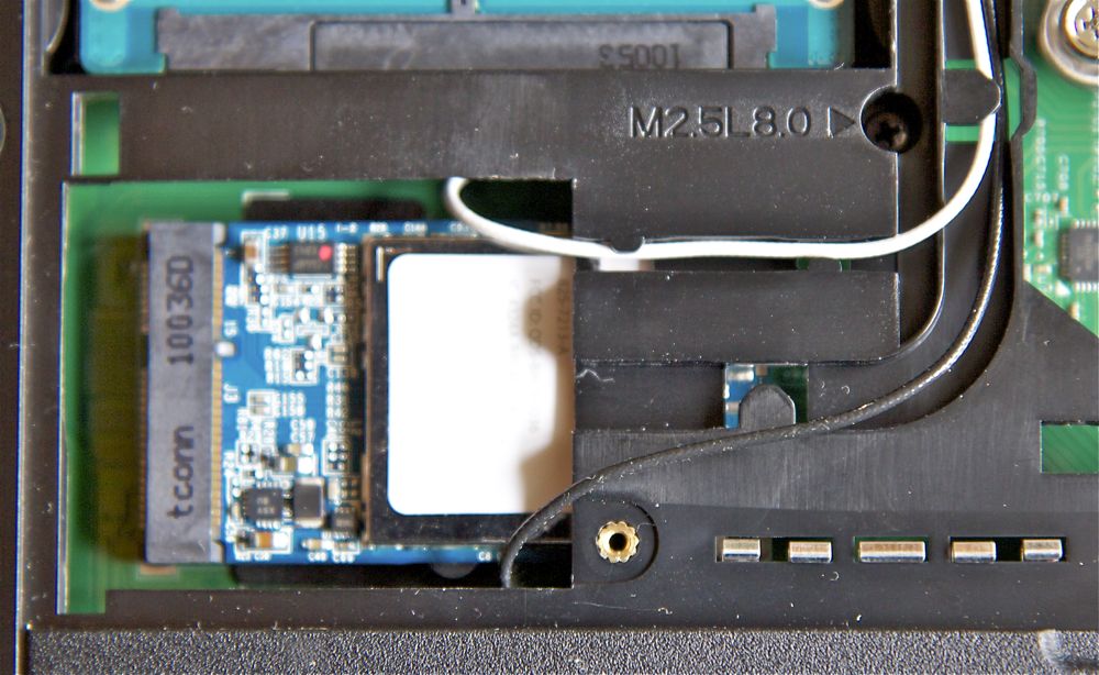

carlos228 Posted July 29, 2010 Author Share Posted July 29, 2010 Today I received my new WLAN / Airport card: http://cgi.ebay.de/ws/eBayISAPI.dll?ViewIt...em=260601300786 Its full size but you can easily shift it into place ( vostro 3700 ). No screw lock possible, but it is not needed because the card fits very tight. See the attached photo. It works 32 and 64 bit, out of the box. :-) Link to comment https://www.insanelymac.com/forum/topic/218051-dell-vostro-3700-3xxx-i5-nvidia-330m-osx86-snow-1063/page/4/#findComment-1521024 Share on other sites More sharing options...

taoyh Posted July 29, 2010 Share Posted July 29, 2010 Today I received my new WLAN / Airport card: http://cgi.ebay.de/ws/eBayISAPI.dll?ViewIt...em=260601300786 Its full size but you can easily shift it into place ( vostro 3700 ). No screw lock possible, but it is not needed because the card fits very tight. See the atatched photo. It works 32 and 64 bit, out of the box. :-) thanks for your photo , and I was worried about the half card. Link to comment https://www.insanelymac.com/forum/topic/218051-dell-vostro-3700-3xxx-i5-nvidia-330m-osx86-snow-1063/page/4/#findComment-1521083 Share on other sites More sharing options...
