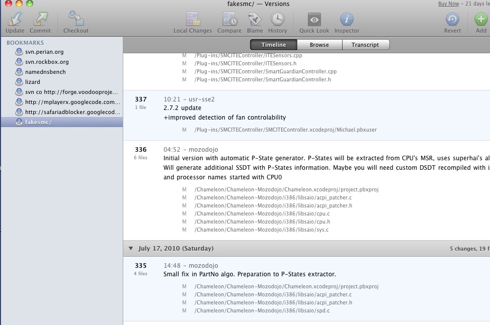

mitch_de Posted July 18, 2010 Share Posted July 18, 2010 to valv: The FAKESMC Team (new FAKEMSC with plugins for cpu temp & serveral IO Chips) started two weeks ago an Chameleon branch (AsereBLN, + Mozodojo Versions). They using now XCODE proj, which is more easy for following + using for dev noobs). Here is the svn link , CHamelon is within the main folder : http://subversion.assembla.com/svn/fakesmc Here an screenshoot with versions. Perhaps in they future nice they would add your valv branch also ? (Dev disskuss forum of that: http://www.projectosx.com/forum/index.php?showtopic=1206 Link to comment https://www.insanelymac.com/forum/topic/216726-anval-acpi-loader/page/27/#findComment-1513469 Share on other sites More sharing options...
cparm Posted July 18, 2010 Share Posted July 18, 2010 to valv:The FAKESMC Team (new FAKEMSC with plugins for cpu temp & serveral IO Chips) started two weeks ago an Chameleon branch (AsereBLN, + Mozodojo Versions). They using now XCODE proj, which is more easy for following + using for dev noobs). Here is the svn link , CHamelon is within the main folder : http://subversion.assembla.com/svn/fakesmc Here an screenshoot with versions. Perhaps in they future nice they would add your valv branch also ? (Dev disskuss forum of that: http://www.projectosx.com/forum/index.php?showtopic=1206 thank for the info i already knew his old ssdt patch, but not his ssdt generator (to be honest i was working on something similar but he strike first ) it seems to be interesting Link to comment https://www.insanelymac.com/forum/topic/216726-anval-acpi-loader/page/27/#findComment-1513621 Share on other sites More sharing options...

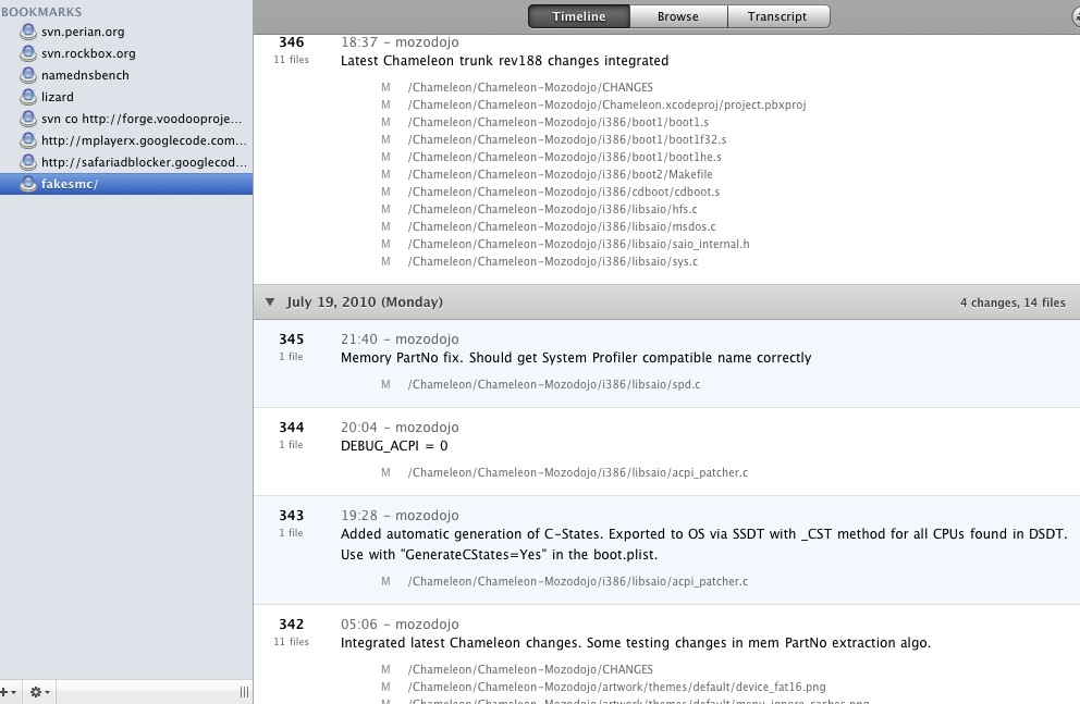

Gidi Posted July 20, 2010 Share Posted July 20, 2010 Valv, the section related to generation of C-States can be found inside: /Chameleon/Chameleon-Mozodojo/i386/libsaio/acpi_patcher.c Cheers! Link to comment https://www.insanelymac.com/forum/topic/216726-anval-acpi-loader/page/27/#findComment-1514779 Share on other sites More sharing options...
cparm Posted July 20, 2010 Share Posted July 20, 2010 i have ported the SSDT generator for the last valv build, fixed some warnings, and it's works great (congrat. to mozodojo), i have also added a primitive C4 support, simply by adding a bootconfig entry like "enableC4", if "enableC4"=yes, chunk_c3[14] is changed from 0x20 to 0x30 and chunk_c3[25] from 0x03 to 0x04 and boom, C4 enabled (checked with 'sudo setpci -s 0:1f.0 0xa6.b') ps: if someone know how to calculate C4 latency, please tell me Link to comment https://www.insanelymac.com/forum/topic/216726-anval-acpi-loader/page/27/#findComment-1514848 Share on other sites More sharing options...

valv Posted July 20, 2010 Author Share Posted July 20, 2010 Valv, the section related to generation of C-States can be found inside: /Chameleon/Chameleon-Mozodojo/i386/libsaio/acpi_patcher.c Cheers! I already knew about this file, but I seem to be more dumb than I thought, as I don't see any pstate generation section (maybe the version I got). no real generation mechanism other than headers comparison and patching there. Link to comment https://www.insanelymac.com/forum/topic/216726-anval-acpi-loader/page/27/#findComment-1514940 Share on other sites More sharing options...
kozlek Posted July 20, 2010 Share Posted July 20, 2010 I already knew about this file, but I seem to be more dumb than I thought, as I don't see any pstate generation section (maybe the version I got). no real generation mechanism other than headers comparison and patching there. Check the generate_pss_ssdt function in acpi_patcher.c Link to comment https://www.insanelymac.com/forum/topic/216726-anval-acpi-loader/page/27/#findComment-1515008 Share on other sites More sharing options...
valv Posted July 20, 2010 Author Share Posted July 20, 2010 Check the generate_pss_ssdt function in acpi_patcher.c Thank u for replying. but nothing there named generate_pss_ssdt. maybe u meant this: struct acpi_2_ssdt * patch_ssdt(struct acpi_2_ssdt *ssdt) { struct acpi_2_ssdt *ssdt_mod; if (Platform.CPU.Vendor != 0x756E6547) { /* Intel */ verbose ("Not an Intel platform: P-States will not generated !!!\n"); return ssdt; } if (ssdt == 0 || strcmp(ssdt->OEMID, "PmRef") != 0 || strcmp(ssdt->OEMTableId, "CpuPm") != 0) { return ssdt; } verbose("Found CPU power profile SSDT to patch./n"); ssdt_mod = ssdt; return ssdt_mod; } Edit: It was a matter of updating to the latest revision. wow! I 'll be looking further at it asap. Link to comment https://www.insanelymac.com/forum/topic/216726-anval-acpi-loader/page/27/#findComment-1515028 Share on other sites More sharing options...

kozlek Posted July 20, 2010 Share Posted July 20, 2010 Thank u for replying. but nothing there named generate_pss_ssdt. maybe u meant this:struct acpi_2_ssdt * patch_ssdt(struct acpi_2_ssdt *ssdt) { struct acpi_2_ssdt *ssdt_mod; if (Platform.CPU.Vendor != 0x756E6547) { /* Intel */ verbose ("Not an Intel platform: P-States will not generated !!!\n"); return ssdt; } if (ssdt == 0 || strcmp(ssdt->OEMID, "PmRef") != 0 || strcmp(ssdt->OEMTableId, "CpuPm") != 0) { return ssdt; } verbose("Found CPU power profile SSDT to patch./n"); ssdt_mod = ssdt; return ssdt_mod; } Edit: It was a matter of updating to the latest revision. wow! I 'll be looking further at it asap. Oh, I think you downloaded different version. Mine is in the Chameleon-Mozodojo folder on the assembla. Link to comment https://www.insanelymac.com/forum/topic/216726-anval-acpi-loader/page/27/#findComment-1515105 Share on other sites More sharing options...

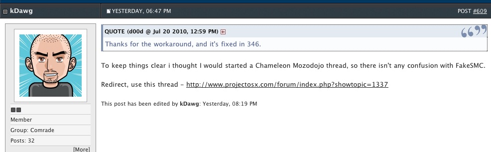

mitch_de Posted July 20, 2010 Share Posted July 20, 2010 They started an Chameleon Thread (insted commenting in the FAKESMC thread) now: http://www.projectosx.com/forum/index.php?showtopic=1340 I attached newest chameleon folder (complete, changes until this evening). http://rapidshare.com/files/408044925/Cham..._20_07_2010.zip (11 MB). Link to comment https://www.insanelymac.com/forum/topic/216726-anval-acpi-loader/page/27/#findComment-1515187 Share on other sites More sharing options...

mitch_de Posted July 21, 2010 Share Posted July 21, 2010 Sorry, they changed link: http://www.projectosx.com/forum/index.php?showtopic=1337 EDIT: Now there is also an Chameleon RC5+P_states/fermi discuss thread here in News+Updates Link to comment https://www.insanelymac.com/forum/topic/216726-anval-acpi-loader/page/27/#findComment-1515486 Share on other sites More sharing options...
