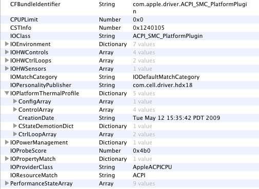

I had to move Scope (_PR) to the beginning of DSDT file. I got the tip from this post. Apparently, this is a bug and has been fixed by mozodojo. @Valv, may be you didn't include this fix to your branch.
I also included the following keys to the boot.plist. And now it's generated P-States and C-States.
<key>GeneratePStates</key>
<string>Yes</string>
<key>GenerateCStates</key>
<key>DropSSDT</key>
Previously, I had 4 PerformanceStateArray and now I have 9.
But I don't see any difference in terms of temperature. It is almost the same values while using P-States only.
I wonder if I should remove ACPI_SMC_PlatformPlugin and set my Mac model to MacBookPro5,5. I am using 5,4 although it is not the closest match to my CPU.
Any ideas?
Edit:
I removed ACPI_SMC_PlatformPlugin and set my Mac model to MacBookPro5,5. No change. ThermalProfile part was empty.
Then I created ACPI_SMC_PlatformPlugin according to MacBookPro5,5 but no luck. Coolbook shows 9 P-States but there is no temperature change.
