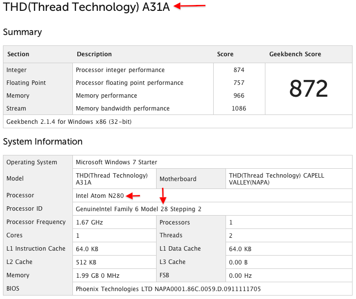

Siobhan Posted July 5, 2010 Share Posted July 5, 2010 which version are u using? good joke if it is one, but it seems like u merged your sysctl dump from E7500 and edited the brand_string with the one from N280 I thought N280 should have cpu model 28. Isn't ? If am wrong, correct me! It seems you 're using this model image source is here confirmed here Well, you are right to be confused, valv. But this person is using tea's kernel hack from here, and as such, the machdep.cpu.model is going to show 23. I also have an Atom, and just for kicks (I normally just use Meklort's NetbookInstaller) I tried AnVAL with the teateam bithacked kernel, and my frequencies (hw.*frequency*) and machdep.cpu.* are all the same as his, see here: hw.busfrequency = 2132000000 hw.cpufrequency = 2048000000 hw.tbfrequency = 1000000000 hw.busfrequency: 2132000000 hw.busfrequency_min: 2132000000 hw.busfrequency_max: 2132000000 hw.cpufrequency: 2048000000 hw.cpufrequency_min: 2048000000 hw.cpufrequency_max: 2048000000 hw.tbfrequency: 1000000000 machdep.cpu.max_basic: 10 machdep.cpu.max_ext: 2147483656 machdep.cpu.vendor: GenuineIntel machdep.cpu.brand_string: Intel® Atom(tm) CPU N270 @ 1.60GHz machdep.cpu.family: 6 machdep.cpu.model: 23 machdep.cpu.extmodel: 1 machdep.cpu.extfamily: 0 machdep.cpu.stepping: 2 machdep.cpu.feature_bits: 3219782655 4244381 machdep.cpu.extfeature_bits: 1048576 1 machdep.cpu.signature: 67266 machdep.cpu.brand: 0 machdep.cpu.features: FPU VME DE PSE TSC MSR PAE MCE CX8 APIC SEP MTRR PGE MCA CMOV PAT CLFSH DS ACPI MMX FXSR SSE SSE2 SS HTT TM SSE3 MON DSCPL EST TM2 SSSE3 TPR PDCM machdep.cpu.extfeatures: XD LAHF machdep.cpu.logical_per_package: 2 machdep.cpu.cores_per_package: 1 machdep.cpu.microcode_version: 522 machdep.cpu.mwait.linesize_min: 64 machdep.cpu.mwait.linesize_max: 64 machdep.cpu.mwait.extensions: 3 machdep.cpu.mwait.sub_Cstates: 131616 machdep.cpu.thermal.sensor: 1 machdep.cpu.thermal.dynamic_acceleration: 0 machdep.cpu.thermal.invariant_APIC_timer: 0 machdep.cpu.thermal.thresholds: 2 machdep.cpu.thermal.ACNT_MCNT: 1 machdep.cpu.arch_perf.version: 3 machdep.cpu.arch_perf.number: 2 machdep.cpu.arch_perf.width: 40 machdep.cpu.arch_perf.events_number: 7 machdep.cpu.arch_perf.events: 0 machdep.cpu.arch_perf.fixed_number: 1 machdep.cpu.arch_perf.fixed_width: 40 machdep.cpu.cache.linesize: 64 machdep.cpu.cache.L2_associativity: 8 machdep.cpu.cache.size: 512 machdep.cpu.tlb.inst.small: 32 machdep.cpu.tlb.data.small: 16 machdep.cpu.tlb.data.small_level1: 2028621756 machdep.cpu.tlb.data.large_level1: 64 machdep.cpu.address_bits.physical: 32 machdep.cpu.address_bits.virtual: 32 machdep.cpu.core_count: 1 machdep.cpu.thread_count: 2 So, unlike Meklort's NBI-modded boot, AnVAL doesn't patch the kernel on-the-fly for Atom CPUs, making it necessary to use teateam's kernel which makes the Atom look like a Core2Solo. I'd be happy to help you test with the Atom, should you decide to implement support, one way or the other. As it stands, my 1.6GHz N270 reports crazy info for both bus and cpufreq using AnVAL. I'm looking forward to trying your bootloader on my Core2Duo-based notebooks as well! Keep up the great work, guys. Link to comment https://www.insanelymac.com/forum/topic/216726-anval-acpi-loader/page/25/#findComment-1505112 Share on other sites More sharing options...
