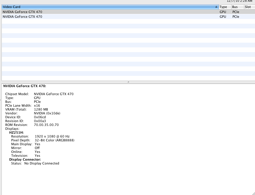

ksosx86. Posted December 4, 2010 Share Posted December 4, 2010 Having an odd issue here: What happens is when I flash my 470s as 465s, OS X recognizes both gpus in sys profiler and System Preferences, but when I run my 470s with 470 BIOSes only one is recognized and the other is labeled "Display" with no functionality at all, does OS X work better with two 465s as opposed to 470s? I mean it's a bit weird. I'm using dual gfx EFI strings to get my cards working, no Graphics Enabler (It causes reboot loop, but EFI doesn't). I uploaded a pic of what I get with dual EFI strings and 470s. Update: Used wrong display path works just fine updated screenshot Link to comment https://www.insanelymac.com/forum/topic/214219-fermigtx-480gtx-470/page/53/#findComment-1596388 Share on other sites More sharing options...
