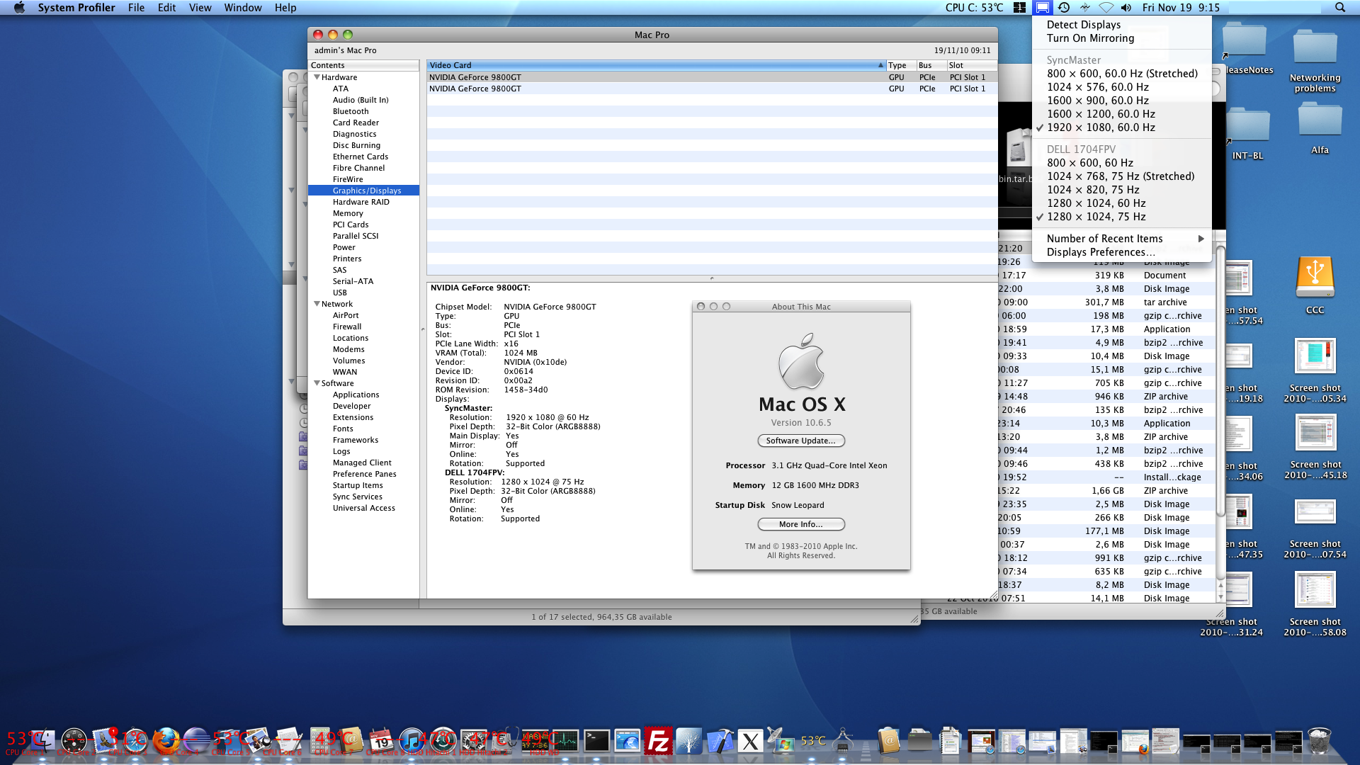

sstyle Posted November 16, 2010 Share Posted November 16, 2010 My 9800 GT works with 1.0.6.5 but if I connect Tv via DVI->HDMI I get freeze. Then I replaced NVDANV50Hal and NVDAResman, evoenabler - no freeze as result, but system cant find second monitor - my TV and my videocard shows as ATI... --- Now everything works fine (HDMI) but only with -x boot flag... My com.apple.boot.plist: <key>GraphicsEnabler</key> <string>Yes</string> If I place NVEnabler64.kext in s\l\e i get grey\black screen on boot. Also I replaced NVDANV50Hal and NVDAResman.. What should I do to work without -x flag? Link to comment https://www.insanelymac.com/forum/topic/214129-1063-nvidia-blank-screen-issue-with-dvihdmi-on-9800gt/page/13/#findComment-1584678 Share on other sites More sharing options...

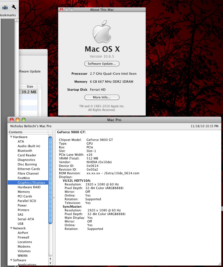

glitchman Posted November 18, 2010 Share Posted November 18, 2010 OKAY. I finally fixed the issue, and was able to get back to having dual displays on my 9800GT, one with DVI-->HDMI, and one with VGA. I have attached the files that I used, just move all of the Extensions to /S/L/E/, and the Framework to /S/L/Frameworks. Also enclosed is my Extra folder so that you can see how the com.apple.Boot.plist file is to be setup. Enjoy! -Nick http://rapidshare.com/files/431696510/DualDisplay9800GT.zip Link to comment https://www.insanelymac.com/forum/topic/214129-1063-nvidia-blank-screen-issue-with-dvihdmi-on-9800gt/page/13/#findComment-1586747 Share on other sites More sharing options...
thiago.net Posted November 19, 2010 Share Posted November 19, 2010 You are using in 10.6.5? Link to comment https://www.insanelymac.com/forum/topic/214129-1063-nvidia-blank-screen-issue-with-dvihdmi-on-9800gt/page/13/#findComment-1586920 Share on other sites More sharing options...
glitchman Posted November 19, 2010 Share Posted November 19, 2010 yes i am. Sorry, I forgot the obligatory, "IT WORKS" screenshot. here it goes. Link to comment https://www.insanelymac.com/forum/topic/214129-1063-nvidia-blank-screen-issue-with-dvihdmi-on-9800gt/page/13/#findComment-1586926 Share on other sites More sharing options...

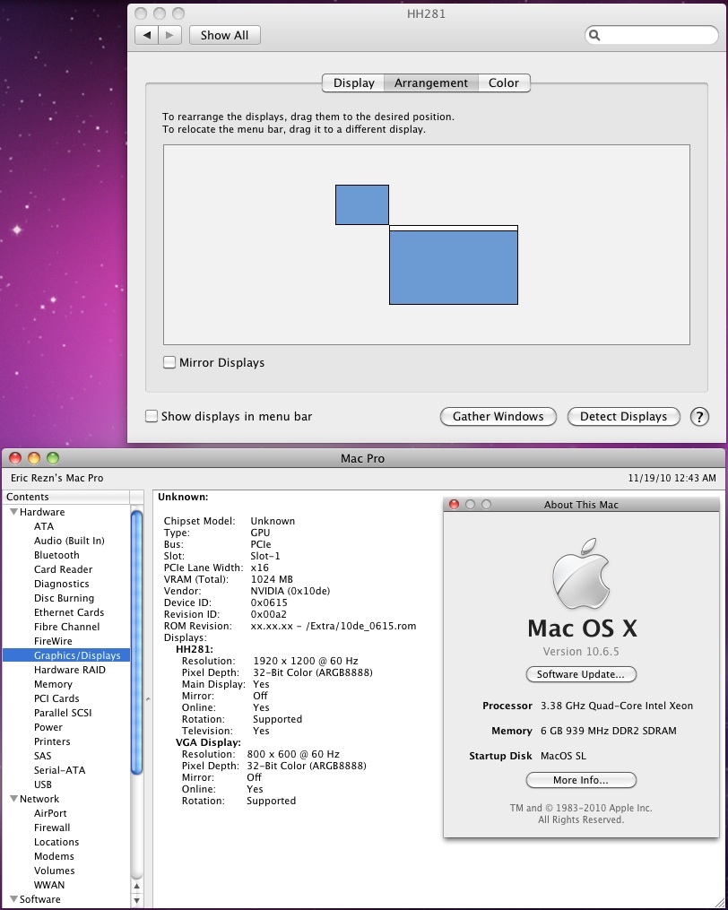

rezn Posted November 19, 2010 Share Posted November 19, 2010 Wow! After trying dsdt, and every enabler known to man, my MSI Twin Frozr GTS 250 finally works. However, your nvidia kexts didn't work with my card. In order to get the kexts to load I had to add my device id into the info plist inside nvdaresman.kext and nvdanv50hal.kext. My card is not a 9800GT, so my results are different, and as you can see from my screenshot the chipset model is listed as Unknown (not that I care since Starcraft 2 works and that was my test). In addition, the screenshot below shows that I have a VGA display attached even though I do not. The only monitor that is attached to my system is my HannsG HH281. I arranged the second screen in the best place so that my cursor has the least chance of being lost. I am really curious how this VGA display is forced. Please let us know how you were finally able to get it working so that further hacks are possible. Thank you! Link to comment https://www.insanelymac.com/forum/topic/214129-1063-nvidia-blank-screen-issue-with-dvihdmi-on-9800gt/page/13/#findComment-1586987 Share on other sites More sharing options...

beyondtool1 Posted November 19, 2010 Share Posted November 19, 2010 Wow! After trying dsdt, and every enabler known to man, my MSI Twin Frozr GTS 250 finally works. However, your nvidia kexts didn't work with my card. In order to get the kexts to load I had to add my device id into the info plist inside nvdaresman.kext and nvdanv50hal.kext. I tried using an ASUS 210 for about a day I stuffed around with it. Had no luck. Could end up changing the default resolution but no QE support, and the card was being detected correctly. Looks like the is no valid kext for this particular card. Did the whole plist thing and everything. Link to comment https://www.insanelymac.com/forum/topic/214129-1063-nvidia-blank-screen-issue-with-dvihdmi-on-9800gt/page/13/#findComment-1587202 Share on other sites More sharing options...
rezn Posted November 19, 2010 Share Posted November 19, 2010 Did you fix permissions after following Glitchman's steps and editing both NVDAResman.kext and NVDAN50HAL.kext ? Link to comment https://www.insanelymac.com/forum/topic/214129-1063-nvidia-blank-screen-issue-with-dvihdmi-on-9800gt/page/13/#findComment-1587284 Share on other sites More sharing options...
