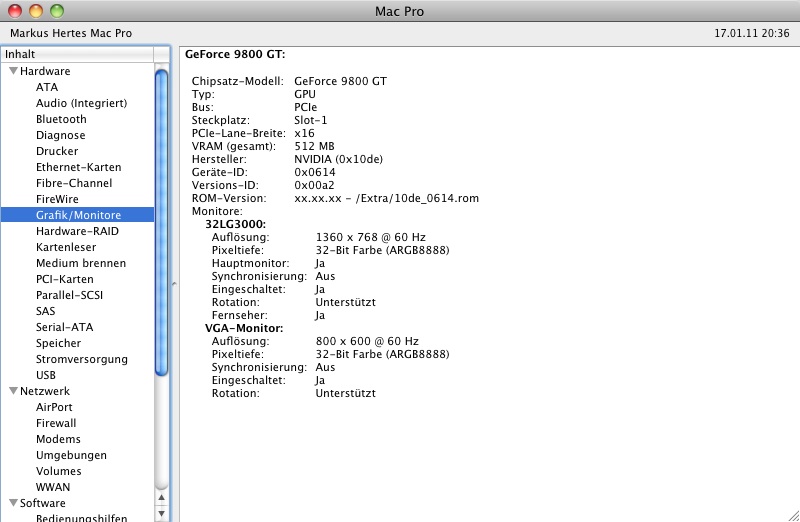

Solution works on full vanilla install, too. I also have ghost display ... what really sucks with this setup, is the need to replace files after each update ... think i´ll have to investigate some deeper ...
Anyway: thanks for the solution so far !!! :angel:

Maybe more important, do I need to manually change anything else related to my vendor_device?
Please reply soon as possible as I will install OSX right now and do not take risks before this is made clear. If all went well I will reply back with the results of your script.
Do a thing, once you download the files and extract it to the desktop, go to the extra folder, copy the .rom file and make a 10de_0615.rom file. You dont need to change anything else manually. It should all be fine.
Thanks.
I'am about to run your script.
*I've extracted your file and copied file and maps from nVidia Drivers directory straight to the desktop.
*I've copied 10de_0614.rom, renamed it to 10de_0615.rom and copied to /Extra
Do I need to install cuda drivers like stated somewhere before one of your posts.
If yes, please Link me the correct version.
Do I still need to add NVCAP string to boot.plist?
( that's what I've been reading some posts before. )
Thanks ( Just wanted to be sure, So I can do this right in 1 time, not a billion because I might have overlooked something )
Does this rom downgrades my performance?
Like I said before, I'm using a GTS250 OC edition and I'am overriding it with a 9800GT rom, correct?
Thanks.
No you dont need to NVCAP strings, you just have to set GraphicsEnabler (see my boot.plist file). Cuda drivers are not required. It shouldn't downgrade your perfomance because a GT250 is basically a renamed 9800GT.
Okay, Then I'll keep my fingers crossed.
Almost done installing 10.6.6 combo update.
I let you know in about 15 minutes from now :)
Thanks again for the effort, I appreciate it.
Looking forward to have HDMI working again.
It worked great in 10.6 retail, until someday it froze and realized it was the updates that caused it.
So I'm defiantly happy with 10.6 retail performance.
Do you happen to know a good solid benchmark for testing afterwards?
There is geekbench to test perfomance. And all the best with the update.
chmod +x updateDrivers.sh ( No such file or directory )
sudo ./updateDrivers.sh (Password:)
I did not enter password yet because the first command line failed.
Am I doing something wrong in the first command line?
My guess is that I need to navigate to desktop in terminal first, but I don't know how.
