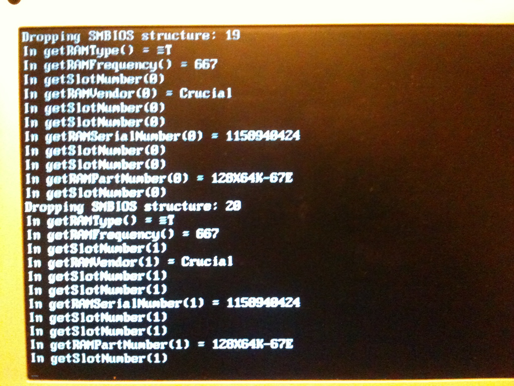

I have not done all picture because my battery get empty, but this time I had a different KP about bad CPU config.
there is another problem i noticed every time i rebbot after KP I have the bios booting into safe mode and it ask me to check CPU freq in bios settings but they are ok.
Note it not reset the bios settings but it thinks that the cpu settings are wrong...
here the only picture I had:
when batteries are recharged i'll put the other part.

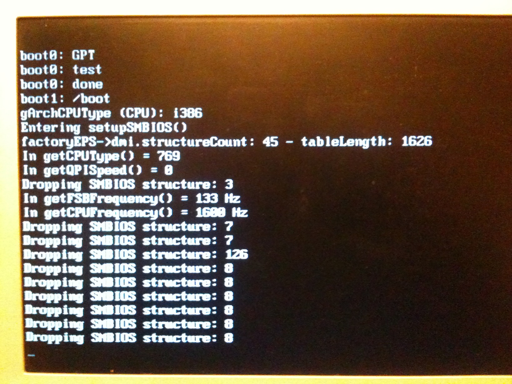

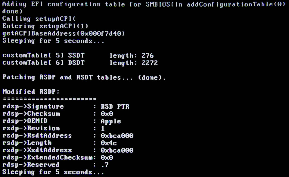

Here all the debug dump I can picture, this time same settings but no KP only the old hang... ??post-464373-1298495593_thumb.jpg

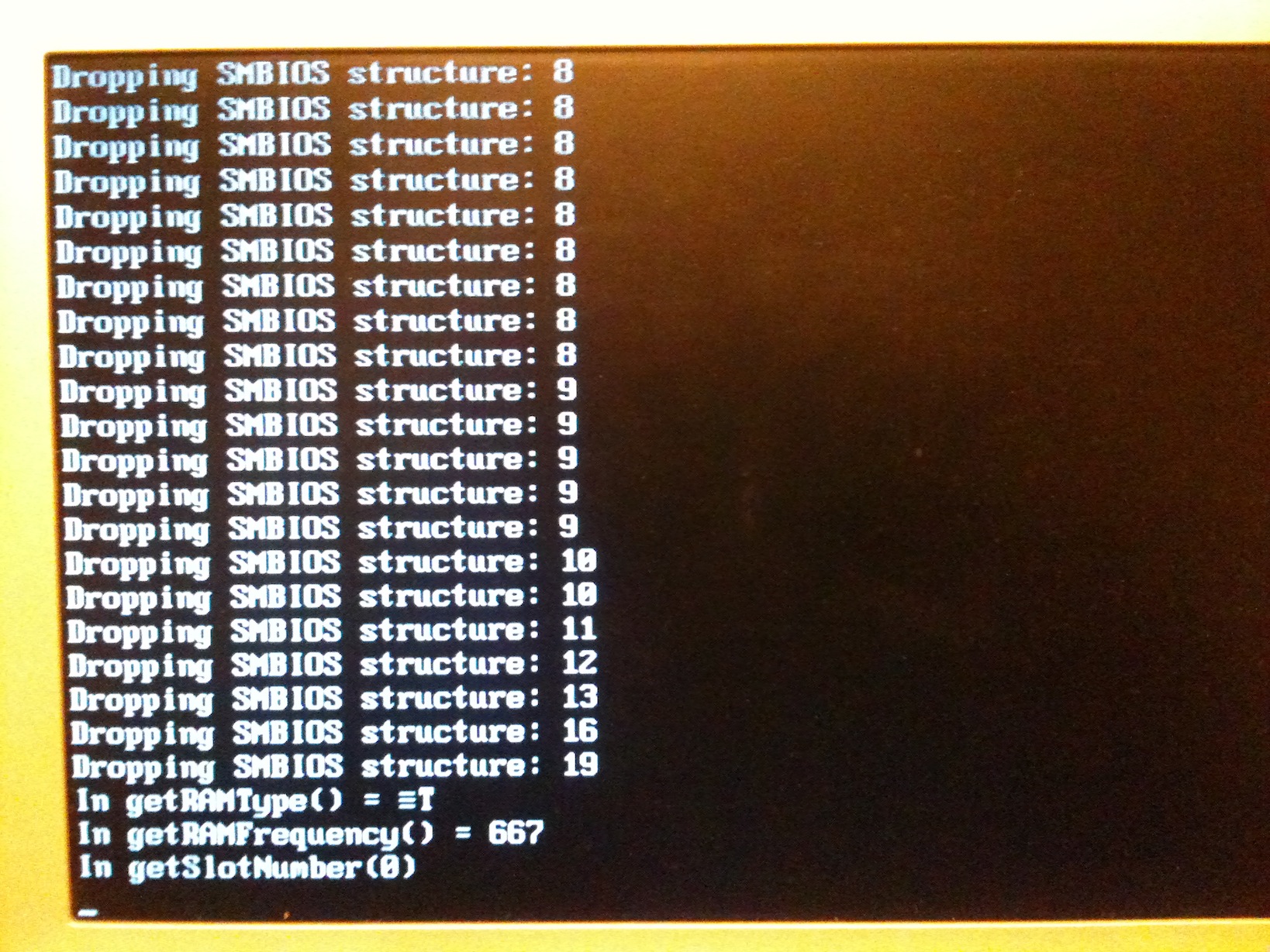

Good to hear that. And attached you'll find a slightly improved debug output (DEBUG_PLATFORM 1) to help you track down the problem.

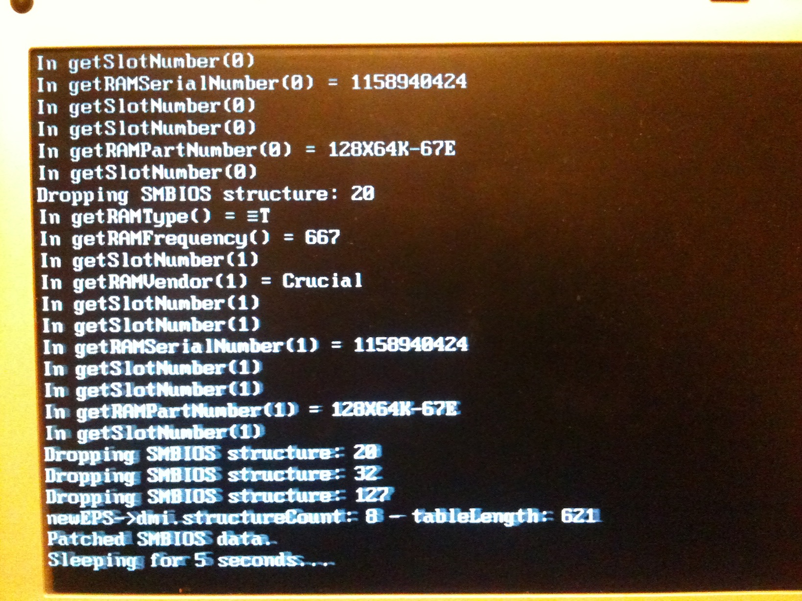

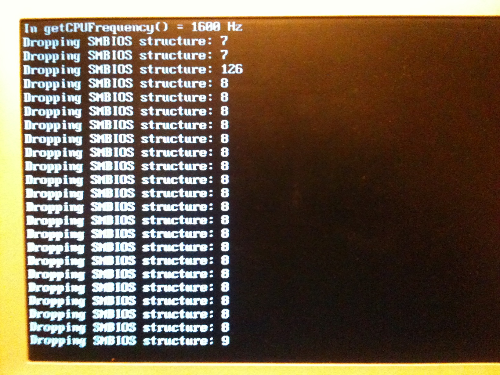

Thanx, debug pic's attached.
Seems size is not being picked up. If I set to dynamic I don't get any ram detect data in the debug at all.
post-170015-1298579683_thumb.jpg post-170015-1298579702_thumb.jpg post-170015-1298579719_thumb.jpg
That's a bummer. Please check this:
2.) Set USE_STATIC_RAM_SIZE to 1.
Should work. Can do more testing later tonight. Let me know if this helped, or not of course.
No further testing needed!
:) How stupid of me, I did not have USE_STATIC_RAM_SIZE set to 1. Everything sorted now. Thanx again.

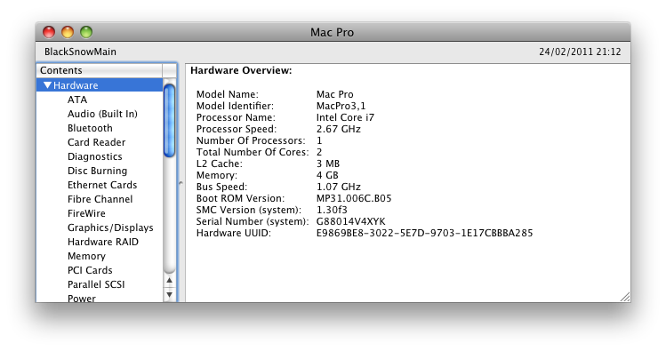

With the new files, everything works as it did before.
• Relying on complete dynamic smbios settings means memory detection ends with 'There was an error while gathering this information.' in System Profiler/Memory, and my Model is named as iMac11,1.
• Enabling #define OVERRIDE_DYNAMIC_MEMORY_DETECTION with my own static memory values works fine.
• Enabling #if OVERRIDE_DYNAMIC_PRODUCT_DETECTION works to change my Model to MacPro3,1.
The only issue is my processor is no longer shown as a core2duo.
Now to try going back to static SMBIOS data.
EDIT3: Using my static SMBIOS data works just fine and my processor is shown as a core2duo again.

The 'About this Mac' box shows the same as System Profiler for both CPU and memory.
Thanks for the file updates. I've tested them with dynamic data in settings.h and the Memory error is now gone, with System Profiler/Memory now populated with the correct two banks identified with the right size, but showing speed of 1066Mhz and type DDR3 as opposed to my 800Mhz DDR2. My CPU is still detected as a Core i7.
