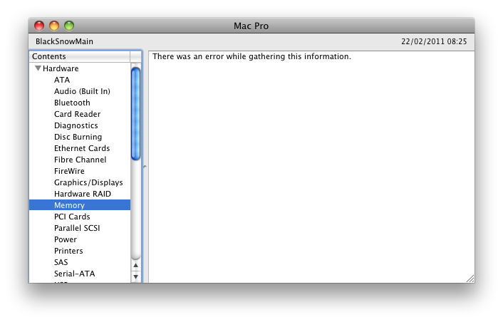

Dynamic detection of ram since these latest changes doesn't work for me (and only partially did before static override).
Maybe not ready for next update! Or does the next update fix this?

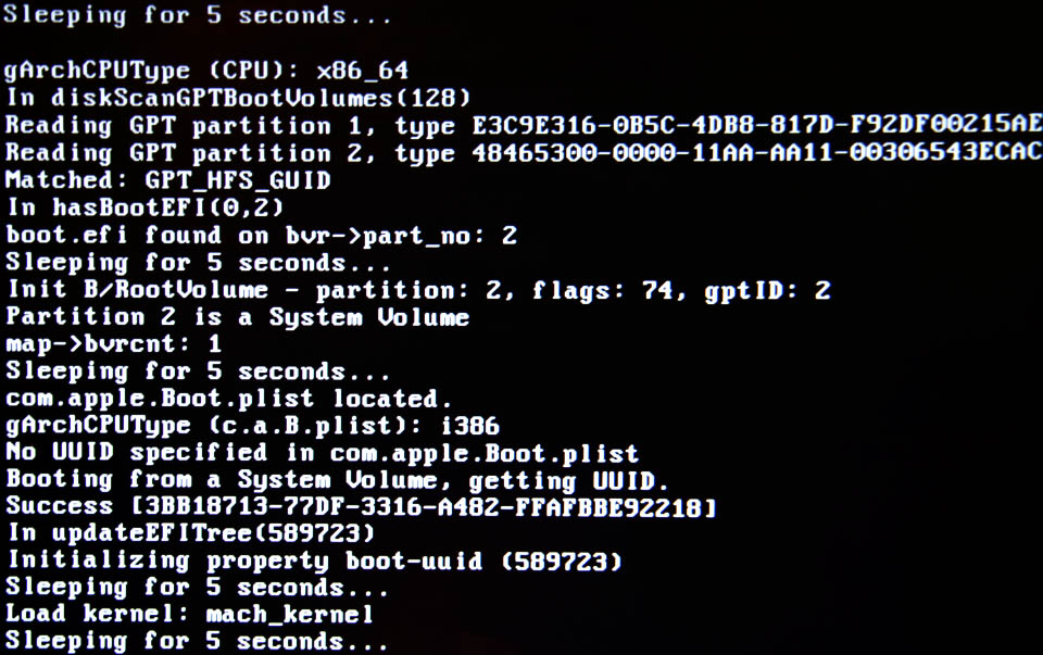

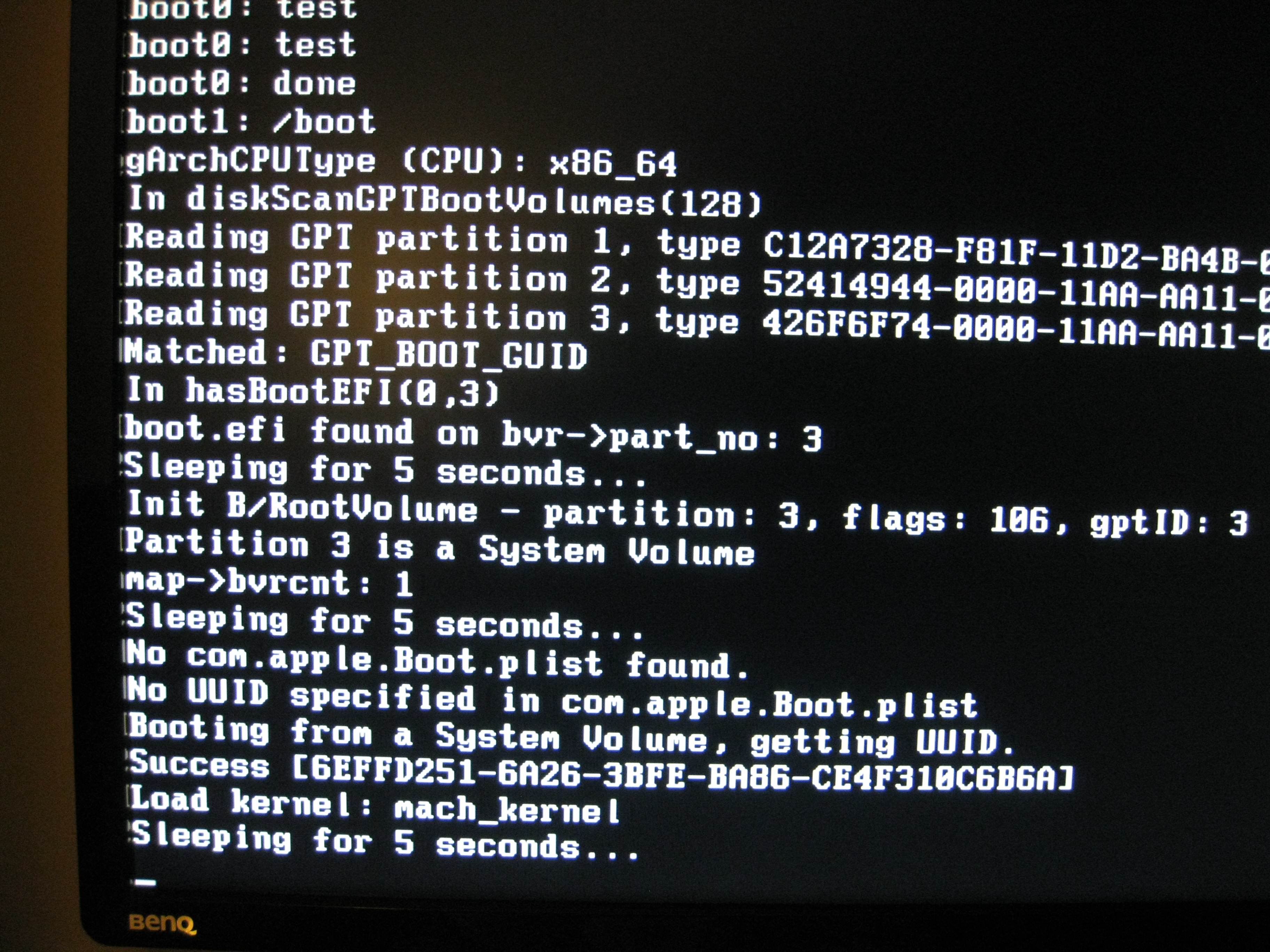

Thanks DB1. problem is I can't see the debug info at boot as it's tiled across the screen and unreadable - I presume any value shown from #define DEBUG_ACPI 1 will be shown at boot in debug text? or is it written to file somewhere?

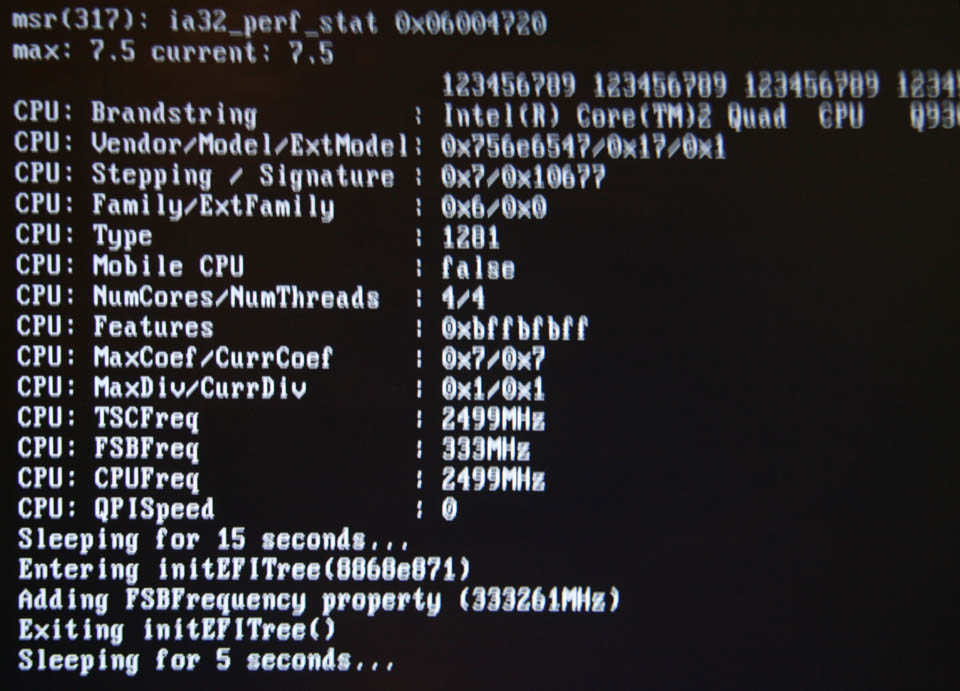

(Configured with dynamic all except override of Dynamic Product Detection (set to MBP), and EFI/DP injection).
-CPU Freq shows 800MHz not 1600. (Core2Solo).
-Like Bloackosx, no memory info in SysProf.
(Stuff is in "About This Mac" where size is correct but Speed is perhaps wrong).

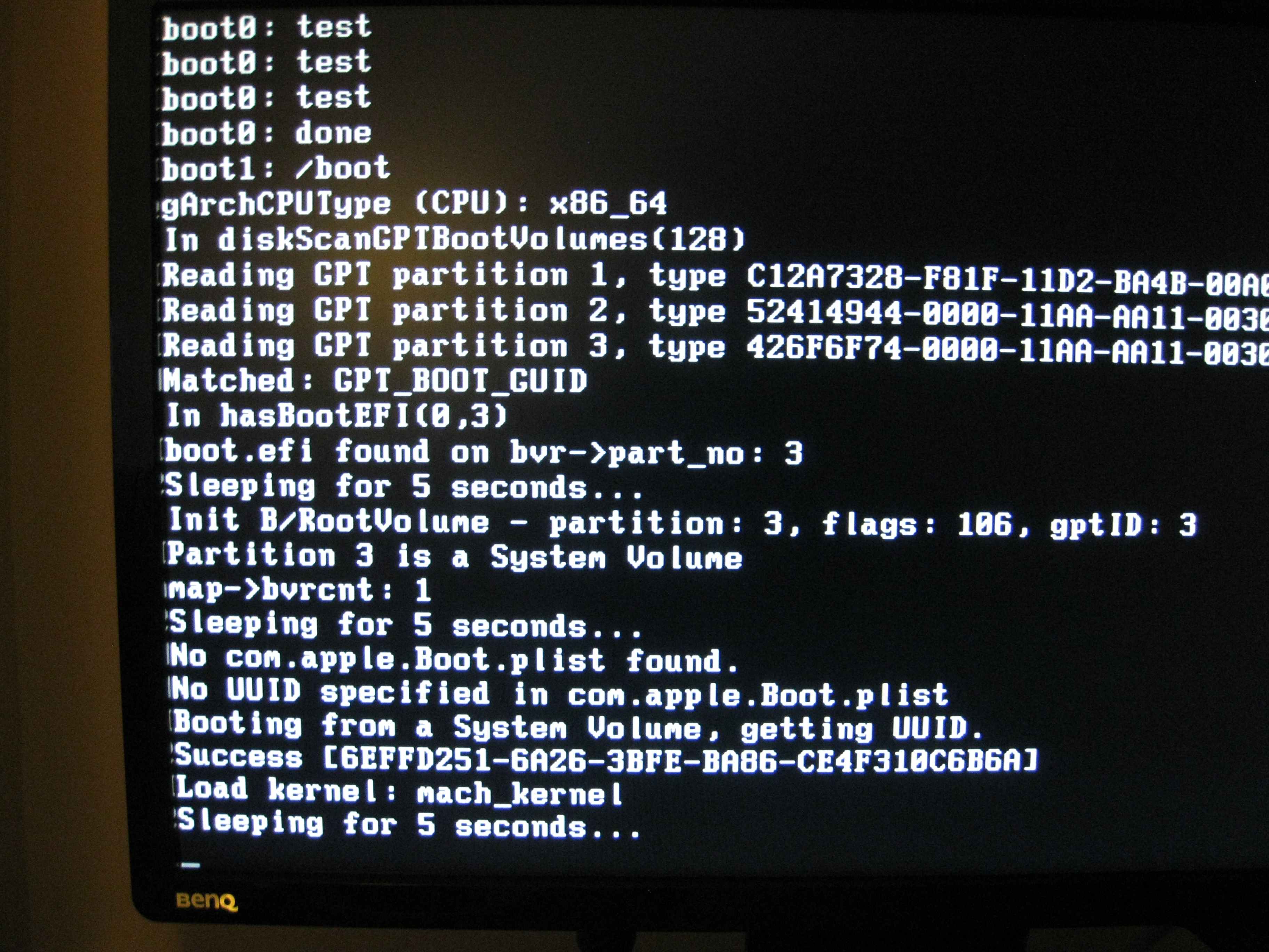

I've tested a build with EFI partition support on my RAID and it's a no go, even if I use
rd=uuid boot-uuid=xxxxxxxxxxxxxxxxx in boot.plist
Would be great if your booter did have software RAID support :)

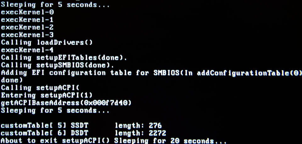

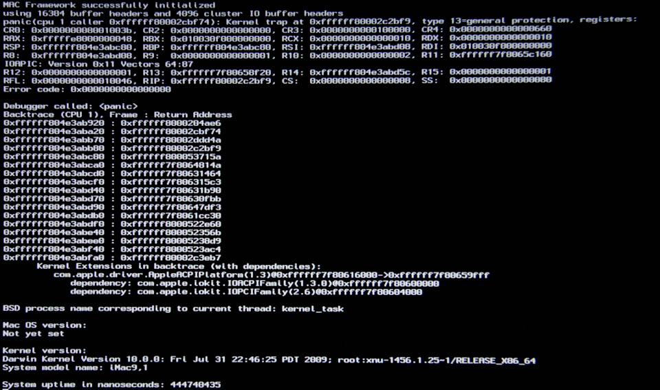

All in all... it appears that the ACPI patcher isn't working. Start by enabling the debug directives (in config/settings.h) and see what happens. Something must be wrong.

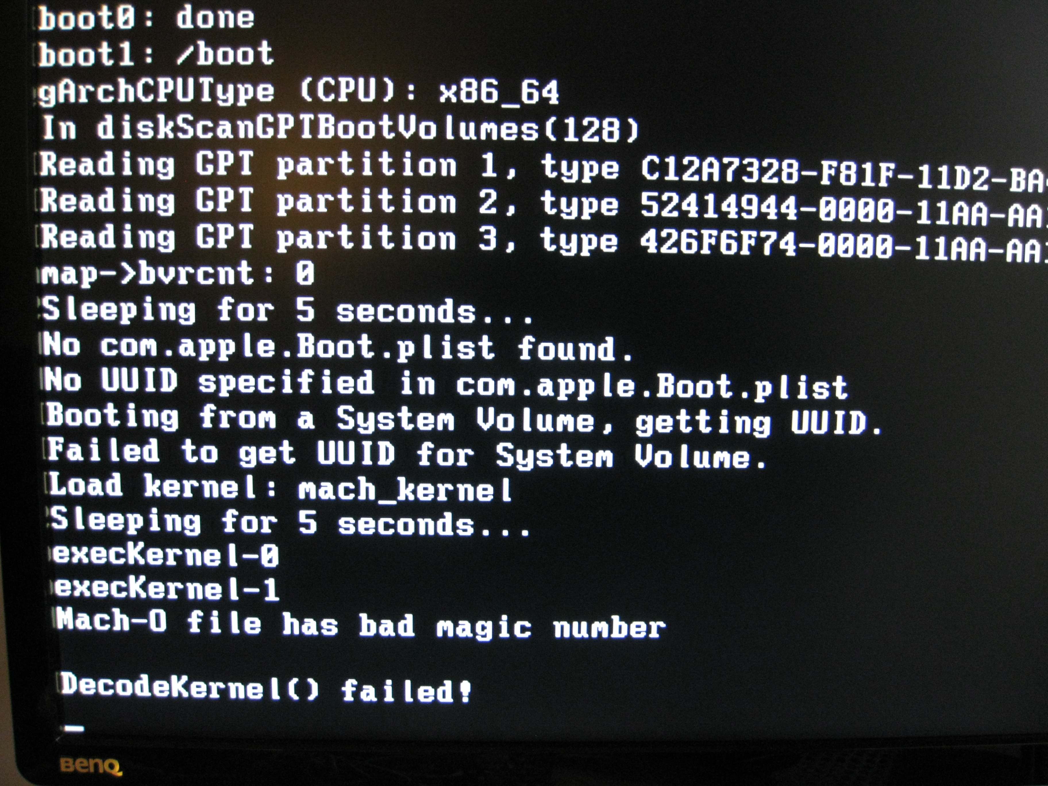

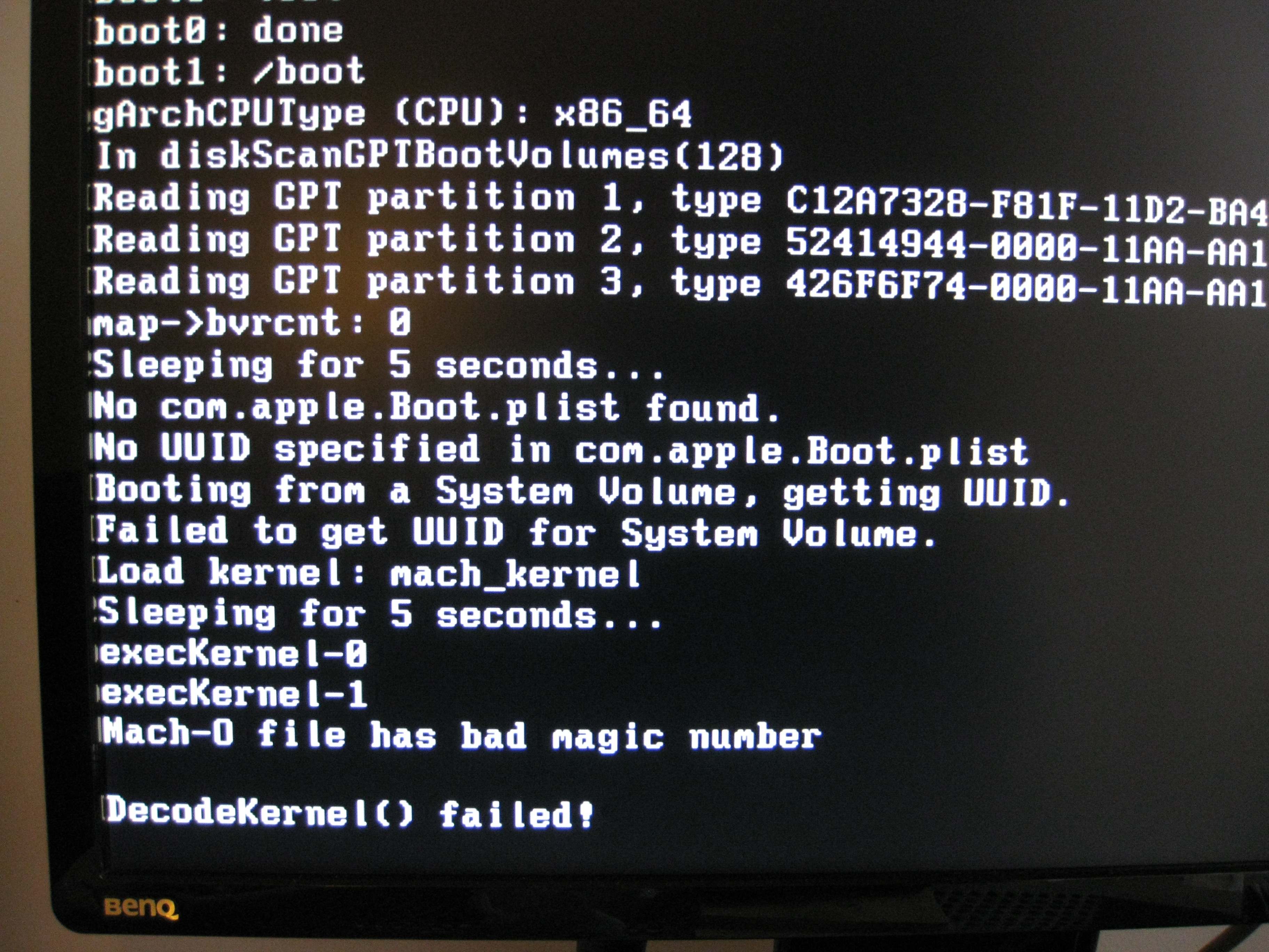

Now I'm not sure if this is down to a mistake of mine (I inadvertently transfared boot1h to rdiskxs1 on my test GUID HDD - currently CCC'ing back to the drive.) and this may also be the problem with themessed up debug text. But rev645 will boot once just fine but on shutdown/ restart the next boot give a KP relating to AppleACPI .. Subsequent reboots also give the same KP!
I only get Revolution to boot again after booting into my main RAID install first!

Ok I've fixed the debug text. As presumed it was down to having transferred boot1h to both diskxs1 and xs2 partitions!
I've seen this mess up the GUI on Chameleon when I've made this error before!

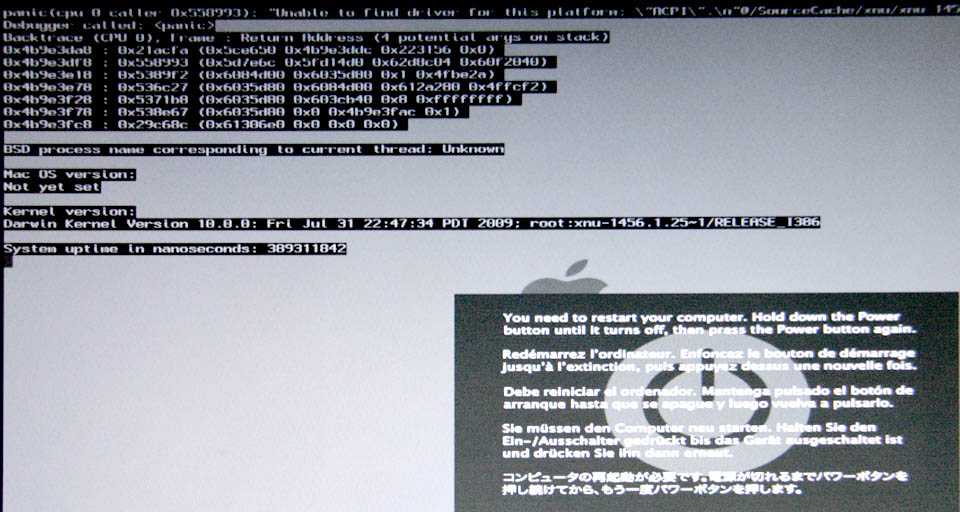

Another schoolboy error - I read my MoBo had ACPI2.0 support so I've been setting #define ACPI_10_SUPPORT 0
ACPI2.0 support it turns out is NOT ACPI2.0 hence my static ACPI tables not being read!
I'm still not entirely sure what was causing the AppleACPI KP but with the bellow settings I'm stable:

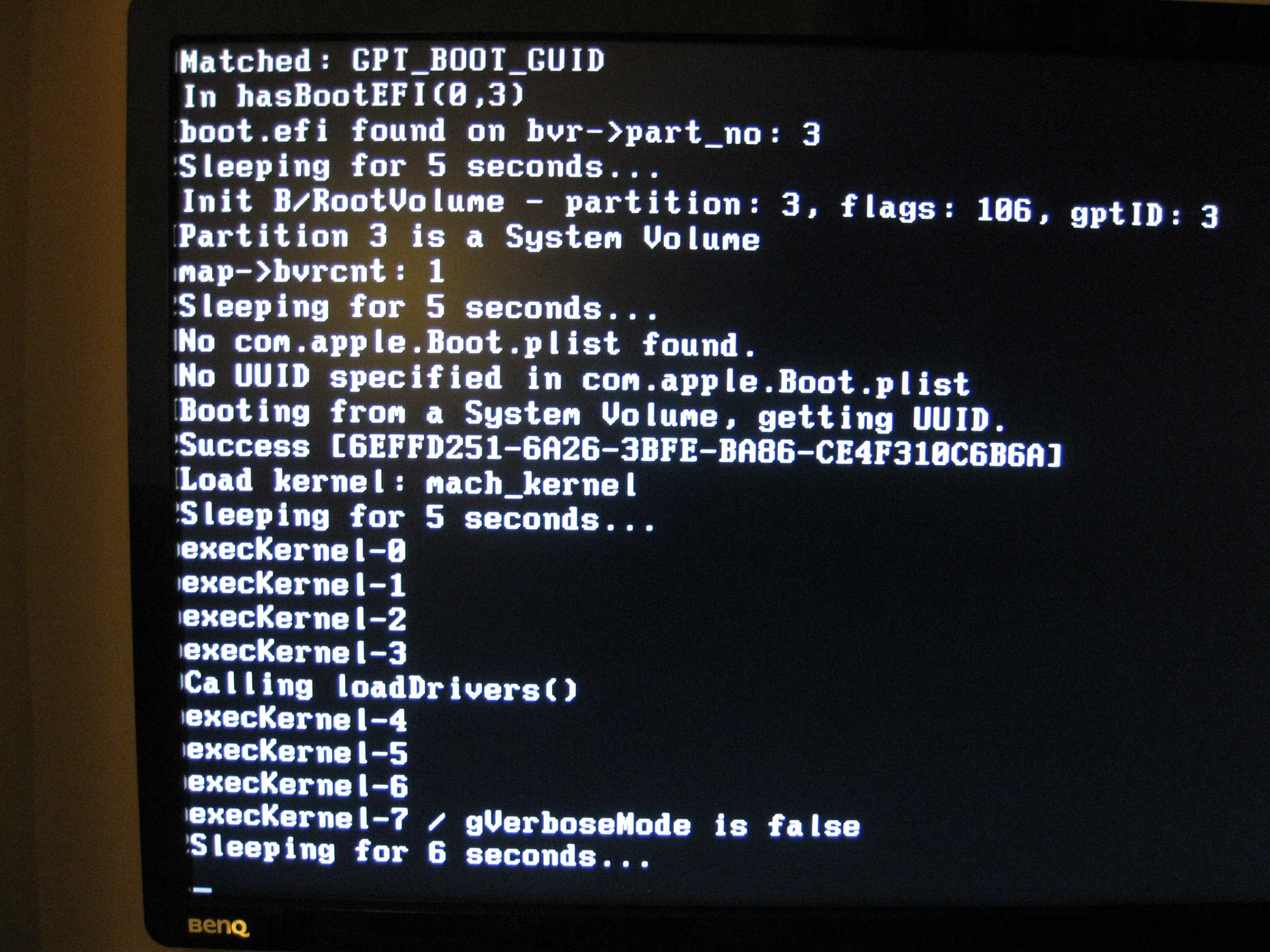

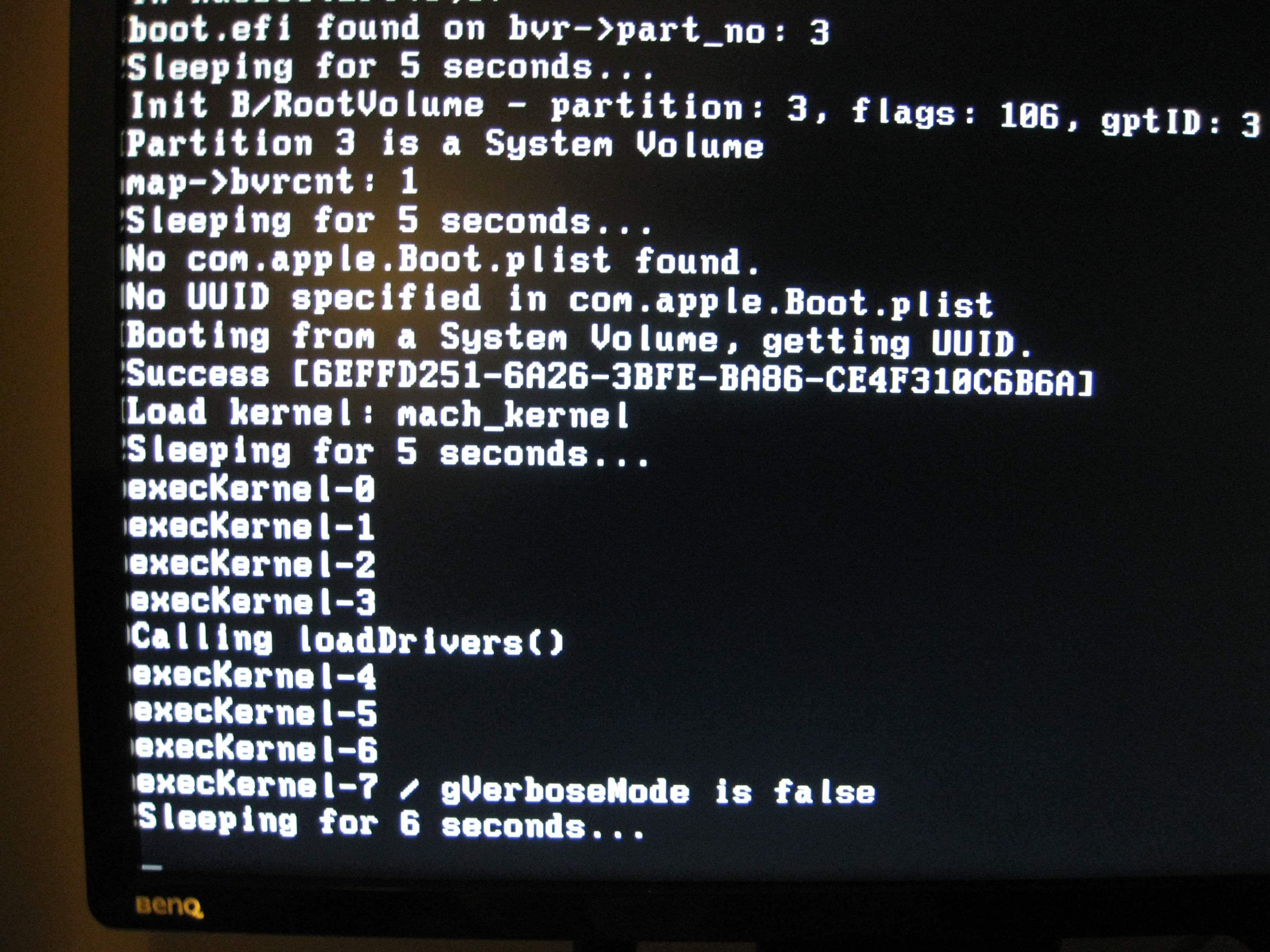

OK below are pics of debug booting from my RAID with and without rd=uuid boot-uuid=xxxxxxx
Enjoy your food! Now I've got to do some housework before I get shouted at :thumbsup_anim: !
D

Note: When this doesn't work for you, then I need the output of diskutil list plus a more detailed one of partition 3 which is disk0s3 I guess (verify me). And also the updated debug output.
Thanks for the quick response DHP.
/dev/disk0
  #:                       TYPE NAME                    SIZE       IDENTIFIER
  0:      GUID_partition_scheme                        *320.1 GB   disk0
  1:                        EFI                         209.7 MB   disk0s1
  2:                 Apple_RAID                         319.7 GB   disk0s2
  3:                 Apple_Boot Boot OSX                134.2 MB   disk0s3
/dev/disk1
  0:     FDisk_partition_scheme                        *250.1 GB   disk1
  1:               Windows_NTFS Windows 7 Boot         104.9 MB   disk1s1
  2:               Windows_NTFS Windows 7 x64          250.0 GB   disk1s2
/dev/disk2
  0:      GUID_partition_scheme                        *320.1 GB   disk2
  1:                        EFI                         209.7 MB   disk2s1
  2:                 Apple_RAID                         319.7 GB   disk2s2
  3:                 Apple_Boot Boot OSX                134.2 MB   disk2s3
/dev/disk3
  0:      GUID_partition_scheme                        *250.1 GB   disk3
  1:                        EFI                         209.7 MB   disk3s1
  2:                  Apple_HFS OS X Backup             249.7 GB   disk3s2
/dev/disk4
  0:                  Apple_HFS Macintosh RAID         *639.5 GB   disk4
/dev/disk6
  0:      GUID_partition_scheme                        *1.0 TB     disk6
  1:                        EFI                         209.7 MB   disk6s1
  2:                  Apple_HFS 1TB RAID                999.9 GB   disk6s2
Please note the 2 RAID0 disks are 0and 1 in BIOS but tend to move around in OSX.
   Device Identifier:        disk0s3
  Device Node:              /dev/disk0s3
  Part Of Whole:            disk0
  Device / Media Name:      Booter 0x650540f6
  Volume Name:              Boot OSX
  Escaped with Unicode:     Boot%FF%FE%20%00OSX
  Mounted:                  No
  File System:              None
  Partition Type:           Apple_Boot
  Bootable:                 Is bootable
  Media Type:               Generic
  Protocol:                 SATA
  SMART Status:             Verified
  Volume UUID:              6EFFD251-6A26-3BFE-BA86-CE4F310C6B6A
  Total Size:               134.2 MB (134217728 Bytes) (exactly 262144 512-Byte-Blocks)
  Volume Free Space:        Not Applicable
  Read-Only Media:          No
  Read-Only Volume:         Not applicable (no filesystem)
  Ejectable:                No
  Whole:                    No
  Internal:                 Yes
EDIT - here's info for the RAID Volume, as you can see it's disk3 with this boot as apposed to disk4 previously:
   Device Identifier:        disk3
  Device Node:              /dev/disk3
  Part Of Whole:            disk3
  Device / Media Name:      Macintosh RAID
  Volume Name:              Macintosh RAID
  Escaped with Unicode:     Macintosh%FF%FE%20%00RAID
  Mounted:                  Yes
  Mount Point:              /
  Escaped with Unicode:     /
  File System:              Journaled HFS+
  Type:                     hfs
  Name:                     Mac OS Extended (Journaled)
  Journal:                  Journal size 49152 KB at offset 0x129f000
  Owners:                   Enabled
  Partition Type:           Apple_HFS
  Media Type:               Generic
  Protocol:                 SATA
  SMART Status:             Not Supported
  Volume UUID:              xxxxxxxxxxxSame as RAID Set UUIDxxxxxxxxxxxxxxxxxxx
  Total Size:               639.5 GB (639455723520 Bytes) (exactly 1248936960 512-Byte-Blocks)
  Volume Free Space:        530.7 GB (530658828288 Bytes) (exactly 1036443024 512-Byte-Blocks)
  Read-Only Media:          No
  Ejectable:                No
  Whole:                    Yes
  Internal:                 Yes
  OS 9 Drivers:             No
  Low Level Format:         Not Supported
  This disk is a RAID Set.  RAID Set Information:
     Set Name:          Macintosh RAID
     RAID Set UUID: xxxxxxxxxxxxxSame as Volume UUID xxxxxxxxxxxxxxxxxx
     Level Type:        Stripe
     Status:            Online
     Chunk Count:       19514640
Looks like it's finding the Volume UUID as apposed to the RAID's UUID.
D

No. Just replace the variable called rootUUID there with a hard coded value. The one you used to have, or still have, in com.apple.Boot.plist giving you something like:
updateEFITree("XXXXXXXX-XXXX-XXXX-XXXX-XXXXXXXXXXXX");
Doh!
It boots but as per debug text it's not finding c.a.b.p. It is in L/P/S.
Hence not seeing my "-v" kernel flag!
EDIT - it's reading Extra/Extensions.mkext off the boot helper partition OK
Cheers
D
Of course it is 'cos that's the UUID of the Volume the boot helper partition is on !!
EDIT - maybe that's the problem with c.a.b.p as it's looking at the Volume UUID of the drive with the helper partition rather than RAID UUID?
EDIT - "Booting from a System Volume, getting UUID"
Bellow the UUID listed is that of one of the drive pair that make my RAID!
D
And is that with or without the change in the source code change?
with RAID UUID added.
So to recap: It loads the kernel and both mkexts from the helper partition but not com.apple.Boot.plist
I have no idea why but maybe in a few hours from now... who knows :angel:
I'm too tired so I have to get back on this later today. Sleep first. Good night all.
that is so. just checking I've not done anything silly.
EDIT - On each helper partition is /Volumes/Boot\ OSX/Library/Preferences/SystemConfiguration/
That didn't contain c.a.b.p or anything else, (I thought this would have been updated from / ?) so I added and it is being taken from there.
I PM you a link for the entire helper partition contents with the c.a.b.p I have added.
Take care

Hi all, I'm still here around but my problems are stiil with me too
I have tested 645 and I have no more hang at kernel loading but instead I have a KP related to no ACPI driver found
ACPI patcher debug looks ok.
Now I'll post some photos
Settings (some leaved as defaults not posted):
ACPI.C
#define PATCH_ACPI_TABLE_DATA				1
#define USE_STATIC_ACPI_BASE_ADDRESS		1
#define STATIC_APIC_TABLE_INJECTION			0
#define STATIC_APIC2_TABLE_INJECTION			0
#define STATIC_DSDT_TABLE_INJECTION			1
#define STATIC_ECDS_TABLE_INJECTION			0
#define STATIC_FACS_TABLE_INJECTION			0
#define STATIC_HPET_TABLE_INJECTION			0
#define STATIC_SSDT_TABLE_INJECTION			1
#define STATIC_SSDT_GPU_TABLE_INJECTION		0
#define STATIC_SSDT_PR_TABLE_INJECTION		0
#define STATIC_SSDT_SATA_TABLE_INJECTION		0
#define STATIC_SSDT_USB_TABLE_INJECTION		0
#define LOAD_DSDT_TABLE_FROM_EXTRA_ACPI		0
#define LOAD_SSDT_TABLE_FROM_EXTRA_ACPI		0
#define LOAD_EXTRA_ACPI_TABLES
#define DROP_SSDT_TABLES					1
#define REPLACE_EXISTING_SSDT_TABLES			0
#define	APPLE_STYLE_ACPI					1
#define	STATIC_ACPI_BASE_ADDRESS		0x000f7d40
BOOT.C
#define PRE_LINKED_KERNEL_SUPPORT			0
#define MUST_ENABLE_A20					0
#define SAFE_MALLOC						0
#define DEBUG_BOOT						1
CPU.C
#define USE_STATIC_CPU_DATA					0
#define CPU_VENDOR_ID						CPU_VENDOR_INTEL
#define DEBUG_CPU							1
CPU/STATIC_DATA.C
#define STATIC_CPU_Vendor					CPU_VENDOR_ID
#define STATIC_CPU_Signature					0x10677
#define STATIC_CPU_Stepping					7
#define STATIC_CPU_Model					CPU_MODEL_PENRYN
#define STATIC_CPU_Family					6
#define STATIC_CPU_ExtModel					0
#define STATIC_CPU_ExtFamily					0
#define STATIC_CPU_Type						0x501
#define STATIC_CPU_NumCores					4
#define STATIC_CPU_NumThreads				4
#define STATIC_CPU_Features					0xbffbfbff
#define STATIC_CPU_CurrCoef					7
#define STATIC_CPU_MaxCoef					7
#define STATIC_CPU_CurrDiv					1
#define STATIC_CPU_MaxDiv					1
#define STATIC_CPU_TSCFrequency				2500000000ULL
#define STATIC_CPU_FSBFrequency				333333333ULL
#define STATIC_CPU_CPUFrequency				2500000000ULL
#define STATIC_CPU_QPISpeed					0
DISK.C
#define EFI_BOOT_PARTITION_SUPPORT			0
#define LEGACY_BIOS_READ_SUPPORT			0
#define DEBUG_DISK							1
EFI.C
#define APPLE_STYLE_EFI						1
#define INJECT_EFI_DEVICE_PROPERTIES			1
#define EFI_64_BIT							1
#define DEBUG_EFI							1
#define STATIC_MODEL_NAME					{  'i', 'M', 'a', 'c', '9', ',', '1' }
SMBIOS.C
#define USE_STATIC_SMBIOS_DATA				1
#define OVERRIDE_DYNAMIC_MEMORY_DETECTION	1
#define OVERRIDE_DYNAMIC_PRODUCT_DETECTION	0
#if OVERRIDE_DYNAMIC_PRODUCT_DETECTION
#define STATIC_SMBIOS_MODEL_ID			IMAC
#define DEBUG_SMBIOS						1
PLATFORM.C
#define DEBUG_PLATFORM						0
#define STATIC_MAC_PRODUCT_NAME			"iMac9,1"
I have tried it after posting the previous results and I have a different KP:
Using #define ACPI_10_SUPPORT set to 1
other settings same as before.
Note: I booted twice with this setting the first boot without fakesmc hangs at kernel loading as expected, the second boot goes on after fakeSMC loaded and then KP
the fist boot instead with ACPI 1 support disabled don't hangs without FakeSMC because the KP comes first I think
Note if I boot with original ACPI data I have cmos reset and this bios don't saves settings for an easy recovery so it's not fun have to restore all the nettings every time I try.
