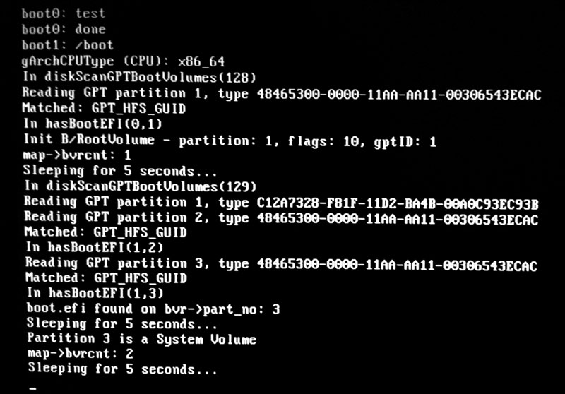

Let me make a new disk.c with additional debug info that I need. Only need the output of the following line:
"Init B/RootVolume - partition: N, flags: N, gptID: N"
Thanks for looking in to it DHP. I'll look a bit later - got to go out again.
UPDATE:
Sorry for the delay DHP.
I've added the revised disk.c and booted from HDD, trying with both of my two HDD's as default drive in BIOS. Each boot my OS X installation on HDD 0 and the output I read is the same for both:
"Init B/RootVolume - partition: 2, flags: 10, gptID: 2"
Using the same boot file from USB, when it boots my OS X installation on HDD 1 (which I can't boot from HDD), the debug reads:
"Init B/RootVolume - partition: 1, flags: 10, gptID: 1"
Hope that helps identify what's going on.
Oh.. and while I'm back to my testing phase, I still have a considerable delay when booting from USB compared to HDD. It occurs after the last disk debug message which reads:
boot.efi found on bvr->part_no: X
Sleeping for 5 seconds
This can then take 20 seconds before I see
Entering Setup ACPI(1)
Note: The enabled debug for this test is:
#define DEBUG_ACPI 1
#define DEBUG_DISK 1
#define DEBUG_PLATFORM 1

Please change the sleep(1); into _DISK_DEBUG_DUMP(1); to see if that's the one we're after.
Gives this:

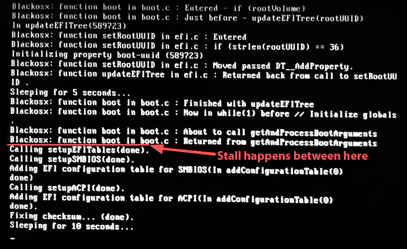

I've been on a bug hunt this morning and although I'm not there yet, I have some progress.
My delay when booting from USB only happens when #define DEBUG_BOOT is set to 0.
I've tracked the code as far as this in boot.c
		else // Booting from USB-stick or SDboot media.
		_BOOT_DEBUG_DUMP("Booting from a Non System Volume, getting UUID.\n");
		// Get target System Volume and UUID in one go.
		BVRef rootVolume = getTargetRootVolume(rootUUID);
		[color="#FF0000"]The code returns to here, then I have the long delay[/color]
		[color="#FF0000"]before seeing the SUCCESS message below.[/color]
		if (rootVolume)
			_BOOT_DEBUG_DUMP("Success [%s]\n", rootUUID);
			// gPlatform.RootVolume = rootVolume;

If it returns there without delay then that is a strange place for a delay. Almost like the hardware has to recover from something bad. Do you have four or six drive connectors on your motherboard?
Yeah. It is strange, but I still wonder why this happens only when #define DEBUG_BOOT is set to 0? as setting it to 1 allows the boot process to continue straight to loading the pre-linked kernel.

I remembered during the night that when I last looked for what's causing my delay, I had only got as far as what I posted in post #1088 and hadn't finished my bug trail, so we can rule out the strange void which I had presumed the code stopped at! Doh!!
I had to leave for work early this morning, so I didn't have much time but I did some more searching and enabling #define DEBUG_EFI to 1 has allowed me to track the code further and I have got as far as this in boot.c :
   // Parse args, load and start kernel.
   while (1)
printf("Blackosx: function boot in boot.c : Now in while(1) before // Initialize globals. \n");  // blackosx added
       sysConfigValid = 0;
       gErrors        = 0;
	int retStatus = -1;
	printf("Blackosx: function boot in boot.c : About to call getAndProcessBootArguments \n");  // blackosx added
	getAndProcessBootArguments(kernelFlags);
	printf("Blackosx: function boot in boot.c : Returned from getAndProcessBootArguments \n");  // blackosx added
               [color="#FF0000"]GOT TO HERE - Will look further this evening....[/color]
#if PRE_LINKED_KERNEL_SUPPORT
though I haven't finished yet and will continue this evening.
And I can also tell you that the delay happens with or without using the pre-linked kernel so we can skip that bit.
I've attached a debug screenshot.
I know I'm getting close to finding the problem and hopefully tonight I will find it.
