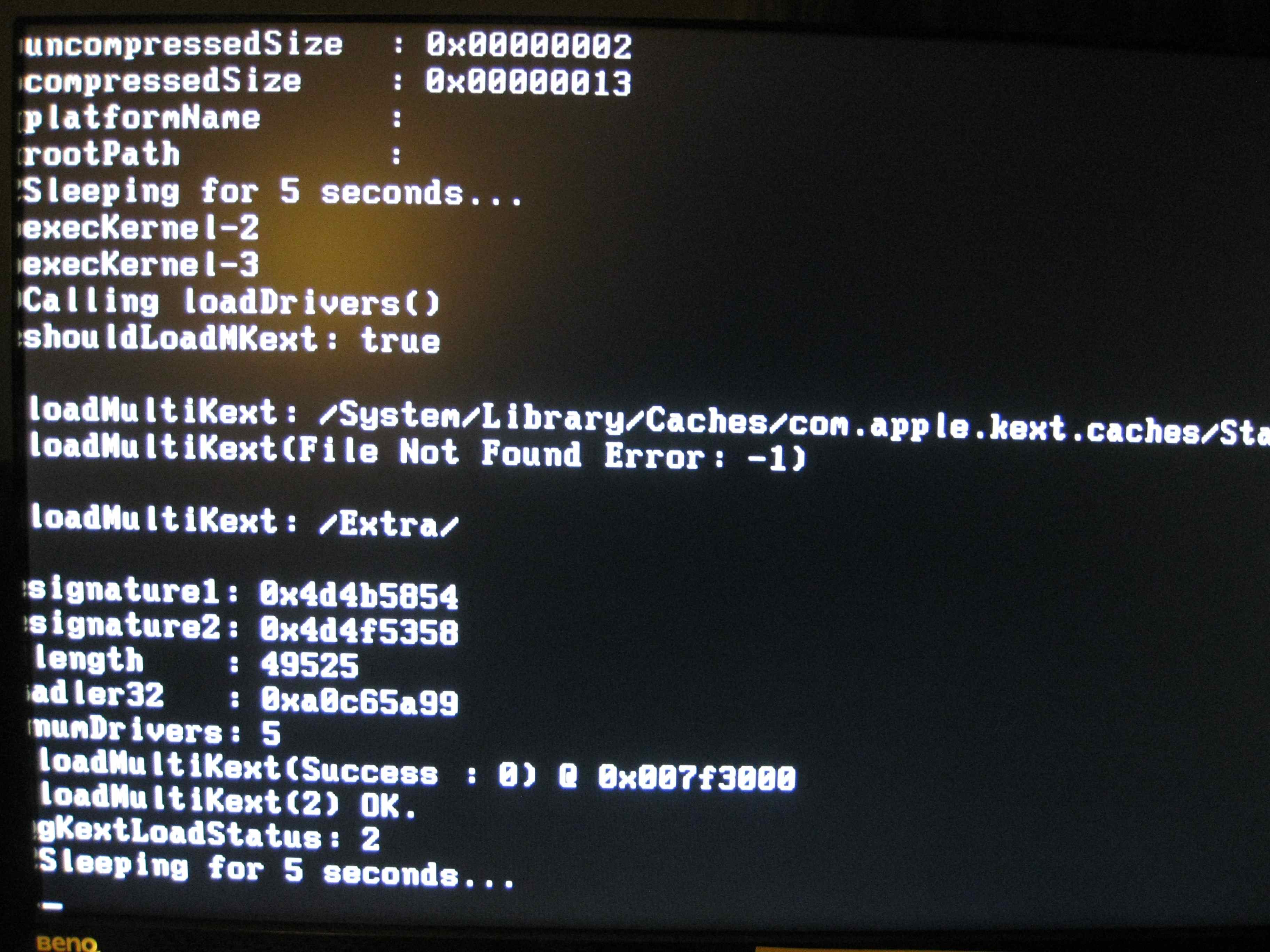

FKA Posted March 5, 2011 Share Posted March 5, 2011 Good evening FKA, That's not the info I need. Sorry, what did you need? I dont see : loadMultiKext(2) OK or loadKexts(2) OK. D Link to comment https://www.insanelymac.com/forum/topic/208807-how-to-boost-the-os-x-boot-process/page/35/#findComment-1649756 Share on other sites More sharing options...

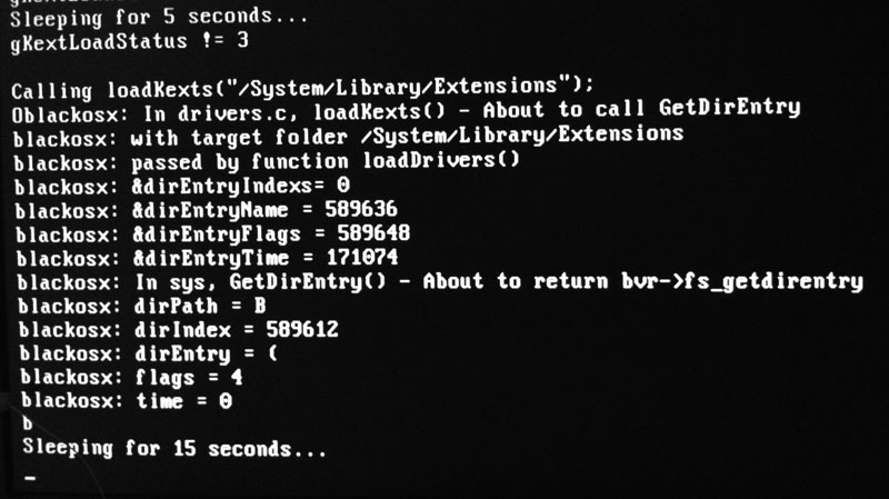

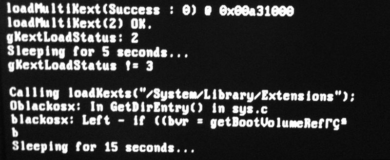

blackosx Posted March 5, 2011 Share Posted March 5, 2011 Hi DHP.... now movie star I read?.. is there no end to your talent? I added a couple of printf's to the GetDirEntry function in /libsaio/sys.c to try to find out why the code doesn't load kexts from Lion's /S/L/E on my system. It might not be much but hopefully it gives you something to go on.. The function with the added printf's: // GetDirEntry - LOW-LEVEL FILESYSTEM FUNCTION. // Fetch the next directory entry for the given directory. long GetDirEntry(const char * dirSpec, long * dirIndex, const char ** dirEntry, long * flags, long * time) { const char * dirPath; BVRef bvr; // Resolve the boot volume from the dir spec. printf("blackosx: In GetDirEntry() in sys.c \n"); if ((bvr = getBootVolumeRef(dirSpec, &dirPath)) == NULL) { printf("blackosx: Entered - if ((bvr = getBootVolumeRef… \n"); return -1; } // Return 0 on success, or -1 if there are no additional entries. printf("blackosx: Left - if ((bvr = getBootVolumeRef… \n"); return bvr->fs_getdirentry(bvr, (char *)dirPath, dirIndex, (char **)dirEntry, flags, time, 0, 0); } And the debug result: So the code doesn't enter the if statement... Link to comment https://www.insanelymac.com/forum/topic/208807-how-to-boost-the-os-x-boot-process/page/35/#findComment-1649837 Share on other sites More sharing options...

blackosx Posted March 6, 2011 Share Posted March 6, 2011 I've been trying to add more debug in to the code to discover why I can't load from /S/L/E.. However, I'm not too good with this C code. In drivers.c I added the following printf's: while (1) { _DRIVERS_DEBUG_DUMP("O"); printf("blackosx: In drivers.c, loadKexts() - About to call GetDirEntry \n"); printf("blackosx: with target folder /System/Library/Extensions \n"); printf("blackosx: passed by function loadDrivers() \n"); printf("blackosx: &dirEntryIndexs= %d \n",dirEntryIndex); printf("blackosx: &dirEntryName = %d \n",dirEntryName); printf("blackosx: &dirEntryFlags = %d \n",dirEntryFlags); printf("blackosx: &dirEntryTime = %d \n",dirEntryTime); result = GetDirEntry(targetFolder, &dirEntryIndex, &dirEntryName, &dirEntryFlags, &dirEntryTime); if (result == -1) { _DRIVERS_DEBUG_DUMP("b"); In sys.c I added the following printf's: } // Return 0 on success, or -1 if there are no additional entries. printf("blackosx: In sys, GetDirEntry() - About to return bvr->fs_getdirentry \n"); printf("blackosx: dirPath = %c \n", dirPath); printf("blackosx: dirIndex = %ld \n", dirIndex); printf("blackosx: dirEntry = %c \n", dirEntry); printf("blackosx: flags = %c \n", flags); printf("blackosx: time = %c \n", time); return bvr->fs_getdirentry(bvr, (char *)dirPath, dirIndex, (char **)dirEntry, flags, time, 0, 0); } Which gives me this in debug when booting from either HDD or USB: However, I don't think this is much help as I don't as yet know what those reported values represent to my system and how I could used them to help me.... You do have your extensions in place on your USB-stick with GPT? I have Extensions.mkext in USB/Extra if that's what you're asking, but nothing else. And yes, using GPT. Link to comment https://www.insanelymac.com/forum/topic/208807-how-to-boost-the-os-x-boot-process/page/35/#findComment-1650004 Share on other sites More sharing options...

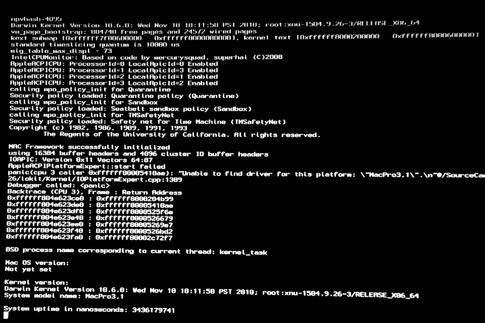

scrax Posted March 6, 2011 Share Posted March 6, 2011 Hi all, I have a little improvement with last release. I have a KP instead of the hang NOTE: I've also moved fakesmc from /S*/L*/E*/ to /E*/E*/ Here the debug and KP picture Link to comment https://www.insanelymac.com/forum/topic/208807-how-to-boost-the-os-x-boot-process/page/35/#findComment-1650189 Share on other sites More sharing options...
FKA Posted March 6, 2011 Share Posted March 6, 2011 NOTE: I've also moved fakesmc from /S*/L*/E*/ to /E*/E*/ So it looks like, in our case, FakeSMC isn't being loaded whether it's in /S/L/E or /E/E ! Your verbose output show AppleACPIExpert isn't loaded prior to KP Out of interest is you FakeSMC stock? have you made any edits to the info plist other than change the revision key? D Link to comment https://www.insanelymac.com/forum/topic/208807-how-to-boost-the-os-x-boot-process/page/35/#findComment-1650200 Share on other sites More sharing options...

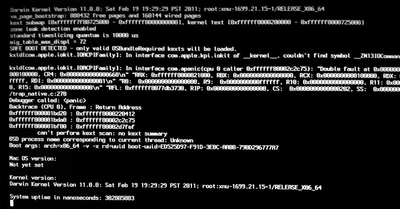

blackosx Posted March 6, 2011 Share Posted March 6, 2011 On your USB of course! Okay, Thanks.. so now we have the hokus pokus.. and booting with -x, the process ends with this KP. Link to comment https://www.insanelymac.com/forum/topic/208807-how-to-boost-the-os-x-boot-process/page/35/#findComment-1650223 Share on other sites More sharing options...

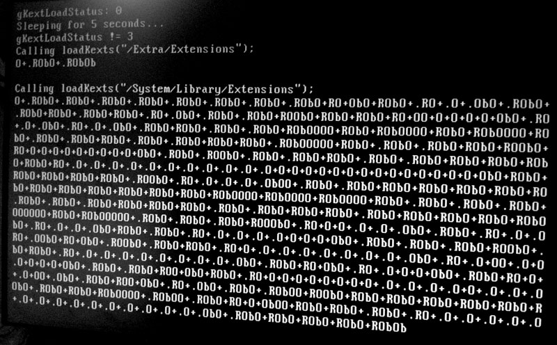

blackosx Posted March 6, 2011 Share Posted March 6, 2011 Note. Why i don't have ocus pocus??? Hi scrax Have you enabled #define DEBUG_DRIVERS ? Great link.. Love it. Link to comment https://www.insanelymac.com/forum/topic/208807-how-to-boost-the-os-x-boot-process/page/35/#findComment-1650280 Share on other sites More sharing options...
