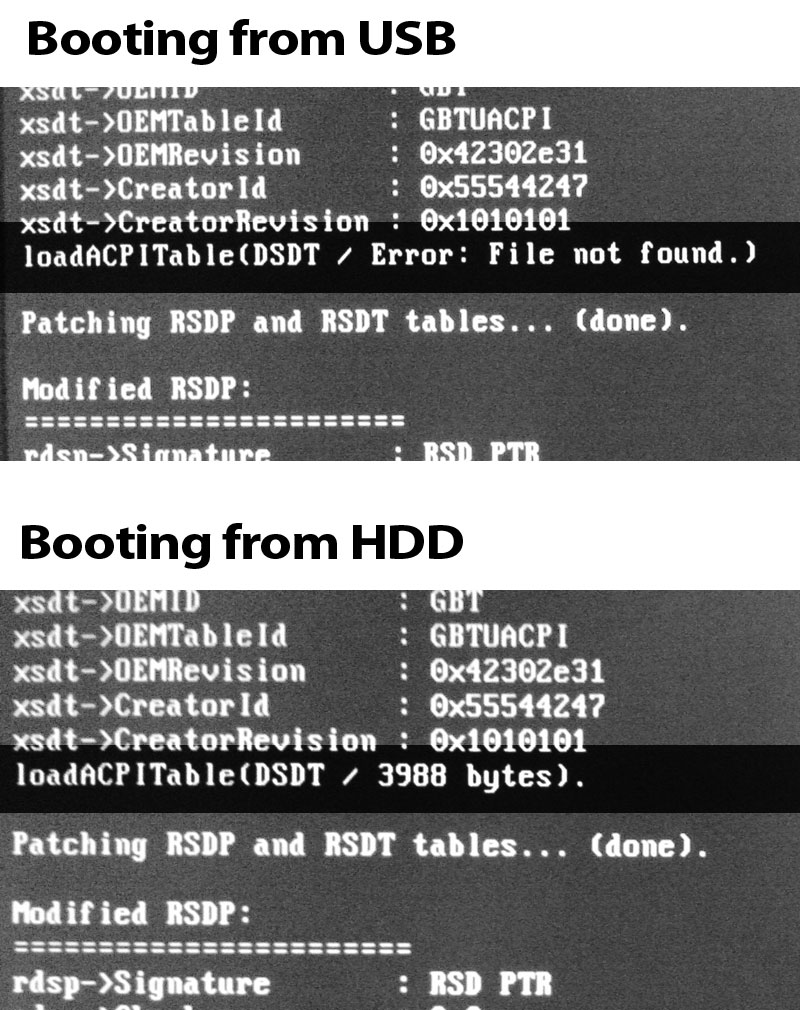

blackosx Posted February 7, 2011 Share Posted February 7, 2011 Something tells me that this is related to FACS (wake/sleep vectors) which you said wasn't picking up. Maybe.. But just been testing without my static DSDT data and have noticed that rev-641 doesn't find /Extra/ACPI/dsdt.aml on my USB, but rev-640 does. Both built using the same private_data.h. And when booting from rev-640 i can wake from sleep again EDIT: This is far from conclusive. I'll continue testing in the morning to try and nail something down here. But at the moment I'm testing with the following enabled directives in private_data.h and with rev-640 I can wake from sleep, though rev-641 doesn't find /Extra/APCI/dsdt.aml which results in a KP. #define ACPI_10_SUPPORT 1 #define PATCH_ACPI_TABLE_DATA 1 #define LOAD_DSDT_TABLE_FROM_EXTRA_ACPI 1 #define DROP_SSDT_TABLES 1 #define APPLE_STYLE_ACPI 1 #define DEBUG_ACPI 1 #define PRE_LINKED_KERNEL_SUPPORT 1 #define USE_STATIC_CPU_DATA 1 #define APPLE_STYLE_EFI 1 #define INJECT_EFI_DEVICE_PROPERTIES 1 #define EFI_64_BIT 1 #define USE_STATIC_SMBIOS_DATA 1 Bed time - I'll carry on in the morning. Link to comment https://www.insanelymac.com/forum/topic/208807-how-to-boost-the-os-x-boot-process/page/24/#findComment-1636192 Share on other sites More sharing options...

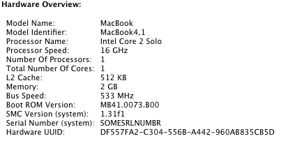

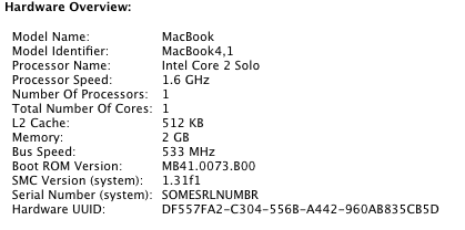

scrax Posted February 8, 2011 Share Posted February 8, 2011 But that is 24GHz. Please. Have a look at the format (length) I am using: 226 100 000 ULLAlso. System Profiler reports: Bus Speed: 533 MHz (133 * 4) for the HP notebook with the value I use (133 333 333 ULL) and 333 333 333 ULL works for a Quad Core CPU where System Profile reports: Bus Speed: 1.33 GHz (333 * 4) . Now. That should get you started. Right? Yess thank's I putted a more zero in the TSCFreq, CPUFreq was right instead. EDIT: Now it doesn't reboot anymore with static CPU data Link to comment https://www.insanelymac.com/forum/topic/208807-how-to-boost-the-os-x-boot-process/page/24/#findComment-1636348 Share on other sites More sharing options...

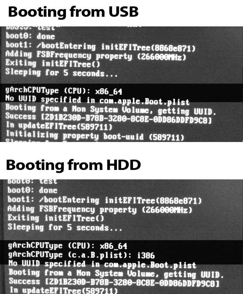

blackosx Posted February 8, 2011 Share Posted February 8, 2011 Good morning DHP and all This is probably also why it doesn't open/read com.apple.Boot.plist and/or /Extra/ACPI/dsdt.aml anymore. Just to confirm a bit more about my problem last night, I can use rev-641 to successfully find and load my /Extra/ACPI/dsdt.aml from HDD just not from USB. Here's a screenshot of my ACPI debug booting with the same boot file and files from both USB and HDD. This I guess is the same reason that I end up booting the kernel in 64-bit mode with booting from USB as rev-641 doesn't find my c.a.B.p on it. Screenshot for the debug showing locating (or not) of c.a.B.p. Link to comment https://www.insanelymac.com/forum/topic/208807-how-to-boost-the-os-x-boot-process/page/24/#findComment-1636359 Share on other sites More sharing options...

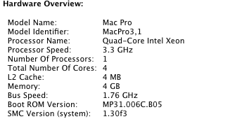

GrootWitBaas Posted February 8, 2011 Share Posted February 8, 2011 I can boot with static cpu now. Only thing I am not sure is what actual speed I am running, about this mac and geek-bench does not agree on this. O and I still have Bus speed 1.76GHz but it should be 400*4. About this Mac reports a 3,3GHz even with my settings on 2,4. My current setting is below for Q8300 #define STATIC_CPU_Vendor 0x756E6547 //Intel #define STATIC_CPU_Signature 0x1067a //Q8300 #define STATIC_CPU_Stepping 0xa //Stepping 10 #define STATIC_CPU_Model CPU_MODEL_PENRYN //Intel® Core(tm)2 Quad CPU Q8300@2.50GHz #define STATIC_CPU_Family 0x6 // 6 #define STATIC_CPU_ExtModel 0x1 //1 #define STATIC_CPU_ExtFamily 0x0 // 0 #define STATIC_CPU_Type 0x501 //1281 #define STATIC_CPU_NoCores 0x4 //4 #define STATIC_CPU_NoThreads 0x4 //4 #define STATIC_CPU_Features 0xbffbfbff // #define STATIC_CPU_CurrCoef 0x6 // 6 current setting in bios #define STATIC_CPU_MaxCoef 0x7 // should be 7.5 max setting in bios #define STATIC_CPU_CurrDiv 0x1 // 1 #define STATIC_CPU_MaxDiv 0x1 // 1 #define STATIC_CPU_TSCFrequency 240000000ULL //2,4GHz #define STATIC_CPU_FSBFrequency 400000000ULL //400MHz #define STATIC_CPU_CPUFrequency 240000000ULL //2,4GHz #define STATIC_CPU_QPISpeed 0 //0 Link to comment https://www.insanelymac.com/forum/topic/208807-how-to-boost-the-os-x-boot-process/page/24/#findComment-1636360 Share on other sites More sharing options...

blackosx Posted February 8, 2011 Share Posted February 8, 2011 I'll attach a new update for disk.c shortly... And here it is. This should take care of the problems. Verified on two different systems with my USB-stick / SD-card and external USB-drive. Hi dutchhockeypro Thanks for looking in to this and coming up with a fix. I'll try it tonight and report back. Link to comment https://www.insanelymac.com/forum/topic/208807-how-to-boost-the-os-x-boot-process/page/24/#findComment-1636525 Share on other sites More sharing options...

blackosx Posted February 8, 2011 Share Posted February 8, 2011 Thanks for looking in to this and coming up with a fix. I'll try it tonight and report back. Hi dutchhockeypro All systems go booting from USB with the new disk.c. Well done with the fix My /Extra/ACPI/dsdt.aml is now loaded which means my wake from sleep dsdt fix is now back. The c.a.B.p is correctly loaded and I can boot the kernel in 32-bit mode again. Link to comment https://www.insanelymac.com/forum/topic/208807-how-to-boost-the-os-x-boot-process/page/24/#findComment-1636609 Share on other sites More sharing options...
