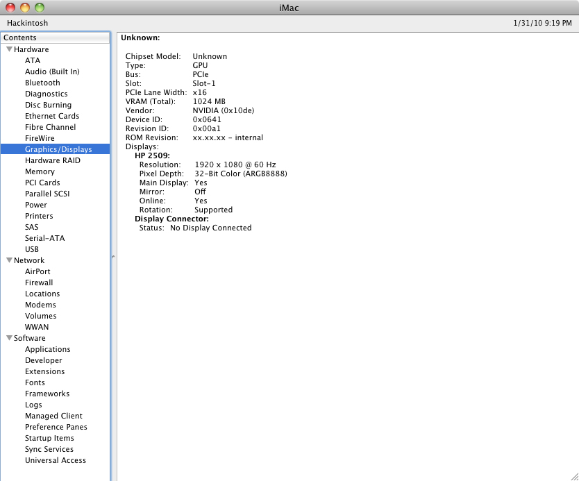

ooda55 Posted January 31, 2010 Share Posted January 31, 2010 Has anyone managed to get this working on the 1GB version of the card also how do you find out the device id of your card? and what things need to be changed in each file, a proper step by step would be REALY hady for this one Looking forward to getting imovie working thanks chris Link to comment https://www.insanelymac.com/forum/topic/206168-drivers-for-nvidia-geforce-9400-gt-success/page/13/#findComment-1400793 Share on other sites More sharing options...
