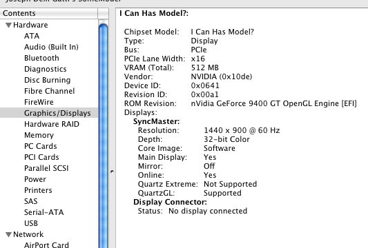

tempest.nano Posted May 18, 2009 Share Posted May 18, 2009 I have installed 10.5.6 (Chameleon v2.0 RC1) using a BFG 9400GT 512MB (DVI/Svideo/VGA) with the monitor on the DVI port. I have tried using a custom EFI string (osx86 tools) using the custom NVCAP (as well as all the standard ones) for this card which yields no QE/CI. The drivers in this thread which seem to work like a charm, but the card runs at full speed for 3-10 minutes (gaming included), then everything becomes choppy no matter what I am doing. All 3d games, apps and desktop effects are very slow from that point on until the next reboot. I am hopelessly lost, and any help would be appreciated. Thanks It appears that my problem was the card overheating. It was getting up to some critical temperature then going into low power mode, which could only be reset by a reboot. I have since replaced the card with an ATI 4870. Link to comment https://www.insanelymac.com/forum/topic/206168-drivers-for-nvidia-geforce-9400-gt-success/page/8/#findComment-1158834 Share on other sites More sharing options...

wildchild Posted May 19, 2009 Share Posted May 19, 2009 It appears that my problem was the card overheating. It was getting up to some critical temperature then going into low power mode, which could only be reset by a reboot. I have since replaced the card with an ATI 4870. I had a similar problem with my old 7600 GT. Only in that case, the capacitors on the card exploded I have this exact same card as tempest.nano (BFG 9400GT) and am hesitant to try it. Any thoughts on how to prevent overheating? Link to comment https://www.insanelymac.com/forum/topic/206168-drivers-for-nvidia-geforce-9400-gt-success/page/8/#findComment-1159577 Share on other sites More sharing options...

tempest.nano Posted May 20, 2009 Share Posted May 20, 2009 I had a similar problem with my old 7600 GT. Only in that case, the capacitors on the card exploded I have this exact same card as tempest.nano (BFG 9400GT) and am hesitant to try it. Any thoughts on how to prevent overheating? I've taken a closer look at the card that I pulled, and it appears that the fan had completely seized up, so it was simply a hardware problem with my particular card. Go ahead and use it, you should be golden. Link to comment https://www.insanelymac.com/forum/topic/206168-drivers-for-nvidia-geforce-9400-gt-success/page/8/#findComment-1160415 Share on other sites More sharing options...
wildchild Posted May 20, 2009 Share Posted May 20, 2009 I've taken a closer look at the card that I pulled, and it appears that the fan had completely seized up, so it was simply a hardware problem with my particular card. Go ahead and use it, you should be golden. sweet! Thanks for the info! Although, let this be a warning to everyone. I have had two of these cards and one of them had a similar cooling issue. Tread with caution with the BFG 9400 GT! Link to comment https://www.insanelymac.com/forum/topic/206168-drivers-for-nvidia-geforce-9400-gt-success/page/8/#findComment-1160463 Share on other sites More sharing options...
