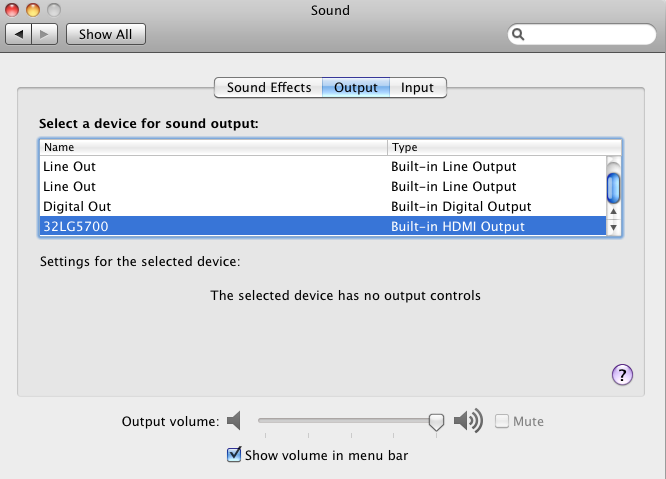

FKA Posted August 9, 2010 Share Posted August 9, 2010 What are you thinking? I'm thinking these guys using voodooHDA that have HDMI audio working haven't told us which port is carrying the audio I guess they have it on the HDMI and the mini display port?! as the Macpro 5770 only has 2 DP and 2 dvi My 5770 card didn't arrive today. will be tomorrow night before I can start messing around with it! Link to comment https://www.insanelymac.com/forum/topic/205802-ati-hd-5770/page/14/#findComment-1527413 Share on other sites More sharing options...

FKA Posted August 10, 2010 Share Posted August 10, 2010 EDIT - just installed my 5770. Works perfectly - using tmongkol's latest DSDT code for 3 monitors (many thanks.) and the latest Graphicsupdate package that atlee (many thanks too.) posted a few days ago. I have my LCD monitor to one DVI (nearest GPU MB) and LCD TV to the HDMI port. Both DVI ports work with HDMI but havent tried with all 3 monitors/eyefinity. Sleep is broken and I get a horizontal split in video when played, in mirror mode on my HDMI connected LCD TV. I had this problem with the gtx260 only the split was on my LCD monitor and I'm generally watching films on my TV! Video plays fine on both in split desktop. Need to try other framebuffers. HDMI audio works ! (I have onboard alc888T and am using tmongkol' AppleHDA 1.8.7f1 ALC888 LayoutID 888.) EFI_DSDT_10_08_10.dsl.zip GPU Model (HD-577A-ZNFA) D Link to comment https://www.insanelymac.com/forum/topic/205802-ati-hd-5770/page/14/#findComment-1528253 Share on other sites More sharing options...

_Jay_ Posted August 12, 2010 Share Posted August 12, 2010 HDMI does work already tested i dont need any adapters, but with eyefinity not sure Trust me VoodooHDA is the worst kext's you could use for your HD soundcards, You just cannot compare the quality between AppleHDA and VoodooHDA, AppleHDA {censored}es all over everything, I could work on a AppleHDA that picks both ALC888 and ATI HDMI R600 Audio or ALC889a and ATI HDMI but i'm just busy at the moment and hands full but i will work on it when have few weeks gap I just tried using the audio kexts you provided and I lost my audio. Not sure why but weird that only VoodooHDA works for me. Any comment? Jay Link to comment https://www.insanelymac.com/forum/topic/205802-ati-hd-5770/page/14/#findComment-1529336 Share on other sites More sharing options...
FKA Posted August 12, 2010 Share Posted August 12, 2010 I just tried using the audio kexts you provided and I lost my audio. Not sure why but weird that only VoodooHDA works for me. Any comment?Jay Do you have a working patched AppleHDA for your alc892 chipset? Link to comment https://www.insanelymac.com/forum/topic/205802-ati-hd-5770/page/14/#findComment-1529356 Share on other sites More sharing options...
_Jay_ Posted August 12, 2010 Share Posted August 12, 2010 Do you have a working patched AppleHDA for your alc892 chipset? No I don't, thought he had already patched the files for the 888 which is what I actually have, unless Gigabyte lied to me and so is System Profiler. Link to comment https://www.insanelymac.com/forum/topic/205802-ati-hd-5770/page/14/#findComment-1529372 Share on other sites More sharing options...
FKA Posted August 12, 2010 Share Posted August 12, 2010 No I don't, thought he had already patched the files for the 888 which is what I actually have, unless Gigabyte lied to me and so is System Profiler. Odd, i just looked your MB up on the Gigabyte site and it says alc892 in the manual? EDIT - rev1.0 of your board has alc888 but your sig' says you have rev2.0 which has alc892 ! Rev1.0 manual Rev2.0 manual D Link to comment https://www.insanelymac.com/forum/topic/205802-ati-hd-5770/page/14/#findComment-1529382 Share on other sites More sharing options...
_Jay_ Posted August 12, 2010 Share Posted August 12, 2010 Then something is extremely mixed up because on the site itself for the rev. 2.0 it says ALC888 but in the manual it says ALC892. My hardware on both mac and windows(astra32) says ALC888. On my motherboard the print says rev. 2.0 Jay Link to comment https://www.insanelymac.com/forum/topic/205802-ati-hd-5770/page/14/#findComment-1529578 Share on other sites More sharing options...
FKA Posted August 13, 2010 Share Posted August 13, 2010 Then something is extremely mixed up because on the site itself for the rev. 2.0 it says ALC888 but in the manual it says ALC892. My hardware on both mac and windows(astra32) says ALC888. On my motherboard the print says rev. 2.0 Jay that's irritating! but you must have alc888 then?! what AppleHDA have you tried? I use tmongkols 888 for 10.6.4 (linked a few posts back.) with this in DSDT: Device (HDEF) { Name (_ADR, 0x001B0000) Method (_DSM, 4, NotSerialized) { Store (Package (0x04) { "layout-id", Buffer (0x04) { 0x78, 0x03, 0x00, 0x00 }, "PinConfigurations", Buffer (Zero) {} }, Local0) DTGP (Arg0, Arg1, Arg2, Arg3, RefOf (Local0)) Return (Local0) } } D Link to comment https://www.insanelymac.com/forum/topic/205802-ati-hd-5770/page/14/#findComment-1529624 Share on other sites More sharing options...
