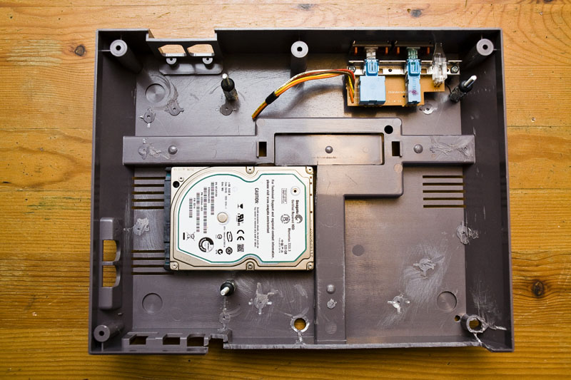

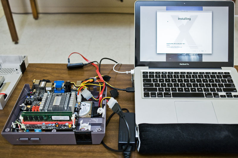

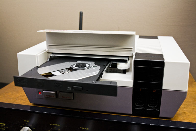

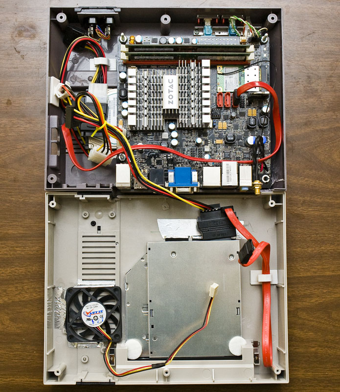

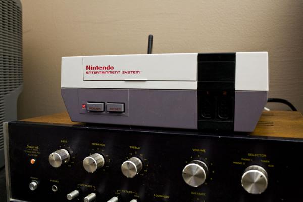

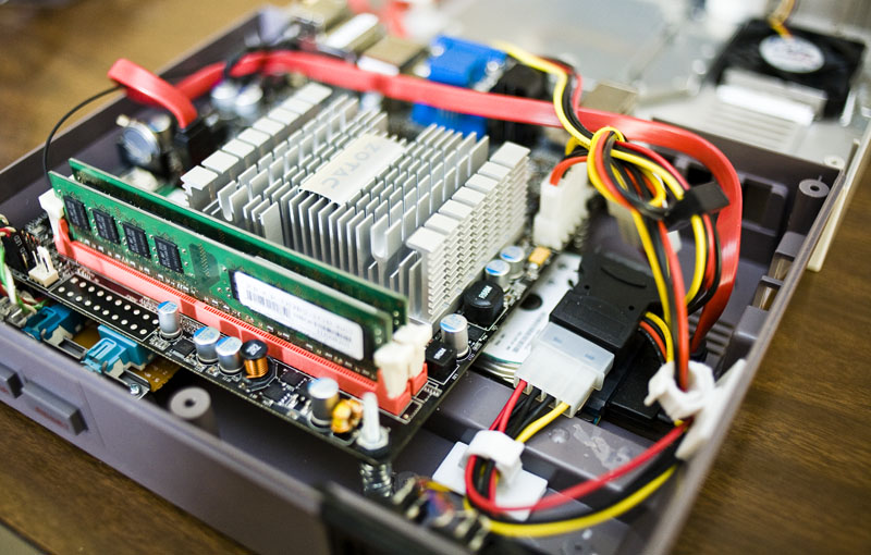

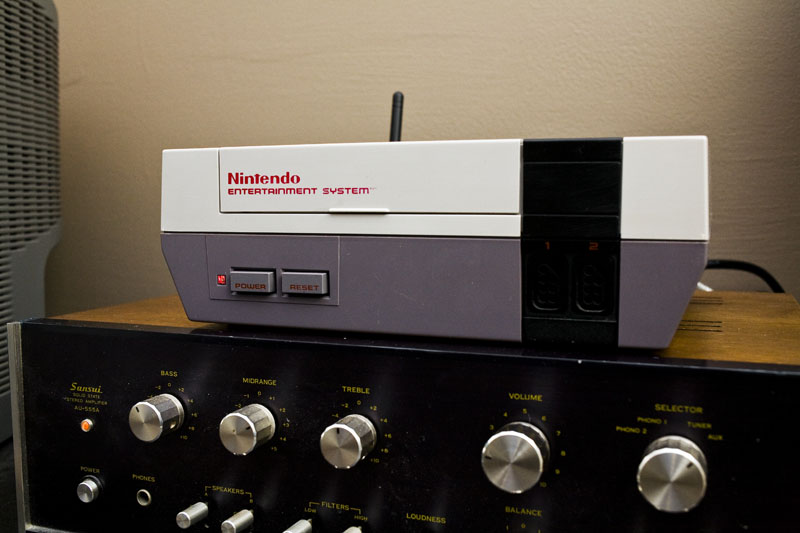

Will514 Posted December 22, 2009 Share Posted December 22, 2009 i've had this idea of putting together a media center for my TV for months. I was inspired by a tutorial on Instructables (http://www.instructables.com/id/Build-a-Nintendo-NES-PC/) about building a NES PC. Here are my pictures of the rig with the Zotac Ion running 10.6.2. thanks to eugene2k. Link to comment https://www.insanelymac.com/forum/topic/197516-full-solution-for-zotac-ionitx-atom-330-for-106x-sl/page/2/#findComment-1365999 Share on other sites More sharing options...

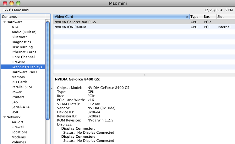

liupingguo Posted December 23, 2009 Share Posted December 23, 2009 Great news! based on a thread of dual nVidia card (PCI and PCI-E) that I read before, I successfully add a Nvidia 8400GS PCI-E card to my Zotac ion-F-E, featuring Atom 330+9400M+PCI Express x16. what a waste if PCI-E is empty while we already paid for it and the power supply as well! Remember, Macbook Pro has the 9400M (PCI)+9600GT(PCI-E), we really should go insane! Ordered Zotac 8400GS 512m low profile (no preference, just want to match Zotac brand) from newegg, since my Antec Skeleton mini-90 gives only 90w power, can not really afford 8500 or above. people said 8400GS takes only 25w power even fully loaded, well that's the perfect thing for upgrade. Benefit: Ion supports Phyx, with 8400GS and up, for my case, Phyx is enabled under Windows 7, but I didn't see much improvement, if any....some ripped 1080P movies are still unwatchable, I'm so confused by the control pannel, says enable Phyx processing to 8400GS or ION, is it a add on or a enabling? Whatever, I test both in the score system gave me the same result 3.5 and 5.4 for graphics... In SL, I added EFI string to the boot.plst, no luck, God knows why. Installed the NVdarwin, choose 8400GS 512M, and voila! Be sure in Bois, you need to choose internal GPU, not PCI-E, and your monitors must be connected to onboard ones. turns out the DVI and HDMI can be used as dual extended screen, cool. The overall graphic performance...ummmm, almost the same as it is under Windows 7, but slightly better. If some of you can give it a try, share your result! Link to comment https://www.insanelymac.com/forum/topic/197516-full-solution-for-zotac-ionitx-atom-330-for-106x-sl/page/2/#findComment-1367589 Share on other sites More sharing options...
