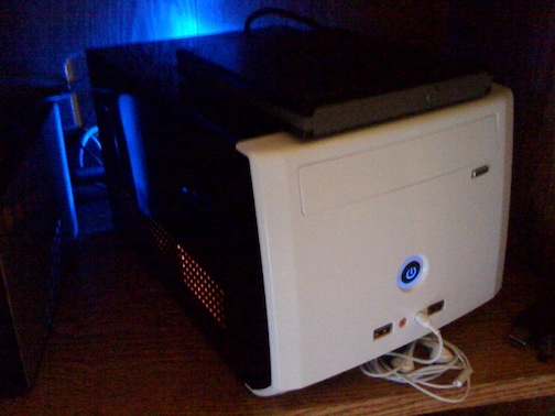

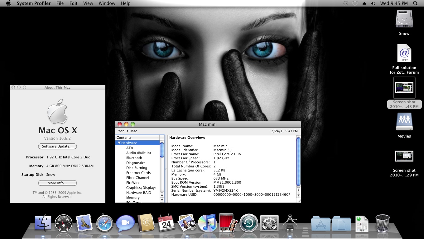

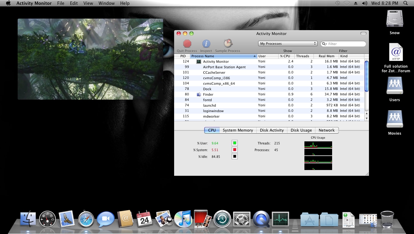

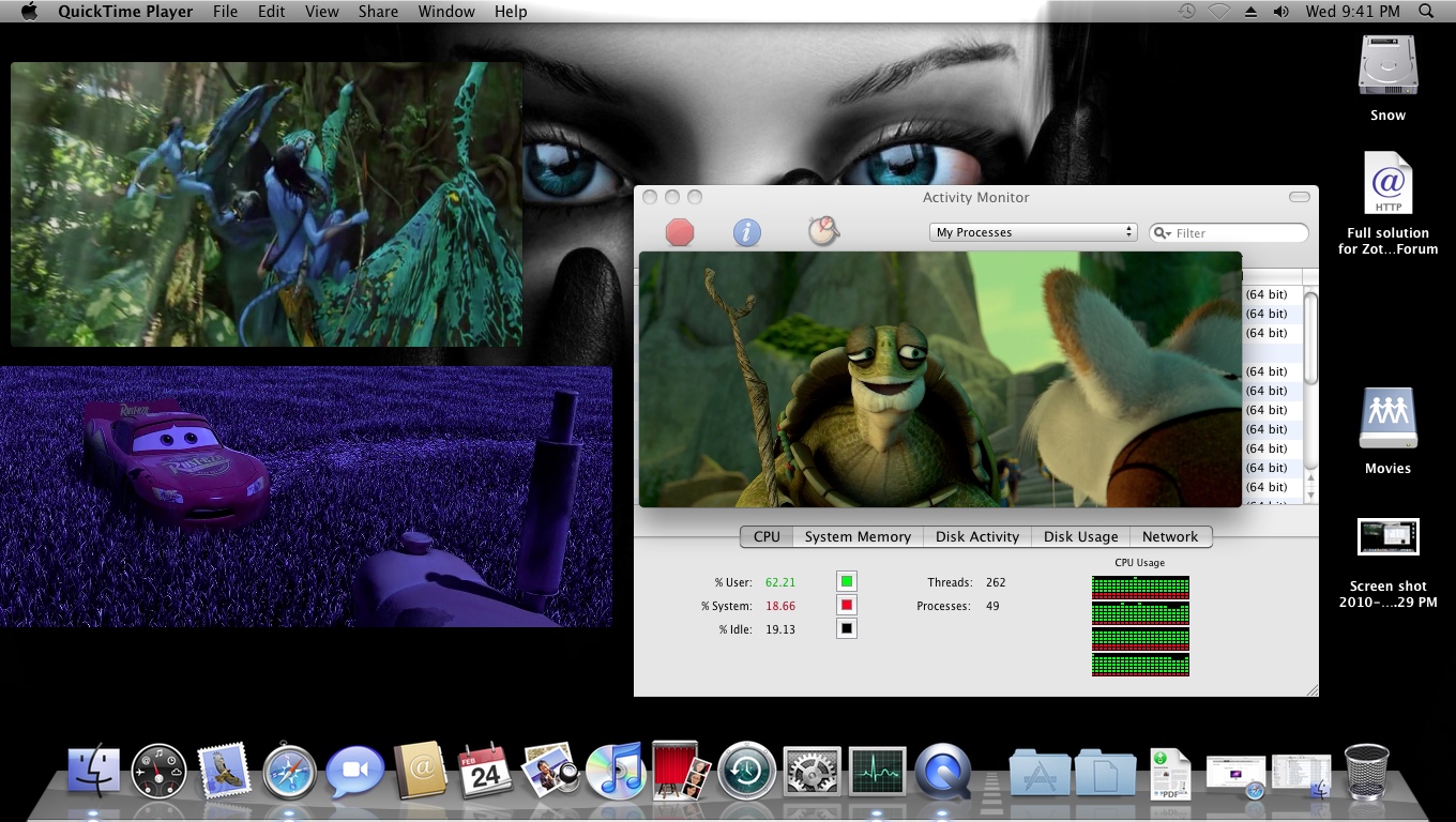

Yoni Yoni Posted February 25, 2010 Share Posted February 25, 2010 THANK YOU! This is by far the greatest hackintosh I have ever built. I say so because I was looking for a solution (replacement for my Media Center PC) and the Zotac IONITX-F-E was the perfect and greatest solution that I have found so far after long Google search nights and study. Running a Shuttle K45 hackintosh won't cut it. I couldn't get that machine to play my Blu-Ray rips at a decent resolution (1920 x 1080) because of the old GMA950 so it was not an option to have it hook up into my TV. The other issue was the VGA output. I needed DVI or HDMI. Anyway, I decided to test this IONITX-F-E out and not expecting any less everything worked right out of the box for me!!!! I can play 3 Bbrips at the same time without lags, I can put the machine to Sleep, Wireless works as expected. I can finally authenticate to my Radius server (WPA2-Enterprise) and the list goes on and on... For references I'm going to take the time to explain everything I did, hardware specs and where to buy it. Good luck everyone! There is no way you could go wrong with this build as a media center hackintosh. Have fun! Hardware All from NewEgg: Motherboard: ZOTAC IONITX-F-E Memory RAM: G.SKILL 2 x 2GB DDR2 800 Case: Rosewill RC-CIX-01 WI Hard Drive: WD Green 500GB 32MB Cache SATA 3.0Gb/s DVD Drive Total Price: $384.94 Installation I used an external enclosure (USB) to install Snow Leopard in the Hard Drive purchased from Newegg. NOTE: You need a Mac to do this or another machine running Snow Leopard. Install OS X Snow Leopard from a retail DVD. Boot into your new installation and upgrade to 10.6.2 Replace Kernel with the patched one for your Atom in / (root) Install Chameleon 2.0-RC2-r640 (Yeah I used it myself and it is good Replace boot in / (root) Replace everything in the /Extra folder with the files (VERSION 2) from the first post in this topic. Now move the hard drive into your hackintosh, boot up and have fun! I was able to overclock the Atom 330 to 1.9GHz stable. Bumping up the FSB to 667MHz will leave the machine very unstable. Maybe playing with voltage a bit more with some time will actually allow me to hit the 2GHz... I do have the fan that came with the motherboard installed on top of the CPU and Chipset heatsink. The build is so quiet that you can't hear it running with your ear next to the box (even when the case has no cover!) That's how quiet it is! This is what it looks like... It is so nice with the Apple wireless keyboard and mouse! You need a USB bluetooth dongle to be able to use the Magic Mouse and the wireless Keyboard. And this is a QuickTime recording of the machine... http://www.youtube.com/watch?v=L3Em82aiclI Link to comment https://www.insanelymac.com/forum/topic/197516-full-solution-for-zotac-ionitx-atom-330-for-106x-sl/page/4/#findComment-1417277 Share on other sites More sharing options...

Yoni Yoni Posted February 26, 2010 Share Posted February 26, 2010 Multimonitor on Zotac ITX-A Perhaps it helps somebody. I tried multimonitor connection on ITX-A. Following combinations are working. VGA - HDMI DVI -HDMI VGA -DVI with HDMI/DVI Adapter If you connect VGA and DVI both screens went black. I believe you need to have the Mirror Displays option set to OFF in Display settings because it won't work. I have 2 monitors connected HDMI and DVI to HDMI and it works as you mentioned... Yoni Link to comment https://www.insanelymac.com/forum/topic/197516-full-solution-for-zotac-ionitx-atom-330-for-106x-sl/page/4/#findComment-1418797 Share on other sites More sharing options...
igyo Posted February 27, 2010 Share Posted February 27, 2010 Yoni Yoni, good video!!! Link to comment https://www.insanelymac.com/forum/topic/197516-full-solution-for-zotac-ionitx-atom-330-for-106x-sl/page/4/#findComment-1418909 Share on other sites More sharing options...
Yoni Yoni Posted February 27, 2010 Share Posted February 27, 2010 Yoni Yoni, good video!!! At least it gives you an idea of what to expect. By the way, it runs photoshp just fine. I don't expect to do heavy photoshop on it cos' it is obviously not an option for the Atom 330 but again, it is not what I was looking for. As a Media center machine is great! Love it Link to comment https://www.insanelymac.com/forum/topic/197516-full-solution-for-zotac-ionitx-atom-330-for-106x-sl/page/4/#findComment-1419161 Share on other sites More sharing options...
