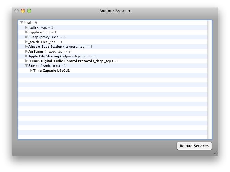

LocusOfControl Posted January 11, 2010 Share Posted January 11, 2010 Oh just a little spend then!... blimey, that's a serious bit of kit. So just to clarify, your Gigabit network & bonjour works without any additional kexts or fixes using that beast of a card, not the onboard? Yes everything working - bit nervous installing since it is a PCI-E x4 card but it needs to go into a x16 slot Also it seems fussy about cables, I had to change out what was a previously working cable I only have FakeSMC plus the hacked RC4 boot file, using SATA fix & Shutdown/Restart/UUID fixes in boot/dsdt Turned off the onboard NIC's and deleted the Realtek kext Jan 11 16:26:24 LocusOfControl kernel[0]: DSMOS has arrived Jan 11 16:26:24 LocusOfControl kernel[0]: Intel82574L: Ethernet address 00:xx:xx:xx:xx:xx Jan 11 16:26:24 LocusOfControl kernel[0]: Intel82574L: Ethernet address 00:xx:xx:xx:xx:xx Jan 11 16:26:24 LocusOfControl kernel[0]: ** Device in slot: SLOT-3 ** Here is bonjour browser - but note I never had to configure bonjour before, always worked for me, no promiscuity going on in my hack en0: flags=8863<UP,BROADCAST,SMART,RUNNING,SIMPLEX,MULTICAST> mtu 1500 en1: flags=8863<UP,BROADCAST,SMART,RUNNING,SIMPLEX,MULTICAST> mtu 1500 Link to comment https://www.insanelymac.com/forum/topic/192518-dsdt-fixes-for-gigabyte-boards/page/61/#findComment-1382592 Share on other sites More sharing options...
LocusOfControl Posted January 11, 2010 Share Posted January 11, 2010 Yes everything working - bit nervous installing since it is a PCI-E x4 card but it needs to go into a x16 slotAlso it seems fussy about cables, I had to change out what was a previously working cable I only have FakeSMC plus the hacked RC4 boot file, using SATA fix & Shutdown/Restart/UUID fixes in boot/dsdt Turned off the onboard NIC's and deleted the Realtek kext Jan 11 16:26:24 LocusOfControl kernel[0]: DSMOS has arrived Jan 11 16:26:24 LocusOfControl kernel[0]: Intel82574L: Ethernet address 00:xx:xx:xx:xx:xx Jan 11 16:26:24 LocusOfControl kernel[0]: Intel82574L: Ethernet address 00:xx:xx:xx:xx:xx Jan 11 16:26:24 LocusOfControl kernel[0]: ** Device in slot: SLOT-3 ** Here is bonjour browser - but note I never had to configure bonjour before, always worked for me, no promiscuity going on in my hack en0: flags=8863<UP,BROADCAST,SMART,RUNNING,SIMPLEX,MULTICAST> mtu 1500 en1: flags=8863<UP,BROADCAST,SMART,RUNNING,SIMPLEX,MULTICAST> mtu 1500 Should just add, my energy saving prefs automatically updated Link to comment https://www.insanelymac.com/forum/topic/192518-dsdt-fixes-for-gigabyte-boards/page/61/#findComment-1382627 Share on other sites More sharing options...

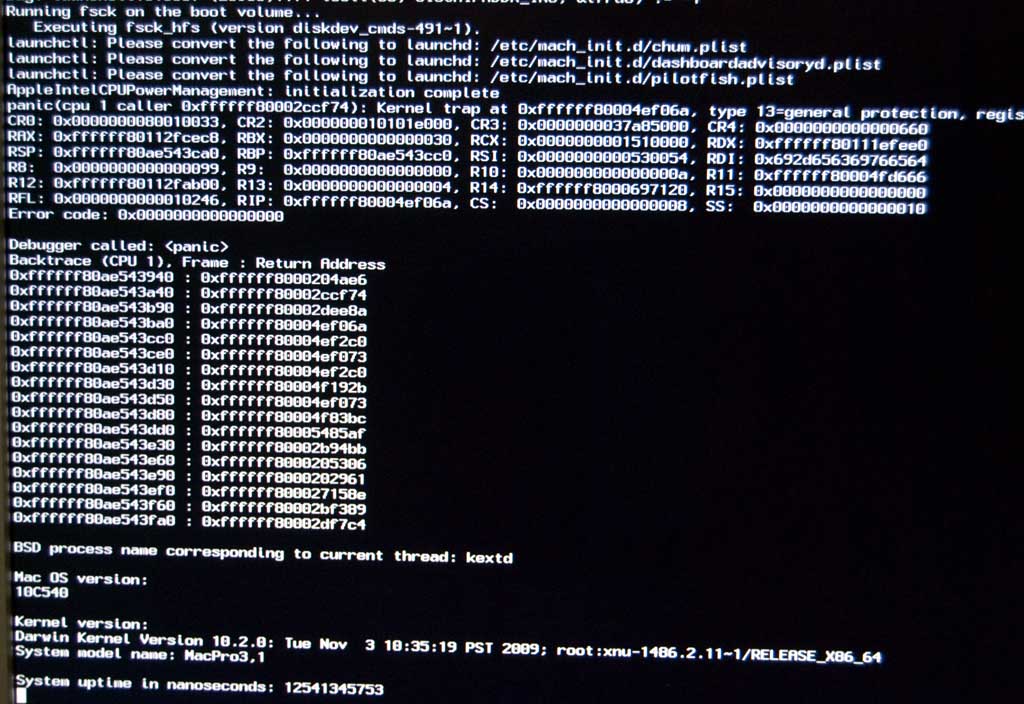

xjasx Posted January 11, 2010 Share Posted January 11, 2010 OK I tried out the "Quick Boot" feature in BIOS and I get a "Unable to fins SMBIOS table" in the bootloader check during boot. Then during startup I get all sorts of UUID errors. I'm currently using Asere's Bootloader. When it boots I can't get any profile information in the "About this mac" of system profiler. Anyone have any ideas? I get the exact same thing with "Quick Boot" enabled Firewire GUID errors, and "Unable to find SMBIOS table", also crashes to login window when clicking "About this Mac" It makes an entry in pmlog * Domain: wake - Message: Wake: Loginwindow Authorization Failure - AC - Time: 1/11/10 8:26:23 AM PST - Signature: Loginwindow Authorization Failure - Result: Failure Link to comment https://www.insanelymac.com/forum/topic/192518-dsdt-fixes-for-gigabyte-boards/page/61/#findComment-1382634 Share on other sites More sharing options...

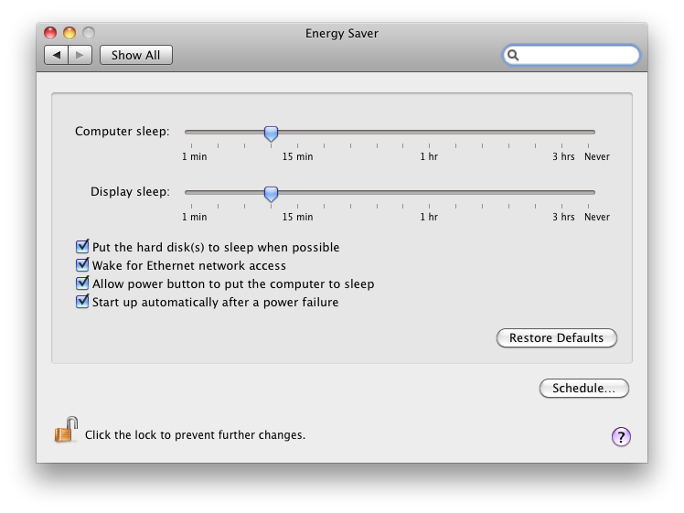

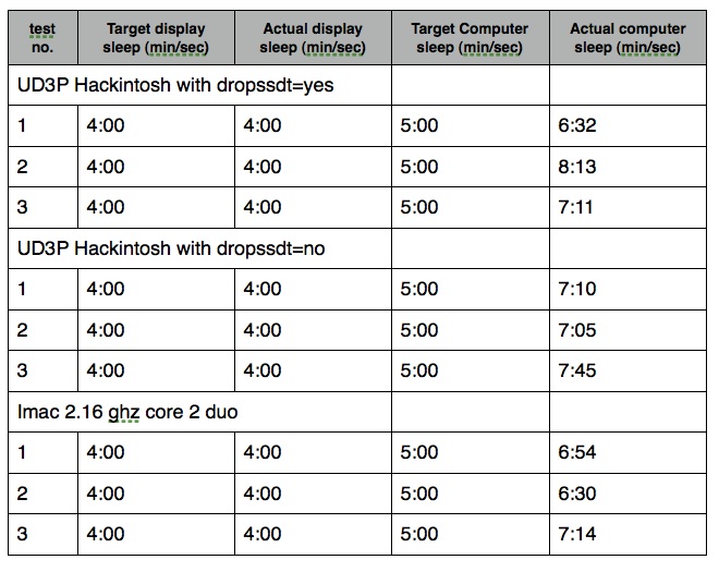

keeza Posted January 11, 2010 Share Posted January 11, 2010 Not sure what to make of this (if anything) Ran a small experiment with auto sleep. I was concerned about the random nature of timed sleep. Set display to sleep at 4 mins. Set computer sleep at 5 mins. Ran test three times, with dropssdt=yes and dropssdt=no Also ran same test on my imac. here are the results It seems that the dropssdt=no results are closer to the imac results in terms of being within a 45 second interval. wondering if anyone could verify my findings by running the same test. For my test I disconnected all external peripherals and closed all programs so that they don't interfere with sleep. Link to comment https://www.insanelymac.com/forum/topic/192518-dsdt-fixes-for-gigabyte-boards/page/61/#findComment-1382713 Share on other sites More sharing options...
xjasx Posted January 11, 2010 Share Posted January 11, 2010 I still can't get auto-sleep going on my hack ;[ using pretty much the same dsdt for EP45-UD3P... tried with disconnected peripherals and still no-go, atleast with the dvd-drive plugged in it makes a sound as if it's about to go to sleep at around the time it should be going to sleep (~1:30mins after set time in prefs)... so the timer is working o.O Tried with both dropssdt=y and without Link to comment https://www.insanelymac.com/forum/topic/192518-dsdt-fixes-for-gigabyte-boards/page/61/#findComment-1382742 Share on other sites More sharing options...

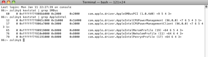

xjasx Posted January 11, 2010 Share Posted January 11, 2010 I removed name and bus. This time, I don't have a kernel panic.What do you think, everything is ok? (please check the attached image). you're still missing something, my output gives: jas-osx86:~ jas$ kextstat | grep SMBus 58 0 0xffffff7f8091d000 0x2000 0x2000 com.apple.driver.AppleSMBusPCI (1.0.4d0) <9 5 4 3> 75 1 0xffffff7f81224000 0x2000 0x2000 com.apple.iokit.IOSMBusFamily (1.1) <5 4 3> 76 0 0xffffff7f81226000 0xb000 0xb000 com.apple.driver.AppleSMBusController (1.0.4d0) <75 9 8 5 4 3> jas-osx86:~ jas$ kextstat | grep AppleIntel 12 0 0xffffff7f8065f000 0x1b000 0x1b000 com.apple.driver.AppleIntelCPUPowerManagement (96.0.0) <7 6 5 4 3 1> 27 0 0xffffff7f8071a000 0x3000 0x3000 com.apple.driver.AppleIntelCPUPowerManagementClient (96.0.0) <7 6 5 4 3 1> 63 0 0xffffff7f8097b000 0x8000 0x8000 com.apple.driver.AppleIntelMeromProfile (19) <62 6 5 4 3> You should try the grep AppleIntel again, and it should only show one... it starts with 3 CPU profiles for me at boot aswell, and then it settles for Merom You might be missing this in device SBUS: Device (DVL0) { Name (_ADR, 0x57) Name (_CID, "diagsvault") } Link to comment https://www.insanelymac.com/forum/topic/192518-dsdt-fixes-for-gigabyte-boards/page/61/#findComment-1382753 Share on other sites More sharing options...
leslieking Posted January 11, 2010 Share Posted January 11, 2010 Adding Device (DVL0) cause a kernel panic: Device (SBUS) //<-- Renamed from PX43 { Name (_ADR, 0x001F0003) Method (_DSM, 4, NotSerialized) { Store (Package (0x04){ "name", "pci8086,3a30", "device-id", Buffer (0x04){0x30, 0x3A, 0x00, 0x00} }, Local0) DTGP (Arg0, Arg1, Arg2, Arg3, RefOf (Local0)) Return (Local0) } Device (DVL0) { Name (_ADR, 0x57) Name (_CID, "diagsvault") } } dsdt.dsl.zip Link to comment https://www.insanelymac.com/forum/topic/192518-dsdt-fixes-for-gigabyte-boards/page/61/#findComment-1382768 Share on other sites More sharing options...

xjasx Posted January 11, 2010 Share Posted January 11, 2010 Maybe try something like: Device (SBUS) { Name (_ADR, 0x001F0003) Method (_DSM, 4, NotSerialized) { Store (Package (0x04){ "name", "pci8086,3a30", "device-id", Buffer (0x04){0x30, 0x3A, 0x00, 0x00} }, Local0) DTGP (Arg0, Arg1, Arg2, Arg3, RefOf (Local0)) Return (Local0) } Device (BUS0) { Name (_CID, "smbus") Name (_ADR, Zero) Device (DVL0) { Name (_ADR, 0x57) Name (_CID, "diagsvault") } } } Link to comment https://www.insanelymac.com/forum/topic/192518-dsdt-fixes-for-gigabyte-boards/page/61/#findComment-1382798 Share on other sites More sharing options...
leslieking Posted January 11, 2010 Share Posted January 11, 2010 Thanks, mate! I already tried your method, here: http://www.insanelymac.com/forum/index.php...t&p=1382287 As far as I know, with SMBus enabled I don't need to see such messages: FakeSMC: key info not found Th0H, length - 6 FakeSMC: key info not found Tp0C, length - 6 I would be grateful for any other help! Thanks! Link to comment https://www.insanelymac.com/forum/topic/192518-dsdt-fixes-for-gigabyte-boards/page/61/#findComment-1382803 Share on other sites More sharing options...
xjasx Posted January 11, 2010 Share Posted January 11, 2010 Weird, minus the device-id injection bit, that's exactly what I'm using, and it works great The FakeSMC messages can be turned off in the Info.plist of the FakeSMC.kext, just change the debug key to false: <key>debug</key> <false/> Link to comment https://www.insanelymac.com/forum/topic/192518-dsdt-fixes-for-gigabyte-boards/page/61/#findComment-1382855 Share on other sites More sharing options...
