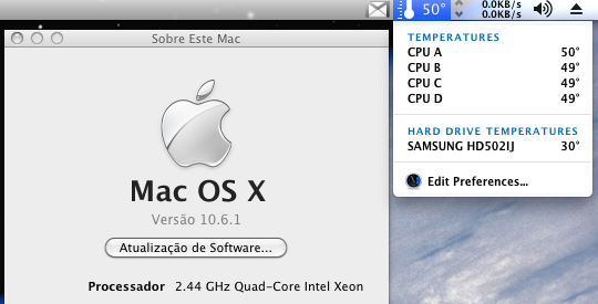

Hi,
Checked the latest edit to your fakesmc.kext. Indeed shows 4 CPU temp values in istat menus. Left Tjmax @ 100 (default), which values seem correct with Q9550 CPU.
But friend, those messages about smckeys are still there in the log. All else seems to work okay.
Thank you.

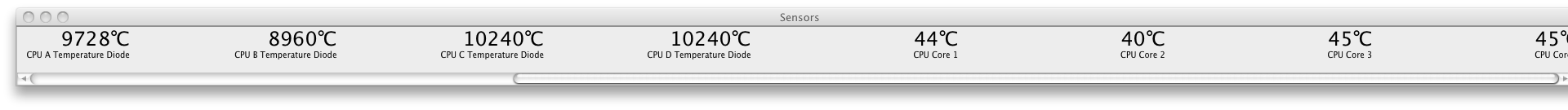

Temperature monitor still shows 9000 degrees for diode A with this one. Anyone care to confirm?
I confirm it, but if you change the kext to work with Temperature Monitor, iStat won't work anymore.
Temperature Monitor reads the same 2 bytes TC0D key, but big-endian, while iStat uses little-endian.
For example:
TC0D =
iStat reads: 0x0031 = 49
Temperature Monitor reads 0x3100 = 12544

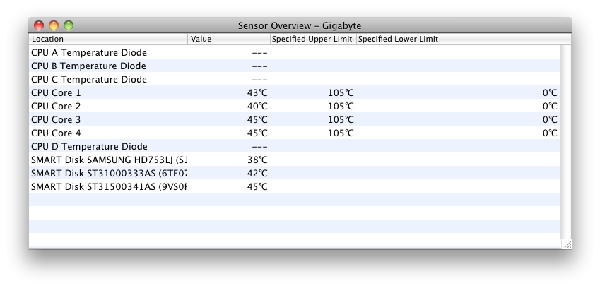

I get these kind of readings, Temperature monitor application works, but all sensors show +5 degrees compared to VoodooMonitor or iStat.
Maybe Temperature Monitor calculates a different Tjmax value for your CPU?
Here it shows the same values as iStat and VoodooMonitor (except for diode temps which are 10000º+ as mentioned).
In Temperature Monitor preferences, under sensor tab, you can select "don't acquire readings from this sensor" for the ones showing wrong values.
Seems to be defined to 105 for some reason.

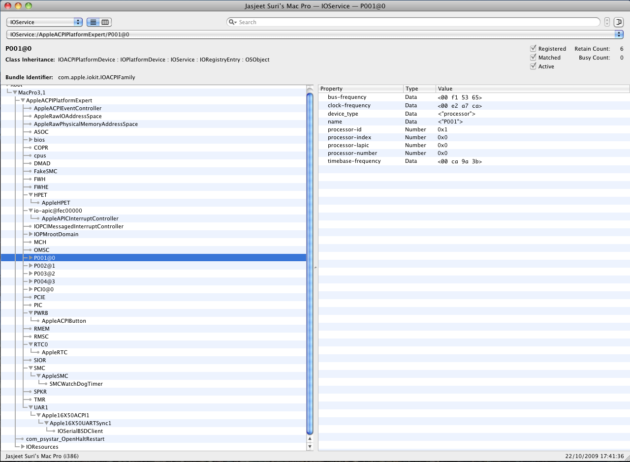

I tried it, but im just getting Sensor A and B for my Quad Core Q6600 in iStat, Temp monitor reprts A B C D but as youve explained the wrong temp 8000+
Using CPU injector for Snow to recognize Q6600 Xeon
Strange thing, just tested with CPU injector and it still shows 4 cores, did you test without it to see if it's the problem?
Do you see 4 CPUs in IORegistryExplorer?
Edit: did you check iStat preferences? Maybe other cores are unchecked. If Temperature Monitor shows the other cores, the keys must be there (even it showing wrong values).
i see this:
please test with this kext
fakesmc.kext.zip
then check your kernel.log for which keys were added
grep added /var/log/kernel.log

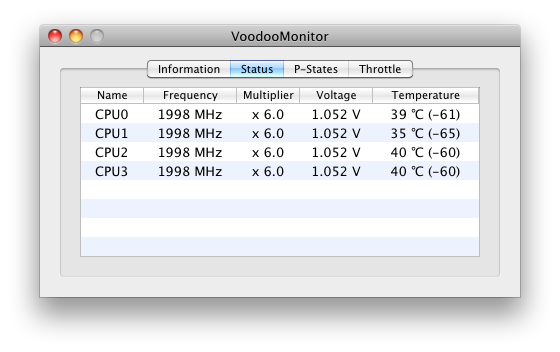

I've updated latest version to use with markswell's utulities. Now it works well in snowleo and shows correctly all cores.
fakesmc.kext.zip
fakesmc.src.zip
Thank you Mojodojo.
I see you use cpuid_count_cores() from cpuid.h, the previous method didn't work for you in SnowLeo? Should we increase MaxCpuCount then?
BTW, are you the author of VoodooMonitor (CPU-i)? I got the code to count cores from CPU-i 1.03 source.
Are markswell's utilities open source? It would be nice to add mobo temp and fan speeds to fakesmc, I see it supports some more chips now.
Regards.
Thank you Mojodojo.
Regards.
Yes, I made cpu-i.
You must ask a question about license and mark-i sources to mark. Cpuid utilities from voodoomonitor is different from mark-i project.
It would be great if fakesmc will receive mark-i functionality.
