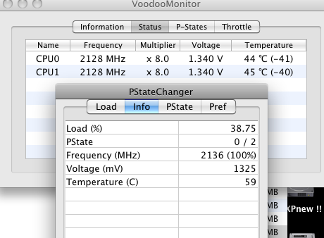

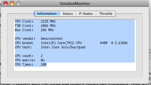

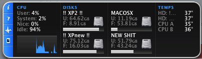

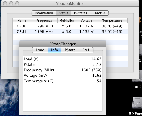

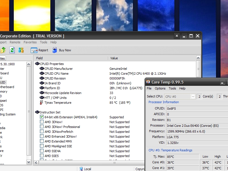

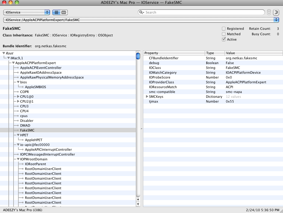

atom069 Posted February 25, 2010 Share Posted February 25, 2010 Hello all, very new to OSX at all so please bear with me This is just the thread I was looking for. I have installed osx86 from the 10.6.1-10.6.2 hazard disc, with not much problem really. Took a few shots to get the right kext, but everything appears to be working. I have the E6400 which has a TJ max of 85C unlike most of the 100C chips here. Voodoomonitor (hardware monitor 4.85 gives error on start, will test previous) reads my chip still at 100C. I can manually set the TJ max in my fakesmc.kext info.plist to 85, which seems to show the same temps I get in windows. (check pics please) Is changing the fakesmc value to 85 just cosmetic or is it really changing the OS settings to read it at 85. When I manually set voodoomonitor CPU-I max override to 85C and get the same readings as istat. I have voodoopstatev4 and voodooo monitor installed, and my correct states are shown for this proc (3 states 1.6-2.13ghz) nothing seems hot at all, my fans run the same as in windows. When the TJ max on the fakesmc was set to 100, it was reading 55C temps in istat, but after change to 85C for TJ max is appears to read 36-39 which is what I get in windows like stated. You can see the default TJ max for voodoo monitor is also 100. Is that cosemtic? Very sorry for the long post but im new to this. Core 2 duo E6400 MSI P6N SLI Platinum MS-7350 4GB DDR800 ASUS 9800GT 512MB ALC888 HD Thanks guys, Ive been reading the forums for about 5 days now since I decided to install this again. EDIT> I wanted to say that even if I still open up voodoomonitor, it still reads 100C for TJMAX, is that just the programs default or is that still saying that i'm still at 100C TJ MAX? @Jbolted - Same here man hah ive been trying to figure out how to change my CPU TJ max for the OS because mine is different at 85C not 100C like most it appears. OSX is a lot of fun, I like opensuse as well. Link to comment https://www.insanelymac.com/forum/topic/192517-cpu-temperature-in-istat/page/6/#findComment-1417222 Share on other sites More sharing options...
oldnapalm Posted February 25, 2010 Author Share Posted February 25, 2010 When the TJ max on the fakesmc was set to 100, it was reading 55C temps in istat, but after change to 85C for TJ max is appears to read 36-39 which is what I get in windows like stated. You can see the default TJ max for voodoo monitor is also 100. Is that cosemtic? Yes, it's cosmetic. Actually the value read from CPU is the distance to Tjmax, and FakeSMC outputs Tjmax minus that value, so temp will only be correct if you set correct Tjmax. I wanted to say that even if I still open up voodoomonitor, it still reads 100C for TJMAX, is that just the programs default or is that still saying that i'm still at 100C TJ MAX? You can configure Tjmax in VoodooMonitor preferences. Link to comment https://www.insanelymac.com/forum/topic/192517-cpu-temperature-in-istat/page/6/#findComment-1417253 Share on other sites More sharing options...
atom069 Posted February 25, 2010 Share Posted February 25, 2010 Oh ok, I kinda figured that about the fakesmc that it was purely cosmetic on that aspect. Thank you very much sir. There is no actual way to edit and change the TJ MAX of the OS? This seems to be my only problem. Like stated I changed the voodoomonitor CPU-I TJMAX override to 85C, but When I start up p-change changer while voodoomonitor is open I guess its still on 100 TJ MAX because that still says 50C-55C. So im guessing the voodoomonitor override either doesn't work or is showing false values I have not setup speed stepped at all in the DSDT vanilla speed, but when im guessing the voodoopstatev4 did something because im using dual display video right now and a couple other programs and im watching the voodoomonitor ONLY while pstatechanger is one the states changes from 6.0 (1.59ghz) - 8.0 (2.13ghz) under load. I was just want to change the OS TJ MAX to the correct 85C so it lowers the temp. OSX86 CPU TJ MAX seems to be 100C or am I missing something? Sorry for my ignorance im very new! Link to comment https://www.insanelymac.com/forum/topic/192517-cpu-temperature-in-istat/page/6/#findComment-1417302 Share on other sites More sharing options...
