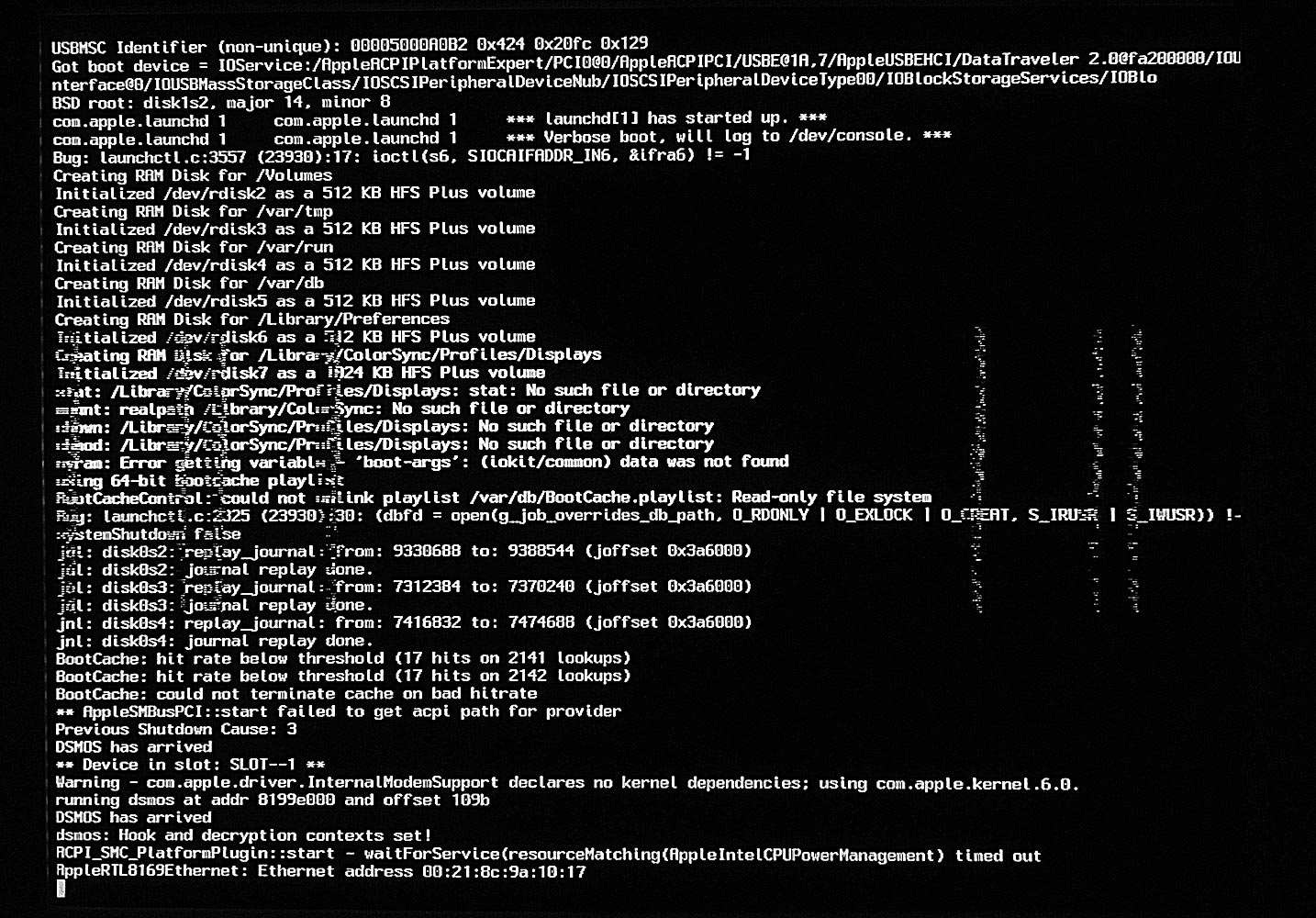

tweak41 Posted December 8, 2009 Author Share Posted December 8, 2009 Do you know if you've got Disabler.kext in there? A screenshot would really help, because the problem isn't necessarily AppleIntelCPUPowerManagement kext, but could be. Link to comment https://www.insanelymac.com/forum/topic/189052-asus-p6t-se-retail-snow-leopard-installation-guide-flashdrive-updated-jun-28/page/11/#findComment-1353686 Share on other sites More sharing options...

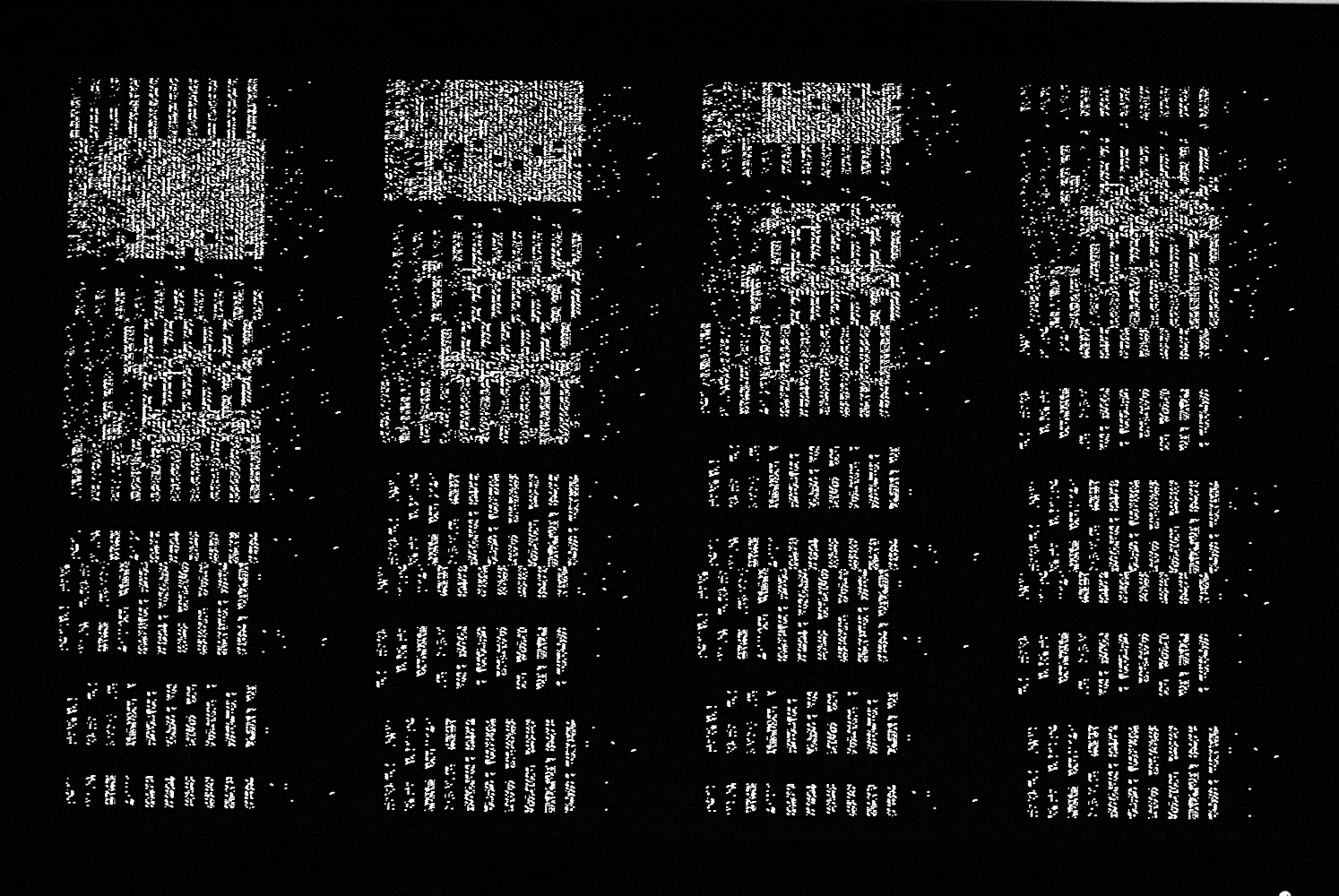

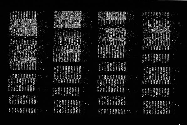

Big_T Posted December 8, 2009 Share Posted December 8, 2009 Do you know if you've got Disabler.kext in there? A screenshot would really help, because the problem isn't necessarily AppleIntelCPUPowerManagement kext, but could be. Hi Tweak, Here are the screen shots of my primary screen and the other secondary screen that sort of disintegrates (in a new wave artistic kind of style) T Link to comment https://www.insanelymac.com/forum/topic/189052-asus-p6t-se-retail-snow-leopard-installation-guide-flashdrive-updated-jun-28/page/11/#findComment-1354345 Share on other sites More sharing options...
akhenamenra Posted December 9, 2009 Share Posted December 9, 2009 Hi Tweak, Here are the screen shots of my primary screen and the other secondary screen that sort of disintegrates (in a new wave artistic kind of style) T looks like a disabler kext issue i think (could be wrong) but im sure that the apple cpumanagement needs to be disabled with disabler ( in extensions get a copy of mac drive and you can do this your self via windows instead of rebooting all again) ...i could be wrong tho Link to comment https://www.insanelymac.com/forum/topic/189052-asus-p6t-se-retail-snow-leopard-installation-guide-flashdrive-updated-jun-28/page/11/#findComment-1354509 Share on other sites More sharing options...
tweak41 Posted December 9, 2009 Author Share Posted December 9, 2009 Big_T, What video card do you have? Link to comment https://www.insanelymac.com/forum/topic/189052-asus-p6t-se-retail-snow-leopard-installation-guide-flashdrive-updated-jun-28/page/11/#findComment-1354589 Share on other sites More sharing options...

Big_T Posted December 9, 2009 Share Posted December 9, 2009 Big_T, What video card do you have? Its an Asus EAH 4580 1 gig video Card. http://usa.asus.com/product.aspx?P_ID=uhwarwIzFUpVVGdI T Link to comment https://www.insanelymac.com/forum/topic/189052-asus-p6t-se-retail-snow-leopard-installation-guide-flashdrive-updated-jun-28/page/11/#findComment-1354726 Share on other sites More sharing options...
tweak41 Posted December 9, 2009 Author Share Posted December 9, 2009 Big_T Your graphics card is the problem. Support has just been updated in 10.6.2... http://netkas.org/?p=284 Not sure what to tell you. If you can find a DVD that is 10.6.2 instead of 10.6 you can install it, otherwise maybe you'll have to make some changes to your files on the flash drive before it will install (i.e. the added kexts for your graphics card). And don't forget to use the files netkas mentions! Good luck. EDIT: Direct link to the drivers you need: http://is.gd/4y27Q Link to comment https://www.insanelymac.com/forum/topic/189052-asus-p6t-se-retail-snow-leopard-installation-guide-flashdrive-updated-jun-28/page/11/#findComment-1354741 Share on other sites More sharing options...
akhenamenra Posted December 9, 2009 Share Posted December 9, 2009 Big_T Your graphics card is the problem. Support has just been updated in 10.6.2... http://netkas.org/?p=284 Not sure what to tell you. If you can find a DVD that is 10.6.2 instead of 10.6 you can install it, otherwise maybe you'll have to make some changes to your files on the flash drive before it will install (i.e. the added kexts for your graphics card). And don't forget to use the files netkas mentions! Good luck. EDIT: Direct link to the drivers you need: http://is.gd/4y27Q dang just when i thought i had it figured ...i was thinking video card due to the wavy lines on the screen but assumed disabler caus of where it choked Link to comment https://www.insanelymac.com/forum/topic/189052-asus-p6t-se-retail-snow-leopard-installation-guide-flashdrive-updated-jun-28/page/11/#findComment-1355001 Share on other sites More sharing options...
tweak41 Posted December 10, 2009 Author Share Posted December 10, 2009 dang just when i thought i had it figured ...i was thinking video card due to the wavy lines on the screen but assumed disabler caus of where it choked Because it stops booting at a certain line doesn't necessarily mean that's the cause. If you see a kernel panic then it's pretty obvious, but sometimes you'll find the real reason hidden halfway down the page and not realize it. However, I think the messed up graphics were a pretty good indicator that it was something related to the graphics hardware, and sure enough he was using a card that is in beta stages in terms of support (as evident from the link to netkas' site). Link to comment https://www.insanelymac.com/forum/topic/189052-asus-p6t-se-retail-snow-leopard-installation-guide-flashdrive-updated-jun-28/page/11/#findComment-1355448 Share on other sites More sharing options...
