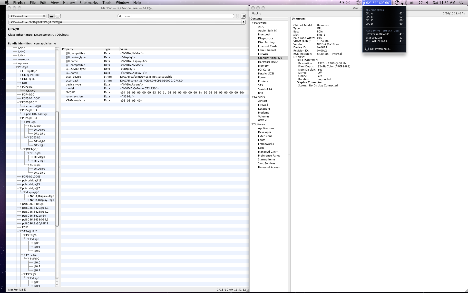

Not important but was wondering if anyone knew why ioresource and system profiler don't tally?
heres a shot.
oh and take a look at my cpu temp. it shows 62C. Given that the ambient temp here is about 29-32 daily, i think maybe its a little off. Win7 shows it as 45C which i think is a little more believable. I've set the clock settings back to normal btw.
Regards
marc
Hi Andrew,
Thanks for the reply. I have taken a look at those posts. Very helpful. but i tried everything. I think i did the dsdt.aml hack right, coz it shows on ioresourceexplorer. i even swapped the card to another pci slot and it shows up correctly again in ioresource. but it still says unknown in system profiler.
heres a shot.
Regards
marc
Does your code look like this?
                Device (GFX1)
                   Name (_ADR, Zero)
                   Name (_SUN, 0x0B)
                   Name (_PRW, Package (0x02)
                       0x0B,
The part (_SUN, 0x0B) should be changed to (_SUN, 0x01) and make sure you are in PCI-E slot 1
Actually your code should look something like this:

Just use I/O reg to set your RAM, NVCAP, and the "reg" values.
Pay special attention to the address that might be labeled NPE3:
Device (PEG3)
Name (_ADR, 0x00030000)
If you are plugging into the middle slot then 0x00070000 will be the address of your card.
Also check to see if your AppleLPC kext is active in the I/O reg for your temperatures.
I took another look at your I/O reg.
You need to replace all of the relevant code for NPE7 and add your graphics card info to that port since your card is in PCI-E slot 2. Also change the (_SUN) value from "One" to 0x02 as I believe you have it set.
You have your card coded according to the compiler example and that hack doesn't apply to our board as literally as they show it. In fact several of their hacks (dare I say most) are like that where their code is sound and the examples are good, but they should be more clear that they are only examples and the locations will be different on different mobos such as the case here. Once you put back the code that should exist at 0x00070000 with the graphics card and the (_SUN, 0x02) it should show correctly.
You need the hack for your LPCB aka SBRG to bring down your temperatures also. In fact, your code has been stripped of quite a bit of important device info that needs to be put back as it was before. Take a look at one of the DSDT posted earlier for an example of what ports and devices must be there. Most hacks are also there as well.
Hi bchemist,
Thanks for the help. I'm still trying to digest it. You included an extract for a 8800gt card. No difference right?
I don't understand the bit you said about my code being stripped. I used the dsdt from the beginning of this thread. i shouldnt be? I just tot i'd add in the extras.... still working at it though.
Couldn't find applelpc.kext in i/o reg. I guess that explains my cpu temperatures. I was starting to think it was istat being erratic.
There are other wierd issues but aren't listed in the thread. Like for example, for the longest time i was getting the code 35 error in "console". uuid error or something, but i sorted it by adding another item in networkinterfaces.plist. That seems to have solved quite a bit of the wierd behaviour.
Now I'm just trying to get bonjour to work so i can see other macs on my network. specifically, itunes doesnt see any shared libraries nor my appletv, and airport utilities cannot see my airport unless i click configure other.
Well, no one said it would be easy right.
Regards
marc
BTW, heres the code i actually used. I cut and paste it from the dsdt hacks. so i just need to change ADR to 0x00070000?

I used a different dsdt and the graphics in sys profiler is correct now.
heres the one i used. THUNDERCAT_v1.0beta_dsdt.aml
i'm still a little confused about the applelpc.kext and speedstep.
Its still running at 63C and this time i've checked that applelpc kext is runningby using kextstat in terminal. just to make sure of one thing, do i have to patch the device ID of the LPC device in DSDT?
and according to the dsdt, its LPCB instead of SBRG, any difference?

Hi Bchemist,
Be sure you have all of your C States enabled in bios as well as speedstep, turbo boost, and hyperthreading. This is the key to allowing the lower temperatures to kick in.
I already patched the device ID for our board to the correct pci8086,3a18 so you don't need to do anything. I changed the SBRG to the LPCB as used by Mac Pro reg dumps. With Thundercat and no overclocking in the bios with all C-states enabled you should achieve a 8700 score using Geekbench. I recently tested my old DSDT from November vs the current one and my Geekbench score was about 6400. I reverted back to Thundercat and sure enough, 8700 again. With mild overclocking I can reach 11,000 plus. With 2000 mhz RAM I think a 15,000 Geekbench is possible.
