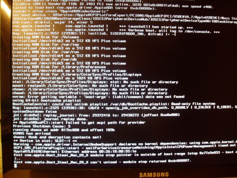

e1ement Posted November 17, 2009 Share Posted November 17, 2009 Hey, I did everything like described but I get stuck at the point you can see in the picture. Link to comment https://www.insanelymac.com/forum/topic/189052-asus-p6t-se-retail-snow-leopard-installation-guide-flashdrive-updated-jun-28/page/6/#findComment-1333565 Share on other sites More sharing options...

akhenamenra Posted November 17, 2009 Share Posted November 17, 2009 Hey, I did everything like described but I get stuck at the point you can see in the picture. seems to have stalled could be the dsmos.kext i couldnt say...did you back up the kernel if so boot with this mach_kernel.backup -v -s and let me know what it says Link to comment https://www.insanelymac.com/forum/topic/189052-asus-p6t-se-retail-snow-leopard-installation-guide-flashdrive-updated-jun-28/page/6/#findComment-1334022 Share on other sites More sharing options...
tweak41 Posted November 19, 2009 Author Share Posted November 19, 2009 Hey, I did everything like described but I get stuck at the point you can see in the picture. If DSMOS is still in the kexts folder, delete it. You only need fakesmc.kext ATTENTION: NEW AUDIO FOR 10.6.2 You're USB-based audio stuff will still work with this. Just tested. http://www.insanelymac.com/forum/index.php?showtopic=161430 Make sure to delete the HDAEnabler.kext too when installing this. Link to comment https://www.insanelymac.com/forum/topic/189052-asus-p6t-se-retail-snow-leopard-installation-guide-flashdrive-updated-jun-28/page/6/#findComment-1336281 Share on other sites More sharing options...

e1ement Posted November 22, 2009 Share Posted November 22, 2009 If DSMOS is still in the kexts folder, delete it. You only need fakesmc.kext I tried it, but it didn't work. I don't get the "com.Dont_Steal_Mac_OS_X.kext"-Error anymore but it still hangs. Link to comment https://www.insanelymac.com/forum/topic/189052-asus-p6t-se-retail-snow-leopard-installation-guide-flashdrive-updated-jun-28/page/6/#findComment-1338909 Share on other sites More sharing options...
tweak41 Posted November 22, 2009 Author Share Posted November 22, 2009 I tried it, but it didn't work. I don't get the "com.Dont_Steal_Mac_OS_X.kext"-Error anymore but it still hangs. Hangs where exactly? Link to comment https://www.insanelymac.com/forum/topic/189052-asus-p6t-se-retail-snow-leopard-installation-guide-flashdrive-updated-jun-28/page/6/#findComment-1339043 Share on other sites More sharing options...
