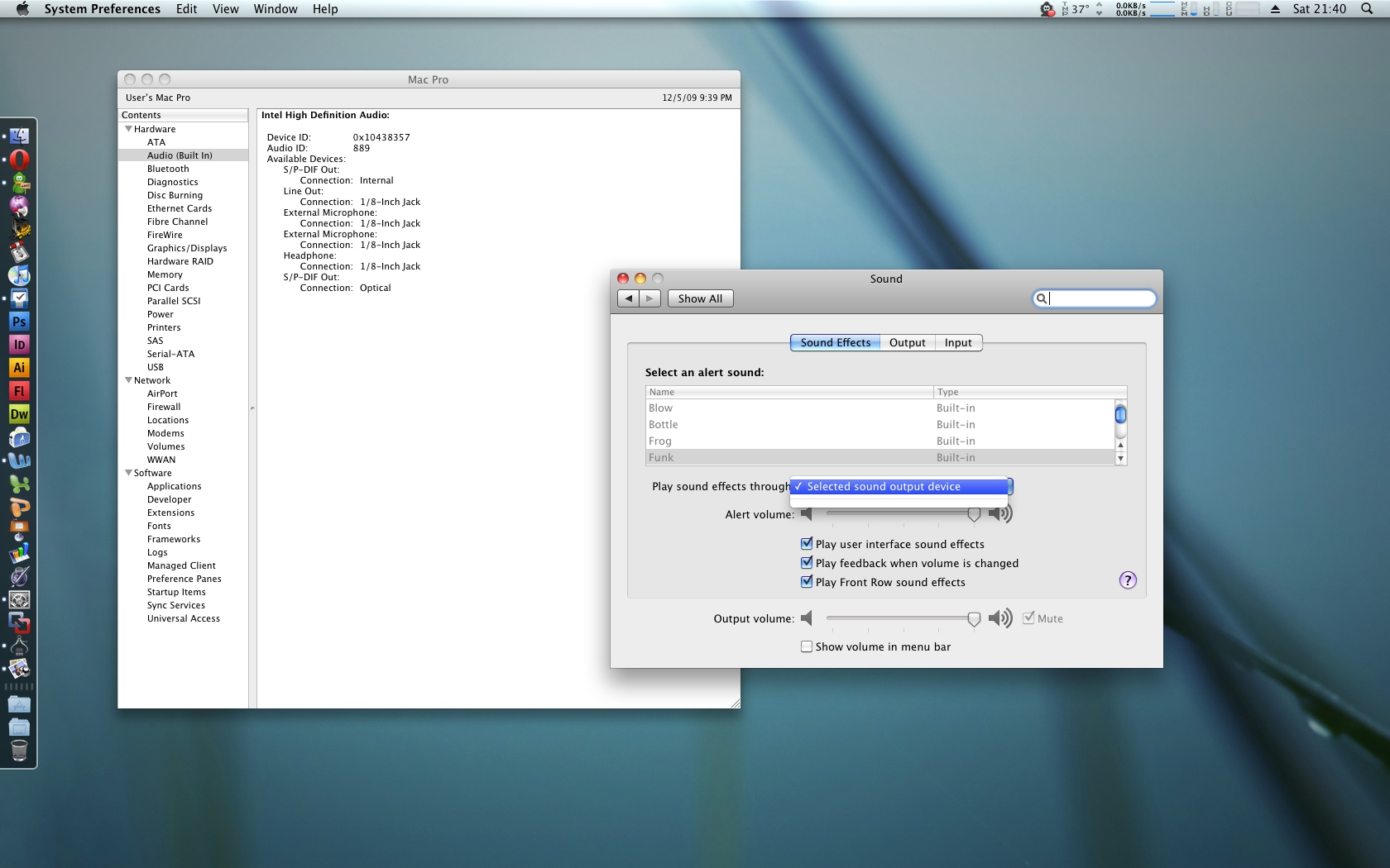

andrew79 Posted December 5, 2009 Share Posted December 5, 2009 What Kexts? AppleHDA and HDAenabler aren't working. Or do I need Kexts for ALC889 since with the latest DSDT.aml System Profile shows up 889 as Audio-ID? e1ement Ooops...sorry i forgot to attach the link to the kexts:( You can download them from here. These 2 work for me on 10.6.2 and i use Bchemist 's dsdt.aml too. These 2 are modified to work with 10.6.2. Older versions included to tweak41 guide did not worked with 10.6.2 This is what system profiler shows up: Device ID: 0x10438357 Audio ID: 12 Available Devices: S/P-DIF Out: Connection: Internal Line Out: Connection: 1/8-Inch Jack Internal Microphone: Connection: Internal External Microphone: Connection: 1/8-Inch Jack Headphone: Connection: 1/8-Inch Jack S/P-DIF Out: Connection: Optical Link to comment https://www.insanelymac.com/forum/topic/189052-asus-p6t-se-retail-snow-leopard-installation-guide-flashdrive-updated-jun-28/page/10/#findComment-1351648 Share on other sites More sharing options...
e1ement Posted December 5, 2009 Share Posted December 5, 2009 Ooops...sorry i forgot to attach the link to the kexts:( You can download them from here. These 2 work for me on 10.6.2 and i use Bchemist 's dsdt.aml too. These 2 are modified to work with 10.6.2. Older versions included to tweak41 guide did not worked with 10.6.2 Well, I got two DSDT.aml versions from Bchemist and with both audio doesn't work. One of the shows Audio-ID 889 and the other doesn't show any audio at all. e1ement PS: My system boots up fine without NullCPUPowerManagement.kext/SleepEnabler.kext, but it reports wrong CPU temperatures. Link to comment https://www.insanelymac.com/forum/topic/189052-asus-p6t-se-retail-snow-leopard-installation-guide-flashdrive-updated-jun-28/page/10/#findComment-1351671 Share on other sites More sharing options...
andrew79 Posted December 5, 2009 Share Posted December 5, 2009 Well, I got two DSDT.aml versions from Bchemist and with both audio doesn't work. One of the shows Audio-ID 889 and the other doesn't show any audio at all. e1ement PS: My system boots up fine without NullCPUPowerManagement.kext/SleepEnabler.kext, but it reports wrong CPU temperatures. Mine is a bit hotter too without nullcpu kext, but not hotter than a core2duo imac (and we talk about quad cores ... so i don't think that getting 4 or 5 degrees hotter is a problem). It is reported all over the forum that without nullcpu, temps are a little bit higher... but scores are higher too. Geekbench gives me better scores without nullcpu extension. Now about the sound issue. Did you tried the kexts i linked in my previous post? As i can see we have the same motherboard and we use same dsdt.aml. So if those kexts don't work for you something is wrong. Are you rebuilding you /extra/extensions.mkext after copying the kexts to /extra/extensions? Have you installed any other modified kexts in System/Library/Extensions? Is your bios updated? Is the onboard audio enabled from bios? We have used the same guide, we have the same motherboard and the same dsdt... so you should have sound. Link to comment https://www.insanelymac.com/forum/topic/189052-asus-p6t-se-retail-snow-leopard-installation-guide-flashdrive-updated-jun-28/page/10/#findComment-1351730 Share on other sites More sharing options...

tweak41 Posted December 6, 2009 Author Share Posted December 6, 2009 Hello all, I posted this link before, but I guess I have to do it again... http://www.insanelymac.com/forum/index.php?showtopic=161430 That is the kext to use for audio. It's the best one. And it's just one kext, not two (he put the HDAenabler.kext inside that one). AND @ssf01 This thread isn't about your {censored} computer. Stop. Link to comment https://www.insanelymac.com/forum/topic/189052-asus-p6t-se-retail-snow-leopard-installation-guide-flashdrive-updated-jun-28/page/10/#findComment-1351959 Share on other sites More sharing options...

andrew79 Posted December 6, 2009 Share Posted December 6, 2009 Tweak41 is right. We do not read carefully all the posts. I missed the information about the working sound with just 1 kext. Also TheCONDOR it is discussed in previous posts that there is no need for these kexts. Tweak41 are you thinking about updating your guide with 10.6.2 kexts etc? I think it would help many users. You could include Bchemist's dsdt and also some more information about bios settings. It is just an idea, of course i don't know if you have the time... Link to comment https://www.insanelymac.com/forum/topic/189052-asus-p6t-se-retail-snow-leopard-installation-guide-flashdrive-updated-jun-28/page/10/#findComment-1352043 Share on other sites More sharing options...

andrew79 Posted December 6, 2009 Share Posted December 6, 2009 Tweak41 i used the one kext for audio and guess what! No more autosleep! I restored the other two kexts i' ve been using for 10.6.2 and scheduled sleep is back! Maybe this is your problem with scheduled sleep and not any peripheral device. Otherwise it's something specific with my system but i don't have a problem using the 2 kexts as long as they work:) Link to comment https://www.insanelymac.com/forum/topic/189052-asus-p6t-se-retail-snow-leopard-installation-guide-flashdrive-updated-jun-28/page/10/#findComment-1352146 Share on other sites More sharing options...
