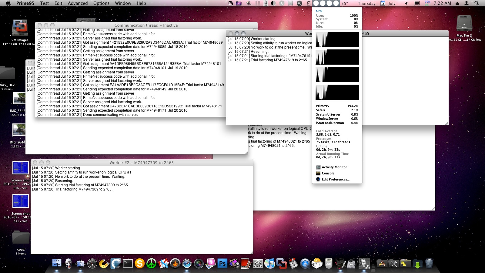

960brick Posted July 6, 2011 Share Posted July 6, 2011 I am considering replacing this CPU (E8400) with maybe a Q9650 (Or even a used QX), has anyone done such a move and if so can you "feel" the difference? Hi DanW I have overclocked my Q9650 to 3.9ghz running stable for the past year, if you are thinking of getting one.(Geekbench) I've been thinking of going SSD myself. Link to comment Share on other sites More sharing options...
JTG78 Posted July 6, 2011 Share Posted July 6, 2011 Hi DanW I have overclocked my Q9650 to 3.9ghz running stable for the past year (Geekbench) it's faster than a 3.1 i7 imac and running stock cooling. I've been thinking of going SSD myself. Speaking of SSDs, I finally went and ordered a 120GB OWC Mercury Electra 6G this past weekend. The Electra drives are roughly the equivalent of OCZ's Agility3 line. At about $205 it was on par price-wise with other SSD drives. I'd originally considered an OCZ Vertex 2 or 3, but the potential reliability issues and greater cost had me reconsider. I got the OWC drive because of the perceived higher reliability and customer support, plus the 30-day money-back guarantee they offer. While the performance may not be as high given it's use of asynchronous Nand, I decided to get the model I did because the OWC Vertex 3 equivalent, the Mercury Extreme Pro 6G is going for $280, which is more that I wanted to pay. Link to comment Share on other sites More sharing options...
D-an-W Posted July 10, 2011 Share Posted July 10, 2011 Hi DanW I have overclocked my Q9650 to 3.9ghz running stable for the past year, if you are thinking of getting one.(Geekbench) I've been thinking of going SSD myself. Question time... What are you idle / load temps? What settings did you use for 3.9GHz please? Also, is there a way to get the VID of the CPU from within Mac OS X? Link to comment Share on other sites More sharing options...
960brick Posted July 11, 2011 Share Posted July 11, 2011 Question time... What are you idle / load temps? What settings did you use for 3.9GHz please? Also, is there a way to get the VID of the CPU from within Mac OS X? Hi DanW, here's a video of the settings, my memory is 800 so you will have to change those according to your speed. The voltage has to be controlled on both memory and cpu. VCORE,Termination and PLL at "Auto" while high fsb will fry your chip no matter how good your cooling is. My idle is between 38C and 44c depending on ambient temp. ( my cpu push fan hasn't been working for a few months) load is between 55C and 60c Link to comment Share on other sites More sharing options...
