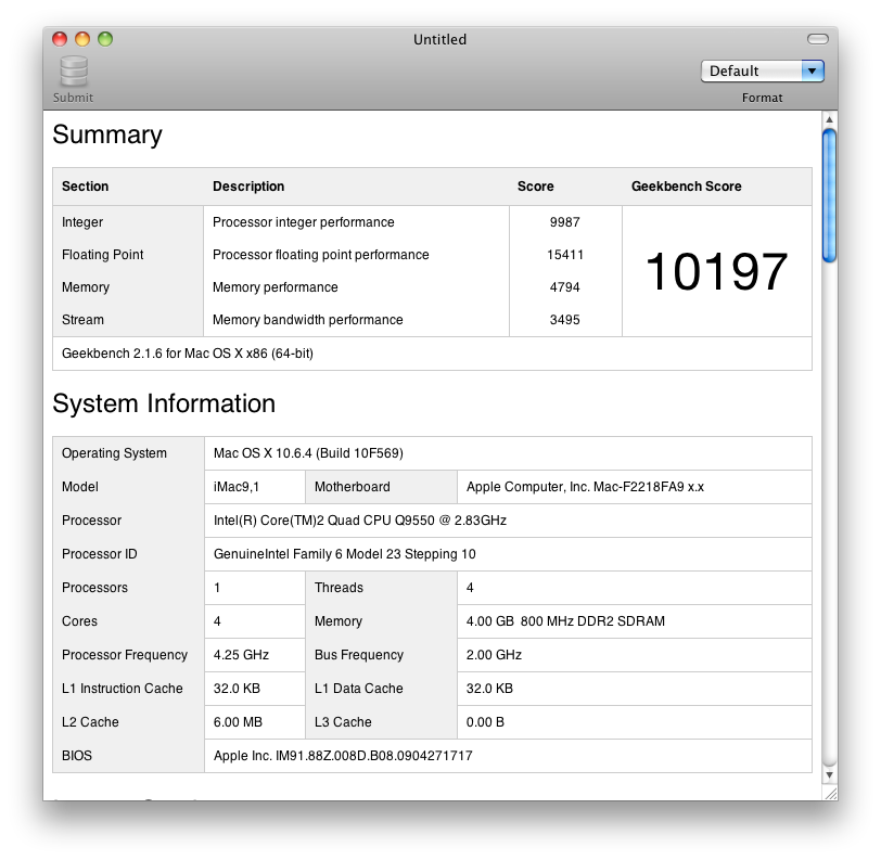

I'm currently running my Q9550 at 4.25 GHz with these settings:

i7 at stock speeds probably won't do this:
Very impressive for Q9550, whats your load temps?
About 65 C running Prime95 small FFT's but that's in a warm room, currently about 28 C. Once weather cools down to normal temperatures I'm probably at 60 C on full load.
Very impressive! My 9550 Stella V.3 won't go above 3.4 GHz.
What's your CPU cooler and is this a Stella V.3 or a Cartri rig?
