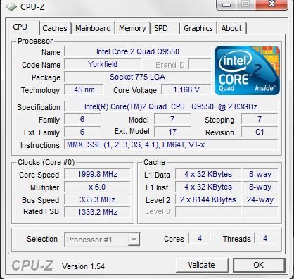

JTG78 Posted July 14, 2010 Share Posted July 14, 2010 Revision is the important information: If it is E0 then C2E and C4E are possible. I checked and apparently I have revision C1. Link to comment https://www.insanelymac.com/forum/topic/187440-lifehacker-guide-with-ga-ep45-ud3p-motherboard/page/76/#findComment-1511208 Share on other sites More sharing options...

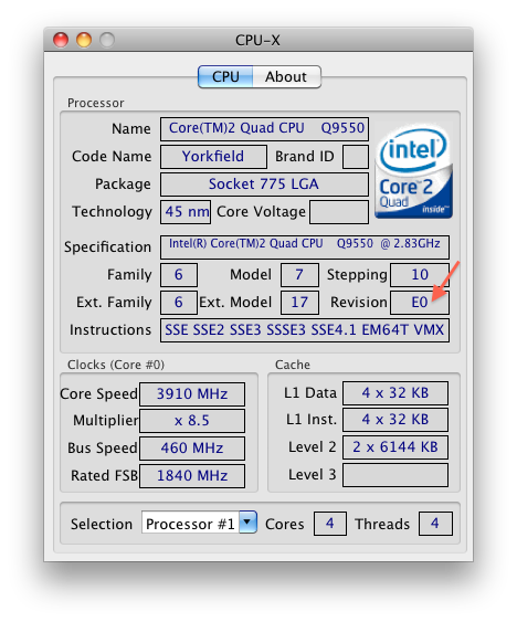

RocketLynx Posted July 15, 2010 Share Posted July 15, 2010 Revision is the important information: If it is E0 then C2E and C4E are possible. I'm having trouble finding CPU-X that works. The link on Netkas is dead. I found 1 download on the net and it runs but it fails to show anything in the CPU revision box, it's just blank. It shows all of the other pertinent information on my Q9550 and all of the other information is there. Does someone have a download link to the CPU-X that is being used on these tests? Am I doing something wrong? Thanks, Charles Link to comment https://www.insanelymac.com/forum/topic/187440-lifehacker-guide-with-ga-ep45-ud3p-motherboard/page/76/#findComment-1511580 Share on other sites More sharing options...
mm67 Posted July 15, 2010 Share Posted July 15, 2010 I'm having trouble finding CPU-X that works. The link on Netkas is dead. I found 1 download on the net and it runs but it fails to show anything in the CPU revision box, it's just blank. It shows all of the other pertinent information on my Q9550 and all of the other information is there. Does someone have a download link to the CPU-X that is being used on these tests? Am I doing something wrong? Thanks, Charles Here: CPU_X.app.zip Link to comment https://www.insanelymac.com/forum/topic/187440-lifehacker-guide-with-ga-ep45-ud3p-motherboard/page/76/#findComment-1511589 Share on other sites More sharing options...
RocketLynx Posted July 15, 2010 Share Posted July 15, 2010 Here:CPU_X.app.zip Wow, that fixed it! Thanks mm67 for the link and the fast reply. It now shows that I have a revision E0 Q9550. Thanks Again, Charles Link to comment https://www.insanelymac.com/forum/topic/187440-lifehacker-guide-with-ga-ep45-ud3p-motherboard/page/76/#findComment-1511591 Share on other sites More sharing options...
