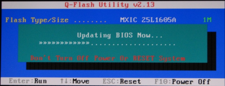

MacTech84 Posted June 23, 2010 Share Posted June 23, 2010 I have aquestion about flashing the bios for a gigabyte bios. If my board is sent back had FB on it. Now to get to FE, it gives you 2 options for flashing the board. One of which requires havings a working windows instalation of which i dont have. The other say to put the downloaded file on a fat32 partition. OK i have another 2 gb falsh drive, i donwloaded the .exe file to gfalsh it. But it says to ectract the bios file to the .xxx file first. I cant figure out how to extract the exe file to get to .xxx of the bios file.... This is in the manual for the EP45-uD3p board. What are any of your provedures of flashing a bios who does not have windows? That would be very helpful. In case they send it back with FB still on it. which was the start of all of my problems in the first place. Gigabyte had no info on flashing a bios with a hackintosh method for obvious reasons. Thanks jbolted I wondered this very damn thing, and it came down to, I had to install Winblows just to get the BIOS out of the damn exe and put onto a flash drive. I might say, use a friends computer with windows, extract the bios and put it on your flash drive there. That was the quickest and easiest way when I updated my BIOS from the BIOS updater, not from within Windows. I have particularly never liked the idea of flashing from within windows, ick... lol Link to comment https://www.insanelymac.com/forum/topic/187440-lifehacker-guide-with-ga-ep45-ud3p-motherboard/page/72/#findComment-1497030 Share on other sites More sharing options...
jbolted Posted June 23, 2010 Share Posted June 23, 2010 I wondered this very damn thing, and it came down to, I had to install Winblows just to get the BIOS out of the damn exe and put onto a flash drive. I might say, use a friends computer with windows, extract the bios and put it on your flash drive there. That was the quickest and easiest way when I updated my BIOS from the BIOS updater, not from within Windows. I have particularly never liked the idea of flashing from within windows, ick... lol Ok, That is very helpful information. I can go to the library, they have windows computers there, I'll bring my 2 gb fash drive already formatted toi Fat32. just one question on the procedure. Do i need a specific program on windows to exrtact the file. Or does windows come with a program that will do that for you. I know little about windows, but i do know if I double click the .exe file it is just going to try to install the program. Or is that what you did? Did you just double click the exe and point it to your falsh drive? Becuase i know 1 thing for sure i am not messing around with fb anymore, & I want to make sure of the cartis bios before i brick my new board. At least the cartis bios has a folder with the bios already extracted, and ready for qflash. I just rather get up and running on FE for now. I guess eventually we will all have to move to cartis bios becasue i heard that stell is not making any new installers. So theoretically, once i get the bios straightened out i should be able to use the drives with the OS's i have on there now, providing they are not hosed too, right? Link to comment https://www.insanelymac.com/forum/topic/187440-lifehacker-guide-with-ga-ep45-ud3p-motherboard/page/72/#findComment-1497060 Share on other sites More sharing options...
MacTech84 Posted June 23, 2010 Share Posted June 23, 2010 Ok, That is very helpful information. I can go to the library, they have windows computers there, I'll bring my 2 gb fash drive already formatted toi Fat32. just one question on the procedure. Do i need a specific program on windows to exrtact the file. Or does windows come with a program that will do that for you. I know little about windows, but i do know if I double click the .exe file it is just going to try to install the program. Or is that what you did? Did you just double click the exe and point it to your falsh drive? Becuase i know 1 thing for sure i am not messing around with fb anymore, & I want to make sure of the cartis bios before i brick my new board. At least the cartis bios has a folder with the bios already extracted, and ready for qflash. I just rather get up and running on FE for now. I guess eventually we will all have to move to cartis bios becasue i heard that stell is not making any new installers. So theoretically, once i get the bios straightened out i should be able to use the drives with the OS's i have on there now, providing they are not hosed too, right? This is what is soo stoop-id! All the exe does is extract out the BIOS. Its a self contained unzip utility if you will. Basically double clicking it unpacks the files you need. Just put everything onto the flash and select it in the BIOS update. Don't know if the library computer will work for you, they might have some restrictions in place preventing you from downloading, or opening the exe, or both! Link to comment https://www.insanelymac.com/forum/topic/187440-lifehacker-guide-with-ga-ep45-ud3p-motherboard/page/72/#findComment-1497111 Share on other sites More sharing options...

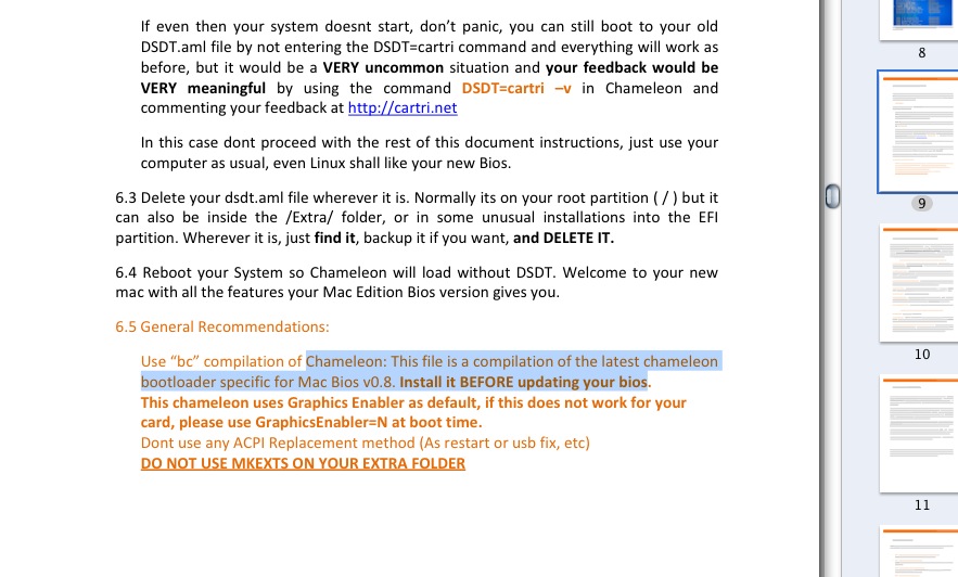

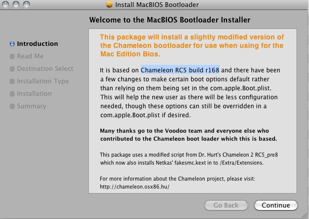

960brick Posted June 24, 2010 Share Posted June 24, 2010 Ok guys Cartri V.8 is out, i'm going for it, wish me luck and please post anything if you've already done it UPDATE : It's done. Macbios v.8 comes with a modified version of Chameleon RC5 build r168 installer which installs fakesmc.kext and LegacyHDA.kext and no more smbios.plist or com.apple.Boot.plist in Extra. Erased VoodooPowerMini.kext and temps are low at 38C idle Link to comment https://www.insanelymac.com/forum/topic/187440-lifehacker-guide-with-ga-ep45-ud3p-motherboard/page/72/#findComment-1497844 Share on other sites More sharing options...
0800damo Posted June 24, 2010 Share Posted June 24, 2010 Ok guys Cartri V8 is out, i'm going for it, wish me luck and please post anything if you've already done it UPDATE : It's done. Macbios v8 comes with a modified version of Chameleon RC5 build r168 installer which installs fakesmc.kext and LegacyHDA.kext in Extra, no more smbios.plist or com.apple.Boot.plist Erased VoodooPowerMini.kext and temps are low at 38C idle Sweet Think I may have to give this ago Any downsides so far Link to comment https://www.insanelymac.com/forum/topic/187440-lifehacker-guide-with-ga-ep45-ud3p-motherboard/page/72/#findComment-1497944 Share on other sites More sharing options...

MacWannaBe Posted June 25, 2010 Share Posted June 25, 2010 Cartri Bios comes with it's own installer for our specific mobo, (EP45UD3P) including Chameleon RC5. I ran the installer before updating the bios,it adds fakesmc.kext and LegacyHDA.kext to /Extra/Extension/ removing smbios.plist and.apple.Boot.plist (not needed) For me Cartri is working with Blackosx on a boot cd, which will make LifeHacker v3 installer obsolete. If you had VoodooPowerMini.kext , just delete it and speed step works perfectly dropping cpu temps a few degrees. Startup and shutdown/restart is a little quicker. Please consider supporting cartri if you do use this bios I want to use this BIOS... so starting from a working Stell V3, when do I run the catri installer? before updaing the BIOS? Do I delete my extra folder and then run the catri installer, then follow the pdf? The pdf does not mention the installer at all... I don't want to mess this up! Thanks Link to comment https://www.insanelymac.com/forum/topic/187440-lifehacker-guide-with-ga-ep45-ud3p-motherboard/page/72/#findComment-1498613 Share on other sites More sharing options...
960brick Posted June 25, 2010 Share Posted June 25, 2010 I want to use this BIOS... so starting from a working Stell V3, when do I run the catri installer? before updaing the BIOS? Do I delete my extra folder and then run the catri installer, then follow the pdf? The pdf does not mention the installer at all... I don't want to mess this up! Thanks That's exactly what i did, the PDF does specify : I tried an unaltered new 10.6.3 install just dragged the Extra folder from my main drive(with 2 kexts only !!), chose it from bootloader and it worked fine. also there is no Chameleon theme folder, if you add one it will overwrite. Link to comment https://www.insanelymac.com/forum/topic/187440-lifehacker-guide-with-ga-ep45-ud3p-motherboard/page/72/#findComment-1498621 Share on other sites More sharing options...
MacWannaBe Posted June 25, 2010 Share Posted June 25, 2010 That's exactly what i did, the PDF does specify : I tried an unaltered new 10.6.3 install just dragged the Extra folder from my main drive(with 2 kexts only !!), chose it from bootloader and it worked fine. also there is no Chameleon theme folder, if you add one it will overwrite. The PDF is confusing in this regard, as that information is after all the installation steps. So to summarize, for us V3 people. 1) Rename our V3 "Extra" folder to "EXTRA_your_momz" 2) Run the catri installer on our boot drive 3) reboot and start the bios upgrade process as per the pdf 4) boot into OSX and and have lower temps, etc... delete the "EXTRA_your_momz" folder. Correct? or did I miss something? Link to comment https://www.insanelymac.com/forum/topic/187440-lifehacker-guide-with-ga-ep45-ud3p-motherboard/page/72/#findComment-1498639 Share on other sites More sharing options...
960brick Posted June 25, 2010 Share Posted June 25, 2010 The PDF is confusing in this regard, as that information is after all the installation steps. So to summarize, for us V3 people. 1) Rename our V3 "Extra" folder to "EXTRA_your_momz" 2) Run the catri installer on our boot drive 3) reboot and start the bios upgrade process as per the pdf 4) boot into OSX and and have lower temps, etc... delete the "EXTRA_your_momz" folder. Correct? or did I miss something? That's it you got it , print the manual out and take your time. Link to comment https://www.insanelymac.com/forum/topic/187440-lifehacker-guide-with-ga-ep45-ud3p-motherboard/page/72/#findComment-1498643 Share on other sites More sharing options...
