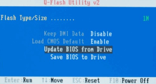

jbolted Posted June 27, 2010 Share Posted June 27, 2010 This is what is soo stoop-id! All the exe does is extract out the BIOS. Its a self contained unzip utility if you will. Basically double clicking it unpacks the files you need. Just put everything onto the flash and select it in the BIOS update. Don't know if the library computer will work for you, they might have some restrictions in place preventing you from downloading, or opening the exe, or both! Well alright, if thats all the exe file does. My nephew works in a sign shop that uses pc's. I'll go up there and unpack it and put it on my thunb drive. Thanks I didnt know it was that simple of a task. So thats the first thing i'll do if FB is still the bios then. I'll qflash it to FE then check out all the cmos settings to make sure they correspond to the original set up steps. once i do that i should be able to boot into either drive, they have the V3 installer on them. but just to be safe, I'll try booting into the 8 GB, setup flash drive first, then run the V3 again on both drives, just in case. And worst comes to worst i can always do a fresh install on one of the drives. Like i said they are cloned anyway, iwill still have all my data on the other. I'll use disk utility first to make sure both drives are good too... Now all i gotta do is wait for them to send me a new or fixed MB. It should be in their possesion by now, & they said its about a 2 week wait. So i'm still looking at 2 and a half weeks. I don't know why gigabyte makes it such a mystery for qflashing the bios. All they tell you is to extract the bios first, they don't tell you how or with what. thanks again for your patience and help. I'll be sure to holler loadly & happily if i get my hackintosh back. I dont know how much more i can take on this old eMAc. Nothing works well on it. It so sooo slow. jbolted Link to comment https://www.insanelymac.com/forum/topic/187440-lifehacker-guide-with-ga-ep45-ud3p-motherboard/page/73/#findComment-1499339 Share on other sites More sharing options...

jbolted Posted June 27, 2010 Share Posted June 27, 2010 This is what is soo stoop-id! All the exe does is extract out the BIOS. Its a self contained unzip utility if you will. Basically double clicking it unpacks the files you need. Just put everything onto the flash and select it in the BIOS update. Don't know if the library computer will work for you, they might have some restrictions in place preventing you from downloading, or opening the exe, or both! I forgot to ask you and while i have the time waiting for the board, now is a good time to ask. I noticed in one of your previous posts that you are now, using FE Bios and kakewalk as your installer and that it uses chamelion RC4 bootlaoder, instead of RC2. Does kakewalk provide some sort of custom DSTL for the specific motherboard like the V3 installer did? I like the idea of seeing the seperate kexts in the E/E folder instead of one mkext file. It makes it a lot easier to replace files that become obsolete or that do not work. What was your process for switching from the stell V3 installer to the kakewalk installer? thanks for your help and patience, jbolted Link to comment https://www.insanelymac.com/forum/topic/187440-lifehacker-guide-with-ga-ep45-ud3p-motherboard/page/73/#findComment-1499859 Share on other sites More sharing options...

AkronElliott Posted July 1, 2010 Share Posted July 1, 2010 This Update has been difficult. 1. Could not rename Extra in Finder. Only could rename the non-booted drive. Tried using Terminal but mv gave me permission errors. 2. Formatted the USB - V3 Lifehacker thumb-drive to FAT. Placed the G4-EP45-UD3P2.rar on the FAT USB Thumb drive. This will not boot. 3. Tried to open the G4-EP45-UD3P2.rar on the hard drive but it open VLC. ----- Downloaded the Boot-CD. Burned the ISO onto a CD. Rebooted, Did not run. Opened the ISO and installed on the hard drive. So I continued with the install. Updated HardDrive2, the clone. Then Updated HardDrive1. Rebooted, expected to flash the BIOS. Got into the System, Hard Drives are now orange. Tried rebooting and can not get to the Q-Flash --- Only got the EXTRA folder installed - could not get the BIOS flashed. I got the LIFEHACKER V3 EXTRA and replaced CARTRI's So I am back at V3. Will need to re-read the directions. SO many different options ----- Did not look anything like the YouTube videos. Link to comment https://www.insanelymac.com/forum/topic/187440-lifehacker-guide-with-ga-ep45-ud3p-motherboard/page/73/#findComment-1502773 Share on other sites More sharing options...
960brick Posted July 2, 2010 Share Posted July 2, 2010 3. Tried to open the G4-EP45-UD3P2.rar on the hard drive but it open VLC. 1 Download "Unrar", open "G4-EP45-UD3P2.rar" with "Unrar" 2 Delete Extra 3 "G4-EP45-UD3P2.rar" contains "MacBIOS Bootloader v0.3lb.pkg" run it , select main drive 4 Copy "P45UD3P2.08" ( from rar package) to FAT 32 USB drive 5 Restart, press "end" key select "P45UD3P2.08" from USB 6 Disable “Keep DMI Data” and Enable “Load CMOS Defaults” Flash Bios 7 When Bios flash is complete Power Off by pressing F10 8 Turn on system and wait till bootloader loads , Instantly shut down 9 Turn on system again and press "delete" go into bios, press CTRL+F1 until screen flashes 10 Edit bios settings from manual Link to comment https://www.insanelymac.com/forum/topic/187440-lifehacker-guide-with-ga-ep45-ud3p-motherboard/page/73/#findComment-1502804 Share on other sites More sharing options...
backinmac Posted July 2, 2010 Share Posted July 2, 2010 This Update has been difficult. 1. Could not rename Extra in Finder. Only could rename the non-booted drive. Tried using Terminal but mv gave me permission errors. 2. Formatted the USB - V3 Lifehacker thumb-drive to FAT. Placed the G4-EP45-UD3P2.rar on the FAT USB Thumb drive. This will not boot. 3. Tried to open the G4-EP45-UD3P2.rar on the hard drive but it open VLC. ----- Downloaded the Boot-CD. Burned the ISO onto a CD. Rebooted, Did not run. Opened the ISO and installed on the hard drive. So I continued with the install. Updated HardDrive2, the clone. Then Updated HardDrive1. Rebooted, expected to flash the BIOS. Got into the System, Hard Drives are now orange. Tried rebooting and can not get to the Q-Flash --- Only got the EXTRA folder installed - could not get the BIOS flashed. I got the LIFEHACKER V3 EXTRA and replaced CARTRI's So I am back at V3. Will need to re-read the directions. SO many different options ----- Did not look anything like the YouTube videos. 1. Do a fresh install of Stell's V3. 2. Get all necessary files in order. (Exta/Extensions, necessary Kexts, etc.) 3. The .rar file needs to be unrared. Download UnrarX and have it Extract to desktop. By default, it extracts to the file's directory which is not what you need. Upon doing that, open the folder on your desktop. The only file you need on the flash drive is the .08 file. This is the BIOS file. You also need to install the MacBIOS Bootloader installer. This installs Chameleon RC5. 4. Run the installer. You don't need this on the flash drive. 5. After you do this, do not try to boot back into Mac OS X until you are done. 6. Upon Motherboard POST, hold the END key on your keyboard, this brings you to the Q-Flash utility. 7. Follow Cartri's guide EXTREMELY carefully from here. What you were doing wrong is trying to put the .rar file on the flash drive without extracting it. Furthermore, this is different from Stell's, you do not actually install Mac OS X from the flash drive. The flash drive merely holds the necessary BIOS files. Good Luck! Link to comment https://www.insanelymac.com/forum/topic/187440-lifehacker-guide-with-ga-ep45-ud3p-motherboard/page/73/#findComment-1502808 Share on other sites More sharing options...
