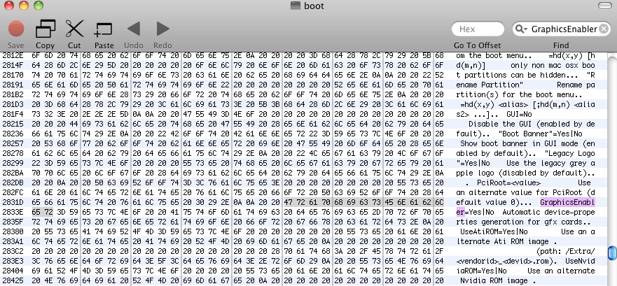

mm67 Posted August 7, 2010 Share Posted August 7, 2010 Anyone got a comment on this? You are using GraphicsEnabler option in com.apple.Boot.plist ? If so then Chameleon is injecting properties of your card to IORegistry, it does same thing automatically as using EFI strings or dsdt patching to make your card work. Link to comment https://www.insanelymac.com/forum/topic/187440-lifehacker-guide-with-ga-ep45-ud3p-motherboard/page/78/#findComment-1526502 Share on other sites More sharing options...

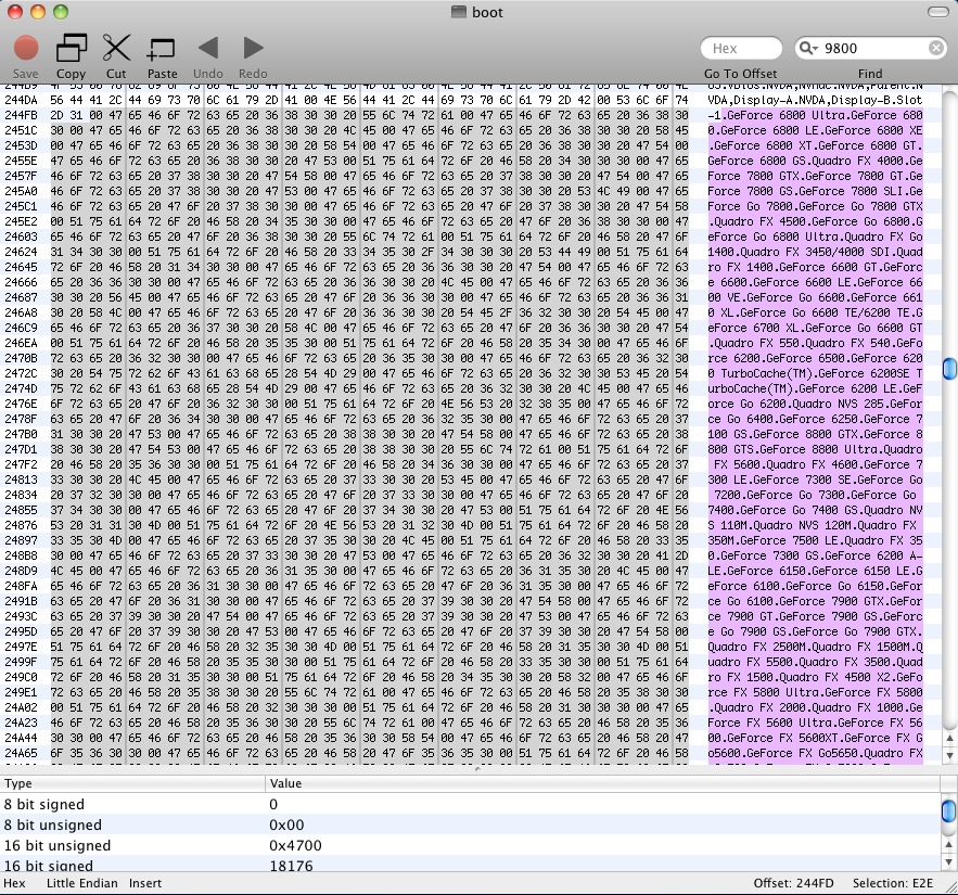

960brick Posted August 8, 2010 Share Posted August 8, 2010 You are using GraphicsEnabler option in com.apple.Boot.plist ? This is Chameleon "boot" that comes with Cartri v0.8 Link to comment https://www.insanelymac.com/forum/topic/187440-lifehacker-guide-with-ga-ep45-ud3p-motherboard/page/78/#findComment-1526584 Share on other sites More sharing options...
RocketLynx Posted August 8, 2010 Share Posted August 8, 2010 This is Chameleon "boot" that comes with Cartri v0.8 Wow! Thanks 960brick. I get it completely. Thanks also for the example contents of the Chameleon Boot file. I looked in mine from the package provided Cartri and I noticed a great many ATI cards in there as well as nVidia. Are the folks that post of trouble with ATI just not using a specified card or are the referenced ATI models still buggy? Also, I ask this, if a person was to use a real Apple version GT 120 PCIe Graphics Card, or another Apple Mac video card, would you not use Graphics Enabler in the com.Apple.Boot.plist and it would be picked up natively by the SL 10.6.4 OS X? Or would you still have to use the "Graphics Enabler" key for it to be injected? Charles Link to comment https://www.insanelymac.com/forum/topic/187440-lifehacker-guide-with-ga-ep45-ud3p-motherboard/page/78/#findComment-1526622 Share on other sites More sharing options...

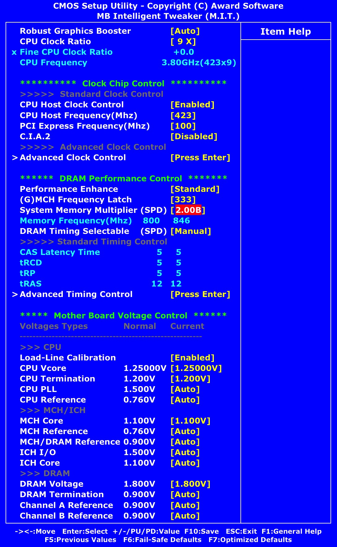

0800damo Posted August 9, 2010 Share Posted August 9, 2010 Pressing the "end" key invokes Q-‐Flash to scan for FAT32 Partitions only. Have you done this ? [/quote 960 brick Is there any chance you could share with me your O.C settings as I don,t seem to be having any luck I am quite new to this OCing Many Thanks Link to comment https://www.insanelymac.com/forum/topic/187440-lifehacker-guide-with-ga-ep45-ud3p-motherboard/page/78/#findComment-1527701 Share on other sites More sharing options...
960brick Posted August 10, 2010 Share Posted August 10, 2010 Is there any chance you could share with me your O.C settings as I don,t seem to be having any luck I am quite new to this OCing Many Thanks Link to comment https://www.insanelymac.com/forum/topic/187440-lifehacker-guide-with-ga-ep45-ud3p-motherboard/page/78/#findComment-1527779 Share on other sites More sharing options...
mm67 Posted August 10, 2010 Share Posted August 10, 2010 You should set PLL voltage yourself, 1.5 V is ok for such low FSB. Using Auto setting on Cpu Termination and PLL is dangerous since that settings tends to set those voltages over safe values. Link to comment https://www.insanelymac.com/forum/topic/187440-lifehacker-guide-with-ga-ep45-ud3p-motherboard/page/78/#findComment-1527840 Share on other sites More sharing options...
0800damo Posted August 10, 2010 Share Posted August 10, 2010 You should set PLL voltage yourself, 1.5 V is ok for such low FSB. Using Auto setting on Cpu Termination and PLL is dangerous since that settings tends to set those voltages over safe values. What would you suggest these values to be and what are your OC settings My setup is the same as 960 brick thanks Thank you 960 brick that was very helpful. Link to comment https://www.insanelymac.com/forum/topic/187440-lifehacker-guide-with-ga-ep45-ud3p-motherboard/page/78/#findComment-1527861 Share on other sites More sharing options...

960brick Posted August 10, 2010 Share Posted August 10, 2010 You should set PLL voltage yourself, 1.5 V is ok for such low FSB. Using Auto setting on Cpu Termination and PLL is dangerous since that settings tends to set those voltages over safe values. Thats right, default voltages (not AUTO) on CPU and memory keep it stable. Link to comment https://www.insanelymac.com/forum/topic/187440-lifehacker-guide-with-ga-ep45-ud3p-motherboard/page/78/#findComment-1528178 Share on other sites More sharing options...
mm67 Posted August 10, 2010 Share Posted August 10, 2010 What would you suggest these values to be and what are your OC settings My setup is the same as 960 brick thanks Max safe values according to Intel datasheets for our Cpu's are 1.45 V for Vcore and termination, for PLL about 1.6 V. Using Auto setting with higher than stock FSB will often make those voltages go higher than that so always set them manually when overclocking. References can usually be left on auto, MCH core voltage depends on amount of memory and speed of FSB, quad cores also usually need more MCH voltage than dual cores. ICH voltages are usually ok on default value, sometimes you need a bit higher value if you for example have lots of hard disks. Dram voltage should be set according to specs of your memory kit. I myself am current running my Q9550 at 4.25 GHz which needs some more tweaking than just those basic values but here is my voltage settings for running 460 * 8.5 , 3.91 GHz. Load-Line Calibration..........................[ Enabled ] CPU Vcore [ 1.225].............................[ Normal ] CPU Termination [ 1.20 ].......................[ 1.22 ] CPU PLL [ 1.50 ]...............................[ 1.57 ] CPU Reference [ 0.760 ]........................[ Auto ] MCH Core [ 1.100 ].......................[ 1.30 ] MCH Reference [ 0.760 ]..................[ Auto ] MCH/DRAM Refernce [ 0.900 ]..............[ Auto ] ICH I/O [ 1.500 ]........................[ 1.57 ] ICH Core [ 1.100 ].......................[ 1.20 ] DRAM Voltage [ 1.800 ]...................[1.90 ] DRAM Termination [ 0.900 ]...............[ Auto ] Channel A Ref [ 0.900 ]..................[ Auto ] Channel B Ref [ 0.900 ]..................[ Auto ] You just have to remember that each chip is different, some can run very high FSB's with very low Vcore and some will need a lot more. Often VID value is a good indicator of how easily chip will overclock. Link to comment https://www.insanelymac.com/forum/topic/187440-lifehacker-guide-with-ga-ep45-ud3p-motherboard/page/78/#findComment-1528220 Share on other sites More sharing options...
960brick Posted August 10, 2010 Share Posted August 10, 2010 What would you suggest these values to be and what are your OC settings My setup is the same as 960 brick thanks Thank you 960 brick that was very helpful. I have not been able to clock it higher than 3.8GHz, with default volts settings, Obviously mm67 know more about this. If you do clock it to 4Ghz with load temps not higher than mid 50s, please share your settings, which would save me a lot of time EDIT : Its stable at 3.9GHz , VCORE-1.27V ,CPU Termination-1.220V, CPU PLL-1.500V Link to comment https://www.insanelymac.com/forum/topic/187440-lifehacker-guide-with-ga-ep45-ud3p-motherboard/page/78/#findComment-1528266 Share on other sites More sharing options...
mm67 Posted August 10, 2010 Share Posted August 10, 2010 I have not been able to clock it higher than 3.8GHz, with default volts settings, Obviously mm67 know more about this. If you do clock it to 4Ghz with load temps not higher than mid 50s, please share your settings, which would save me a lot of time Your cpu doesn't have a very good VID, 1.25 V is on upper side and that usually means it won't overclock as easily. Best ones I have seen people using had VID's like 1.15 or 1.16 V, those are usually really great for overclocking. My chip has a pretty average 1.225 VID but it does overclock really easily, my FSB now is 500 but I only need to set Vcore to 1.3375 V to run it stable. Link to comment https://www.insanelymac.com/forum/topic/187440-lifehacker-guide-with-ga-ep45-ud3p-motherboard/page/78/#findComment-1528285 Share on other sites More sharing options...
