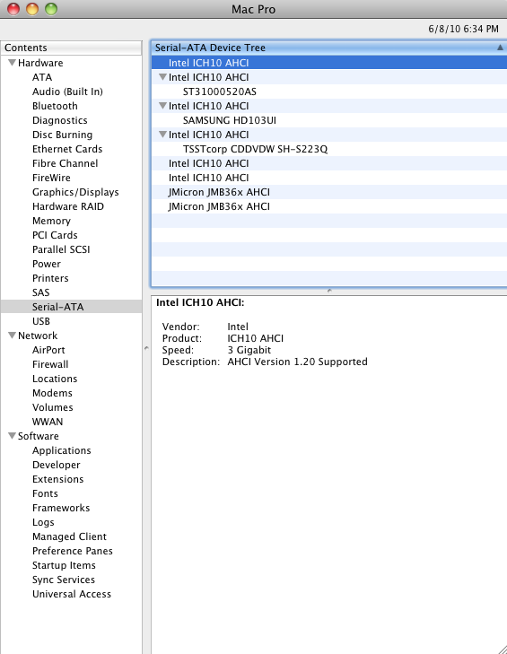

Wowzer42 Posted June 8, 2010 Share Posted June 8, 2010 Does anyone know if the eSATA interface works with this rig? I have a box with eSATA ports, but am not sure if the motherboard has connectors/support for eSATA. Thanks. Link to comment https://www.insanelymac.com/forum/topic/187440-lifehacker-guide-with-ga-ep45-ud3p-motherboard/page/68/#findComment-1484460 Share on other sites More sharing options...
D-an-W Posted June 8, 2010 Share Posted June 8, 2010 My eSATA connects via a SATA connection on the motherboard just like any other so I would assume you will be fine. Link to comment https://www.insanelymac.com/forum/topic/187440-lifehacker-guide-with-ga-ep45-ud3p-motherboard/page/68/#findComment-1484477 Share on other sites More sharing options...
Wowzer42 Posted June 8, 2010 Share Posted June 8, 2010 I've checked my hardware and a SATA cable is inserted into the eSATA interface of my case. The SATA cable is plugged into one of the orange/yellow motherboard SATA slots. IIRC, the purple slots were not good to use. However, when I plug in the eSATA cable and turn on my external enclosure, I do not see my HD mount. In my Apple System profiler, I do not see an eSATA interface---what should I see? I've embedded a picture of what I see below: Link to comment https://www.insanelymac.com/forum/topic/187440-lifehacker-guide-with-ga-ep45-ud3p-motherboard/page/68/#findComment-1484942 Share on other sites More sharing options...
MacTech84 Posted June 8, 2010 Share Posted June 8, 2010 I've checked my hardware and a SATA cable is inserted into the eSATA interface of my case. The SATA cable is plugged into one of the orange/yellow motherboard SATA slots. IIRC, the purple slots were not good to use. However, when I plug in the eSATA cable and turn on my external enclosure, I do not see my HD mount. In my Apple System profiler, I do not see an eSATA interface---what should I see? You will not see anything in your System Profiler for eSata, since its using a regular Sata port on the motherboard. You might want to see if your external enclosure works, or works well with Hot Plugging or Hot Swapping (if those are not right, let me know) but basically that you can turn it on at anytime, vs turning it on before powering up. I used to have an external case that would only work powered on, before booting the entire system. Link to comment https://www.insanelymac.com/forum/topic/187440-lifehacker-guide-with-ga-ep45-ud3p-motherboard/page/68/#findComment-1484949 Share on other sites More sharing options...
rddrgn Posted June 9, 2010 Share Posted June 9, 2010 I have this strange new problem at 10.6.3 with all updates. I click on the about this mac button and poof the whole screen goes into what looks like a mini reboot and comes right back on to the desktop. What could be causing this? browser is forced closed and all apps I had open are also forced closed when this happens. Previously I could click on the about this mac button without any issues? Help! Link to comment https://www.insanelymac.com/forum/topic/187440-lifehacker-guide-with-ga-ep45-ud3p-motherboard/page/68/#findComment-1484977 Share on other sites More sharing options...
Wowzer42 Posted June 9, 2010 Share Posted June 9, 2010 You will not see anything in your System Profiler for eSata, since its using a regular Sata port on the motherboard. You might want to see if your external enclosure works, or works well with Hot Plugging or Hot Swapping (if those are not right, let me know) but basically that you can turn it on at anytime, vs turning it on before powering up. I used to have an external case that would only work powered on, before booting the entire system. MacTech84 (SBMac), you hit the nail on the head. It is not hot swappable...i.e. I had to restart with the drive power on before it was recognized. Now the problem is that if I have the external eSATA device on at the boot stage, the machine hangs on the verifying DMI... stage. I believe this has to do with the order of boot in the SATA bios. I can't, however, figure out how to change it. The trick is to not have the external enclosure powered on until AFTER the boot screen shows up (i.e. before the point where you select your boot drive via OSX). Does this also mean that external eSATA devices can boot OSX? That would be sweet. Link to comment https://www.insanelymac.com/forum/topic/187440-lifehacker-guide-with-ga-ep45-ud3p-motherboard/page/68/#findComment-1484997 Share on other sites More sharing options...

scorcho Posted June 9, 2010 Share Posted June 9, 2010 you can hotswap with eSATA using the jmicron SATA ports with this extension in E/E or S/L/E http://tonymacx86.blogspot.com/2010/03/jmi...ta-support.html download the xe variant. allows full swap capability post-boot sequence. Link to comment https://www.insanelymac.com/forum/topic/187440-lifehacker-guide-with-ga-ep45-ud3p-motherboard/page/68/#findComment-1485081 Share on other sites More sharing options...
Wowzer42 Posted June 9, 2010 Share Posted June 9, 2010 you can hotswap with eSATA using the jmicron SATA ports with this extension in E/E or S/L/E http://tonymacx86.blogspot.com/2010/03/jmi...ta-support.html download the xe variant. allows full swap capability post-boot sequence. Scorcho, Thanks for the link. I'll give it a go when I get back to my machine. Link to comment https://www.insanelymac.com/forum/topic/187440-lifehacker-guide-with-ga-ep45-ud3p-motherboard/page/68/#findComment-1485498 Share on other sites More sharing options...
Wowzer42 Posted June 10, 2010 Share Posted June 10, 2010 you can hotswap with eSATA using the jmicron SATA ports with this extension in E/E or S/L/E http://tonymacx86.blogspot.com/2010/03/jmi...ta-support.html download the xe variant. allows full swap capability post-boot sequence. Scorcho, I read the website, and it appears that my build has the jmicron kext already. In my apple system profiler, I see the Jmicron JMB36x AHCI. Does the 'x' make any difference? Also, I've downloaded the kext, but am having trouble---when I install them and rebuild the kext with vchad's utility, I get a statement that the kext was installed improperly. Ahhh...nevermind. I re-read the instructions and it says to place the kext into /Extra/Extensions and not /System/Library/Extensions my bad...going to see if this works....it didn't work immediately. Going to restart and see if it works. Link to comment https://www.insanelymac.com/forum/topic/187440-lifehacker-guide-with-ga-ep45-ud3p-motherboard/page/68/#findComment-1485595 Share on other sites More sharing options...
Wowzer42 Posted June 10, 2010 Share Posted June 10, 2010 you can hotswap with eSATA using the jmicron SATA ports with this extension in E/E or S/L/E http://tonymacx86.blogspot.com/2010/03/jmi...ta-support.html download the xe variant. allows full swap capability post-boot sequence. Scorcho, I read the website, and it appears that my build has the jmicron kext already. In my apple system profiler, I see the Jmicron JMB36x AHCI. Does the 'x' make any difference? Also, I've downloaded the kext, but am having trouble---when I install them and rebuild the kext with vchad's utility, I get a statement that the kext was installed improperly. Ahhh...nevermind. I re-read the instructions and it says to place the kext into /Extra/Extensions and not /System/Library/Extensions my bad...going to see if this works....it didn't work immediately. Going to restart and see if it works. Link to comment https://www.insanelymac.com/forum/topic/187440-lifehacker-guide-with-ga-ep45-ud3p-motherboard/page/68/#findComment-1485596 Share on other sites More sharing options...
Wowzer42 Posted June 10, 2010 Share Posted June 10, 2010 Oh man...what a mistake this was. Since posting at around 8pm, I've done nothing short of pulling my hair out. The system hung on the reboot. I tried single user mode to remove the /Extra/Extensions and kext files, but the system wouldn't boot. It gets stuck on the sound kext. I tried to remove /System/Extensions/Extensions.kext and mkext and that didnt' work. I'm remastering the SL DVD as we speak because I used my original usb drive (which I used to boot OSX) for something else. What a disaster...but at least my files are all there (and backed up if I have to nuke the whole drive). Needless to say, don't try installing the hot swappable kext...it'll make you miserable (at least it made me miserable). Scorcho, I read the website, and it appears that my build has the jmicron kext already. In my apple system profiler, I see the Jmicron JMB36x AHCI. Does the 'x' make any difference? Also, I've downloaded the kext, but am having trouble---when I install them and rebuild the kext with vchad's utility, I get a statement that the kext was installed improperly. Ahhh...nevermind. I re-read the instructions and it says to place the kext into /Extra/Extensions and not /System/Library/Extensions my bad...going to see if this works....it didn't work immediately. Going to restart and see if it works. Link to comment https://www.insanelymac.com/forum/topic/187440-lifehacker-guide-with-ga-ep45-ud3p-motherboard/page/68/#findComment-1485663 Share on other sites More sharing options...
