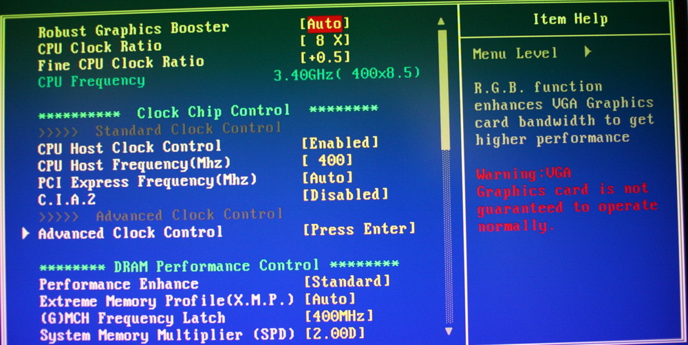

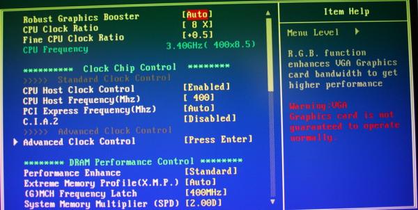

ruby_99 Posted December 4, 2009 Share Posted December 4, 2009 ...Also, I just noticed that in your signature you mention that your quad core is at 2.67 and not 2.83, go into your BIOS and look up the multiplier rate under the CPU options, forgive me I do not recall where its at right now, and if its at 8, change it to 9. This happened to me when I put the chip in, as my multiplier should have been at 9 but it was at 8, thus slowing my CPU.I mentioned this around page 20 of this thread -- the only options available for me to change are 6x, 7x, and 8x. No 9x multiplier. Obviously, it's a waste, but I haven't gotten around to investigating the cause. I don't think that I've tried it since using the v.3 installer, but that shouldn't have anything to do with the BIOS, right? (Pardon my newbness.) I'll try to change it now. <edit> I still couldn't change the multiplier to 9x, but I changed it to 8.5, which gave me 2.83. Thanks for prodding me to try it again. In the past few weeks, I've changed other BIOS settings. Maybe I'll go through the lifehacker screens again to compare. Link to comment https://www.insanelymac.com/forum/topic/187440-lifehacker-guide-with-ga-ep45-ud3p-motherboard/page/30/#findComment-1350268 Share on other sites More sharing options...
HAVEC Posted December 4, 2009 Share Posted December 4, 2009 I mentioned this around page 20 of this thread -- the only options available for me to change are 6x, 7x, and 8x. No 9x multiplier. Obviously, it's a waste, but I haven't gotten around to investigating the cause. I don't think that I've tried it since using the v.3 installer, but that shouldn't have anything to do with the BIOS, right? (Pardon my newbness.) I'll try to change it now. <edit> I still couldn't change the multiplier to 9x, but I changed it to 8.5, which gave me 2.83. Thanks for prodding me to try it again. In the past few weeks, I've changed other BIOS settings. Maybe I'll go through the lifehacker screens again to compare. I have a Q9500 on an old Asus P5B deluxe running at a multiplier of 8.5 times a bus speed of 400 for a core speed of 3.4 GHz. RAM is at 400 mHz so the FSB: DRAM is 1:1. I just received another Q9550 chip and 2 sticks of 8500 G. Skill today that I'm going to install in my UD3P Hack this weekend which I hope to clock just like the Asus board. Hopefully, I'll be able to post the settings in a couple of days. Link to comment https://www.insanelymac.com/forum/topic/187440-lifehacker-guide-with-ga-ep45-ud3p-motherboard/page/30/#findComment-1350317 Share on other sites More sharing options...
MacTech84 Posted December 4, 2009 Share Posted December 4, 2009 I mentioned this around page 20 of this thread -- the only options available for me to change are 6x, 7x, and 8x. No 9x multiplier. Obviously, it's a waste, but I haven't gotten around to investigating the cause. I don't think that I've tried it since using the v.3 installer, but that shouldn't have anything to do with the BIOS, right? (Pardon my newbness.) I'll try to change it now. <edit> I still couldn't change the multiplier to 9x, but I changed it to 8.5, which gave me 2.83. Thanks for prodding me to try it again. In the past few weeks, I've changed other BIOS settings. Maybe I'll go through the lifehacker screens again to compare. Well I feel like a jacka$$, I totally forgot about that setting on some CPU's, some will let you do the .5 increments. Thanks for reminding me... I have a Q9500 on an old Asus P5B deluxe running at a multiplier of 8.5 times a bus speed of 400 for a core speed of 3.4 GHz. RAM is at 400 mHz so the FSB: DRAM is 1:1. I just received another Q9550 chip and 2 sticks of 8500 G. Skill today that I'm going to install in my UD3P Hack this weekend which I hope to clock just like the Asus board. Hopefully, I'll be able to post the settings in a couple of days. Definitely let us know your settings, I have been wanting to tweak with the BIOS, but trying not to brick my board, lol... Link to comment https://www.insanelymac.com/forum/topic/187440-lifehacker-guide-with-ga-ep45-ud3p-motherboard/page/30/#findComment-1351020 Share on other sites More sharing options...

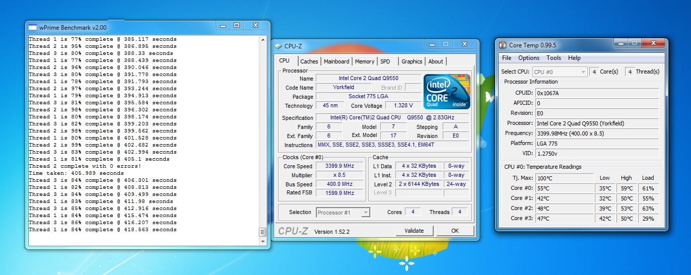

HAVEC Posted December 6, 2009 Share Posted December 6, 2009 Well I feel like a jacka$$, I totally forgot about that setting on some CPU's, some will let you do the .5 increments. Thanks for reminding me... Definitely let us know your settings, I have been wanting to tweak with the BIOS, but trying not to brick my board, lol... Overclocking the 2.83 Ghz 9550 to 3.4 is straightforward. I tested the the system in Win 7 using Coretemp, WPrime and CPUID to see if the temperatures were good using an Arctic Cooling Freezer 7 Pro Rev.2 on the CPU. Link to comment https://www.insanelymac.com/forum/topic/187440-lifehacker-guide-with-ga-ep45-ud3p-motherboard/page/30/#findComment-1351847 Share on other sites More sharing options...
