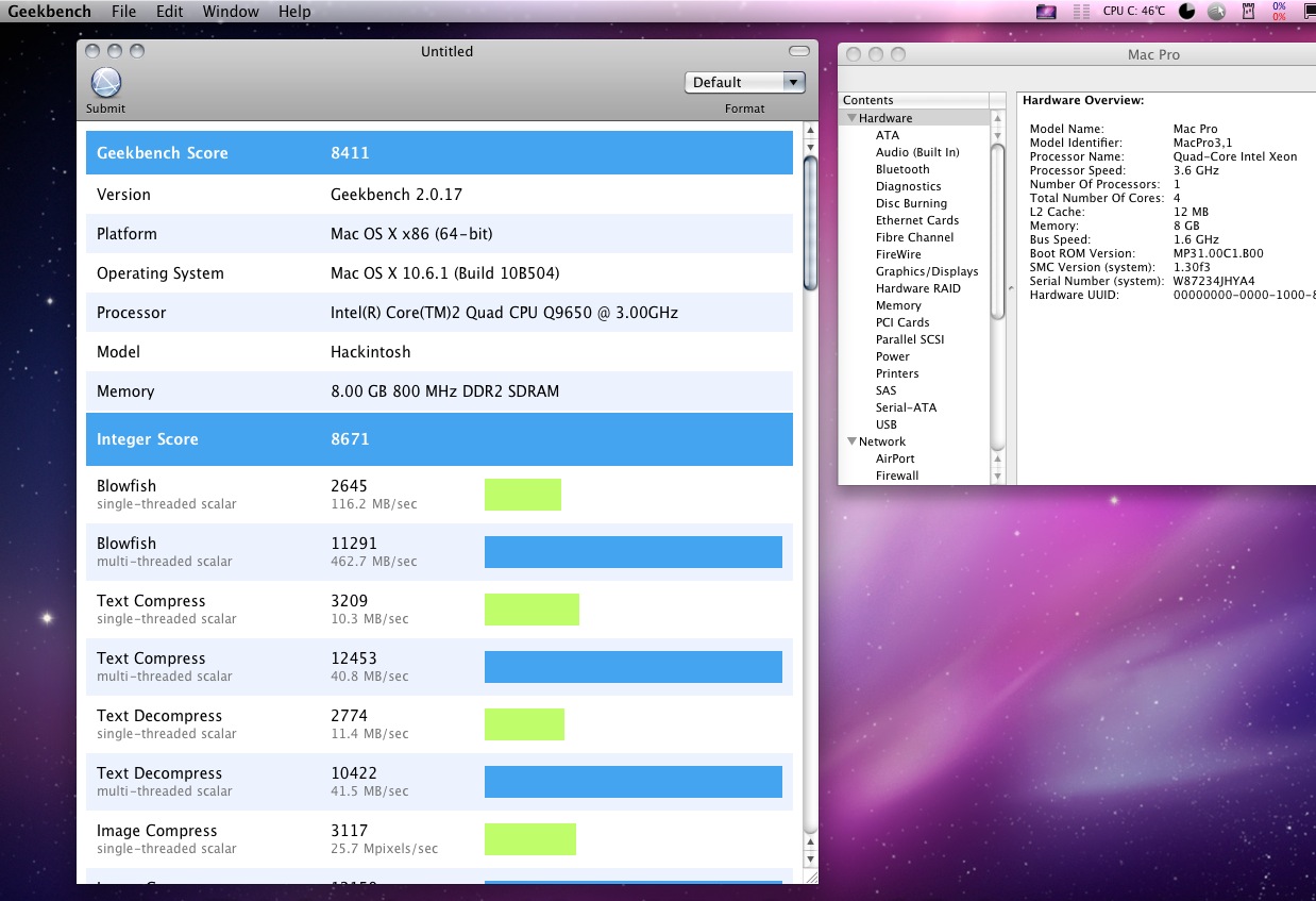

OK I have a Q9650 3.0GHz running stable at 3.6Ghz
Replaced the stock cooler with Arctic 7 pro and used the "Easy Tune" utility (running XP)
46C idle and no more than 53C. These temps are with V3 installer, so it can be cooler.
I also used the F11 in BIOS to make presets in case I need to revert back to the old settings
What settings did you change in BIOS to OC the chip? Curious as I have the same one, and I have the new Corsair H50 Liquid cooling system on it.
Did a Windows install just to run the Easy Tune utility that came with the MoBo. and made a preset of the original settings in the bios incase I needed to switch back. Also added 3 case fans right over the cpu cooler and left the cover off.
