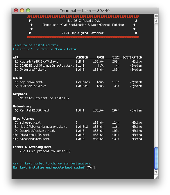

1. Kexts install according to the enclosed screen (Extra/System)
2. Update the boot cache
3. Disc utilty> Repair Disk Permissions (startup disk)
4. Reboot
In this set kexts for me all work (including sleep function)
But with Bonjour, unfortunately, is still a problem ....

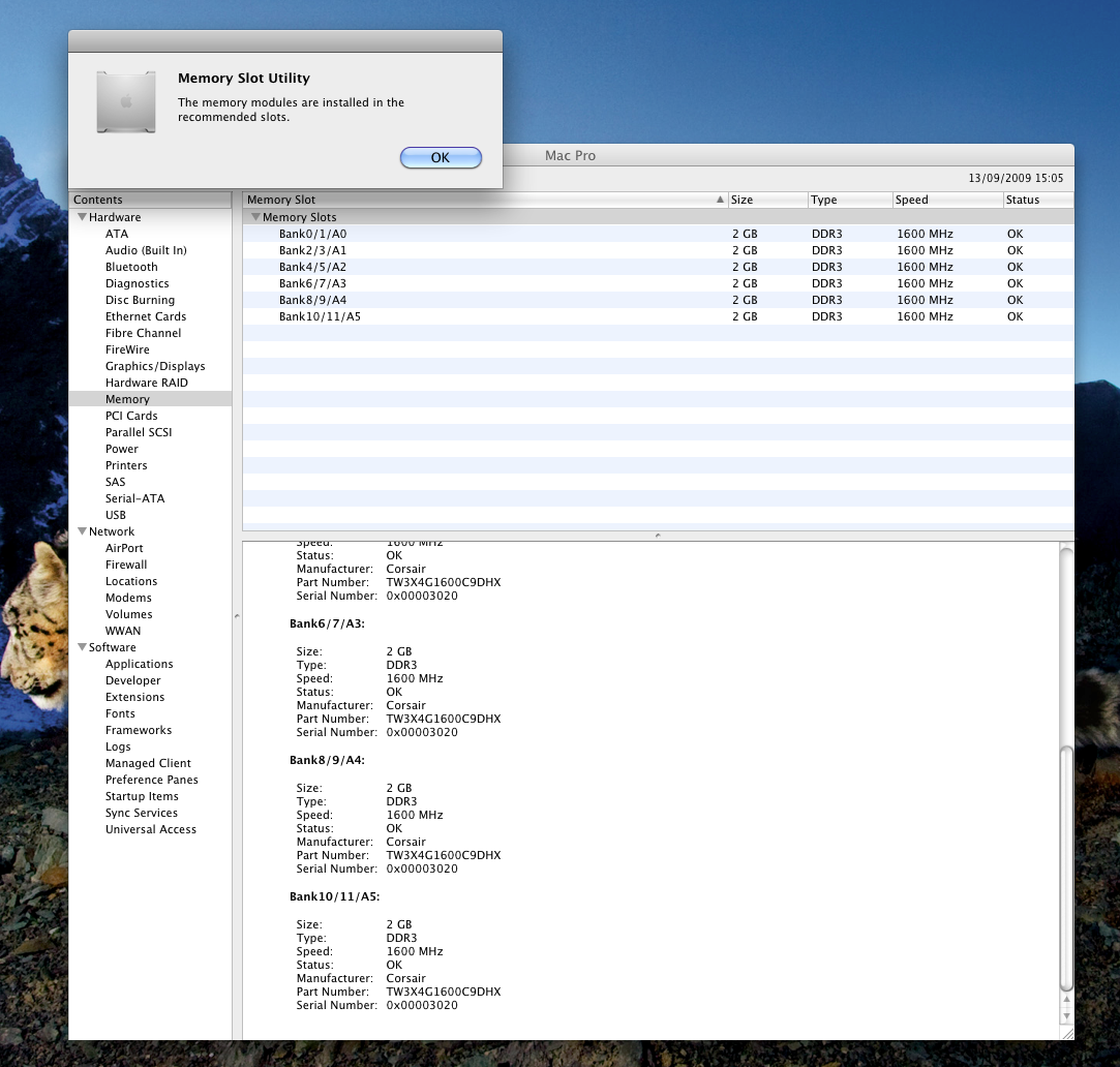

Hi
Just flashed my bios from f4 original to latest f9
This seemed to fix a problem with system profiler not updating from smbios.plist and displaying
12gb in all 6 memory banks.
Also noticed a new pop up memory utility - where did that come from?
(I loaded the new fakesmc v2 yesterday but this only appeared after bios flashing)

Here is a pic of the memory utility and working 12gb - this had been bugging me for ages
4. Reboot
That kext list includes the Realtek kext not the AppleRTL8169 one!!??
