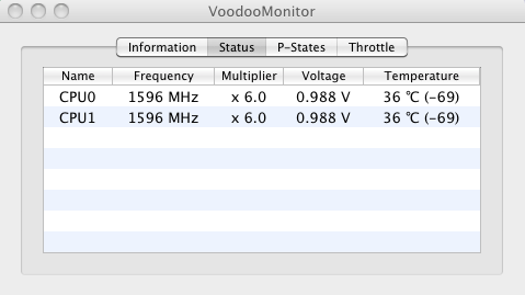

valv Posted April 1, 2010 Share Posted April 1, 2010 are you saying your working with your native SSDT tables ? yep Have you tested with voodoomonitor to see if you have speedstep is working without and DSDT edit or SSDT table override using your current model Mac ID? already looked into voodoomonitor (without coolbook / cpu-x showing max freq) and it shows speedstep is working nicely without editing DSDT; also vanilla SSDT shows speedstep. but not without SSDT override (extracting vanilla tables, changing memory adresses caught by using VK, and loadin'em back with AnV's branch of Chameleon). As I said on an earlier post, it seems to be a problem with the fsb value. Somehow, as soon as I changed it from 266 to 280 Mhz on smbios.plist, I ended with every thing working; eventhough still seeing same freqs as old fsb value. Having tried with Macbook4,1 first and that also worked oob / then switched back to mbp5,4 as it narrows my specs (look into my sig) and that also worked. Only got to leagcy my smc plugin. Uninstall coolbook 2.16 and erase the coolbook.app from Applications, then do a clean installation from coolbook.dmg --- placed to Applications and run it... done! You should see the p-states changes in frequencies and voltages. Seems this happens in every system update... and I am sure in every FID-VID SSDT modification for me. ok thank u juanerson, am gonna try this out and tell u back Link to comment https://www.insanelymac.com/forum/topic/181631-dsdt-vanilla-speedstep-generic-scope-_pr/page/55/#findComment-1439267 Share on other sites More sharing options...

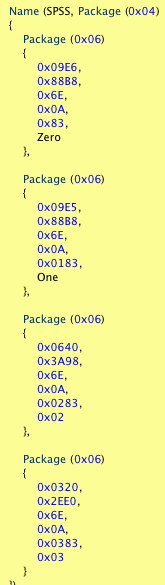

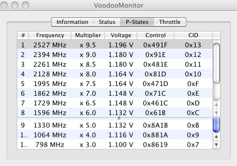

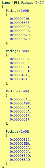

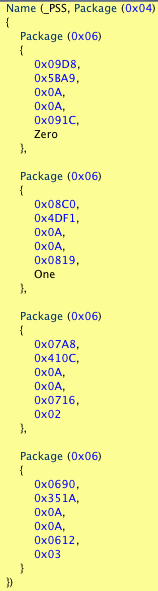

valv Posted April 1, 2010 Share Posted April 1, 2010 here we go again, on SSDT-2 I've got _PSS & SPSS showing like this (before any edits) Then, I edit my _PSS section using p-states calculator to end up with these BTW: On VoodooMonitor I get 11 p-states whatever I change with those values my lowest p-state is shown here that means it doesn't take count of the last 3 p-states Regarding FSB, my smbios.plist I inject those values <key>SMexternalclock</key> <string>280</string> <key>SMmaximalclock</key> <string>2527</string> this is confirmed into System Profiler, as u can see here But again VoodooPower shows those values what the heck is this? why is voodooMonitor not showing the new FSB value I injected? Juanerson, I made exactly what u've been suggesting, and noway: I get always the same values back. Something abnormal thoe: coolbook shows jumps between first and last p-state (for me those are: 1596Mhz/0.9375V & 2394Mhz/1.0625V) Link to comment https://www.insanelymac.com/forum/topic/181631-dsdt-vanilla-speedstep-generic-scope-_pr/page/55/#findComment-1439352 Share on other sites More sharing options...

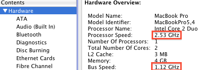

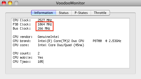

FKA Posted April 1, 2010 Author Share Posted April 1, 2010 what the heck is this? why is voodooMonitor not showing the new FSB value I injected? possibly voodoomonitor is reading the FSB correctly rather than taking your SMBIOS injected value. Link to comment https://www.insanelymac.com/forum/topic/181631-dsdt-vanilla-speedstep-generic-scope-_pr/page/55/#findComment-1439672 Share on other sites More sharing options...
valv Posted April 1, 2010 Share Posted April 1, 2010 possibly voodoomonitor is reading the FSB correctly rather than taking your SMBIOS injected value. so how-comes to speedstep being only working when the FSB is (280Mhz) different from correct value (266Mhz) ? If voodooMonitor is like you said readin' the FSB correctly, it wouldn't do better than kernel. so why this little change is making all the difference in my case ? Formerly, I know there is a part of truth in your answer, because even coolbook is showing the same as voodooMonitor. but I cannot understand why speedstep happens to work correctly only when injecting a different value of FSB into smbios.plist. Link to comment https://www.insanelymac.com/forum/topic/181631-dsdt-vanilla-speedstep-generic-scope-_pr/page/55/#findComment-1439690 Share on other sites More sharing options...
FKA Posted April 1, 2010 Author Share Posted April 1, 2010 Formerly,I know there is a part of truth in your answer, because even coolbook is showing the same as voodooMonitor. but I cannot understand why speedstep happens to work correctly only when injecting a different value of FSB into smbios.plist. That I dont know .. it is odd! Link to comment https://www.insanelymac.com/forum/topic/181631-dsdt-vanilla-speedstep-generic-scope-_pr/page/55/#findComment-1439882 Share on other sites More sharing options...
