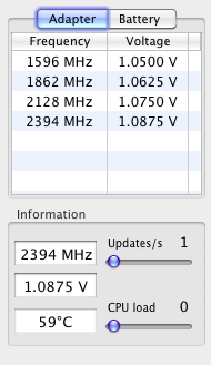

I appear to have vanilla speedstep working on my fujitsu siemens AMILO XI 3650.
I appears to be shifting through the p-states and c-states are also working
I have changed the model in smbios.plist to MacBookPro5,1 and also changed lpc kext to the proper id to
get lpc kext to load.

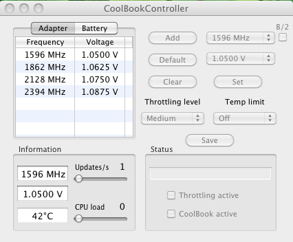

Everything works great but one problem it just seems to randomly freeze could be 10min could be 30 seconds
Cant figure out whats causing it . according to coolbook the correct steps and voltages are being used
The macbookpro 5,1 has the same cpu which is a p8600 2.4ghz
Is it a cpu issue or could it be the gpu which is a geforce 9600m gt cant see its temp in osx
could it be overheating , anybody know whats causing the random freezing ?

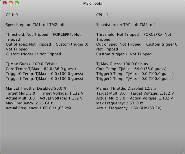

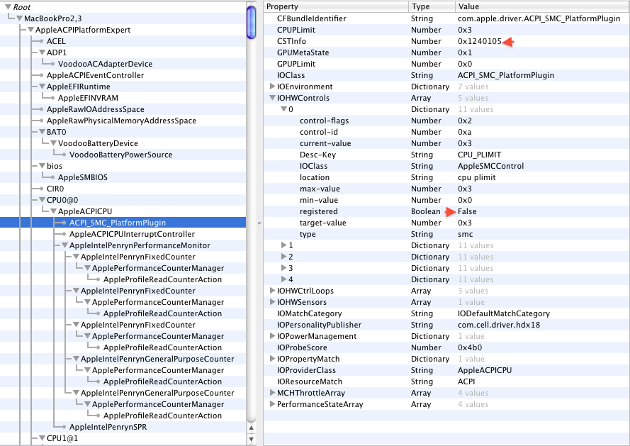

I have C-states showing on IORegExplorer as u ca see
msrtools shows that speed-step is on
The thing is even if my cpu temp gets between 31~46C, the cpu doesn't seem to throttle. looking into coolbook, I see the lowest P-State

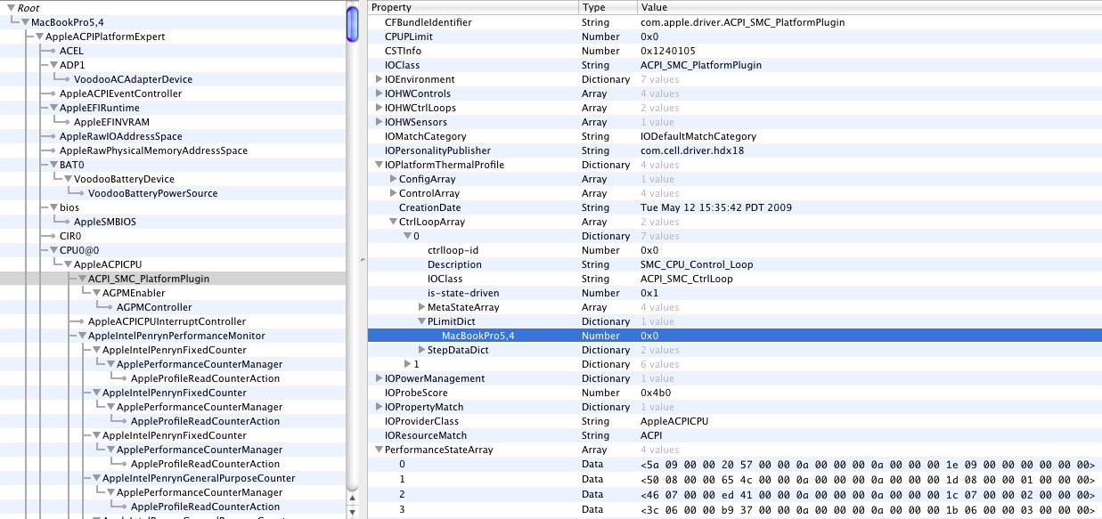

thank u for replying,
the thing is I was already using MacBookPro5,4 without success; on my legacy acpi_smc_plugin however I used a fake model (as Silencer suggested on one of his guides)
and those are kexts I use from E/E/:
AppleAcpiPs2Nub
Fakesmc
Cpuinjector
VoodooPs2Controller
Voodoobattery
though I will try it your way and tell u :rolleyes:
oh, forgot to explain my self, my cpu is p8700 core2duo with 2,533Ghz that's why I chose Mbp5,4 as it has same pross.
I remade my config as u suggested and now am running into same trouble
and it gets even warmer as it now hangs on first p-state.
one more question what is the CPUPLimit and how to modify it
the only diff I can see is the _PR declaration, for Formerly it looks like this

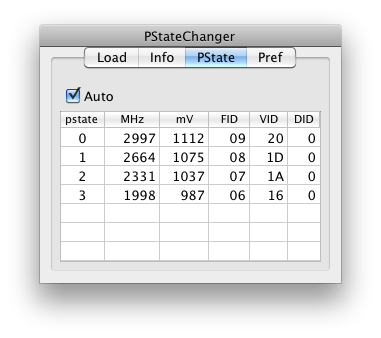

I'm trying to obtain the FID/VID values for the Q6600 CPU. There is a problem. PStatenChanger shows the same VID (28, 28, 28, 28). Please check the attached image.
I have NullCPUPowerManagement and Sleepenabler enabled, but I'm unable to boot OS X without NullCPUPowerManagement.
Any idea how can I solve this problem ? Thanks!
zoliky - you need to removed NullCPUPM kext and sleepenabler and use voodoopowerstate kext instead.
This will give you you fid and vid values in p-statechanger. Edit DSDT with values then removed voodoopowerstate kext .
Please read the 1st post again.
D
