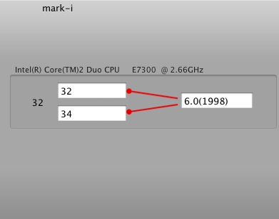

Hi, thanks for information. In my case (C2D E7300@ 3.0 GHz OC (2.0-3.0 GHz), GAEP35) i get same low temps with 0x01 and 0x9D. So seems doesnt matter.
32/34 degrees Celsius in both cases running OS X desktop with no mosue move / apps running and in slowest Pstate 2.0 GHZ (from max=3.0 GHz)
(I dont stay outside in ALSAKA - room temp for those 32/34 Celsius is 20 Celsius :P )

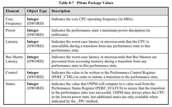

Where does that definition for that field come from? According to ACPIspec40.pdf, those fields are:
The last two fields are what we're talking about. The spec is pretty general about them, and they don't appear to contain any useful data other than being opaque identifiers. I might be wrong, but if so is there somewhere that describes them as something more important?
Got from another forum.
MP31.zip
Do you have MacPro4,1 as well?
Yep-. That ACPI definitions of the PSS are very basic. The 5. value is that what controls FSB multiplier and mVolts.
Last for my knowledge can be used for an compare (after change?) if pstate switch was OK. Normally same as 5. for compareadge.
Perhhaps someone finde an detailed part of the definitions of 5.(major) and 6.(only for compare/checks) values.

Just one question: I need to replace 0x04 with 0x02 in PSD : ?
Name (PSD, Package (0x05)
0x05,Zero,Zero,0xFC,0x04   <--- 0x02 instead of 0x04 ??
I would be grateful for any help!
Yep thats right, page 328 and 329 of ACPI specs, that value relates to the number of processors
