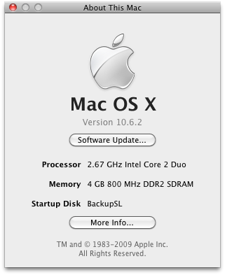

Just finished upgrading to 10.6.2
1. Removed SleepEnabler.kext from my Cham partiton
2. Reboot
3. Apply 10.6.2
4. Auto-reboot
5. Install latest Netkas SleepEnabler.kext on my Cham partiton
6. Reboot
All done. It's only been a few minutes, but everything seems to be working fine, no mouse lag or any other odd behavior (or worse).
Never had such an easy update (well, maybe 10.6.1 :P ) ! Thanks again blackosx !

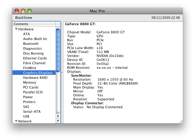

I always use only USB-stick to boot from (enabled in mobo to boot first from). I had no problems what so ever (except removing the sleepenabler.kext and install new one). Efi-studio with 8800 gt and fully working (since 10.6). DSDT is without strings.
I have several USB sticks (with same extensions etc just for backup) and it´s pretty easy to modify them and test how it´s it doing. Also, my mobo allows to choose where to boot from (F12 for XP 64, because 10.5 efi doesn´t support XP).
EP35-DS3R
Q6600
750 GB Seagate
8800 GT Evga SSC
4 GB 800 Mhz @ 960 Mhz
Extensions:
AHCIPortInjector.kext
ALC889A.kext
Disabler.kext
fakesmc.kext
NullCPUPowerManagement.kext
OpenHaltRestart.kext
SleepEnabler.kext
64 bit enabled with arch=x86_64
