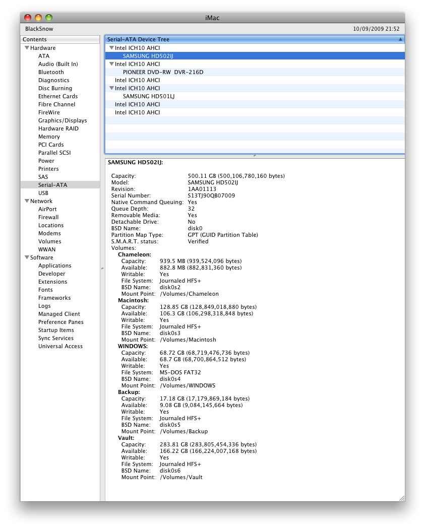

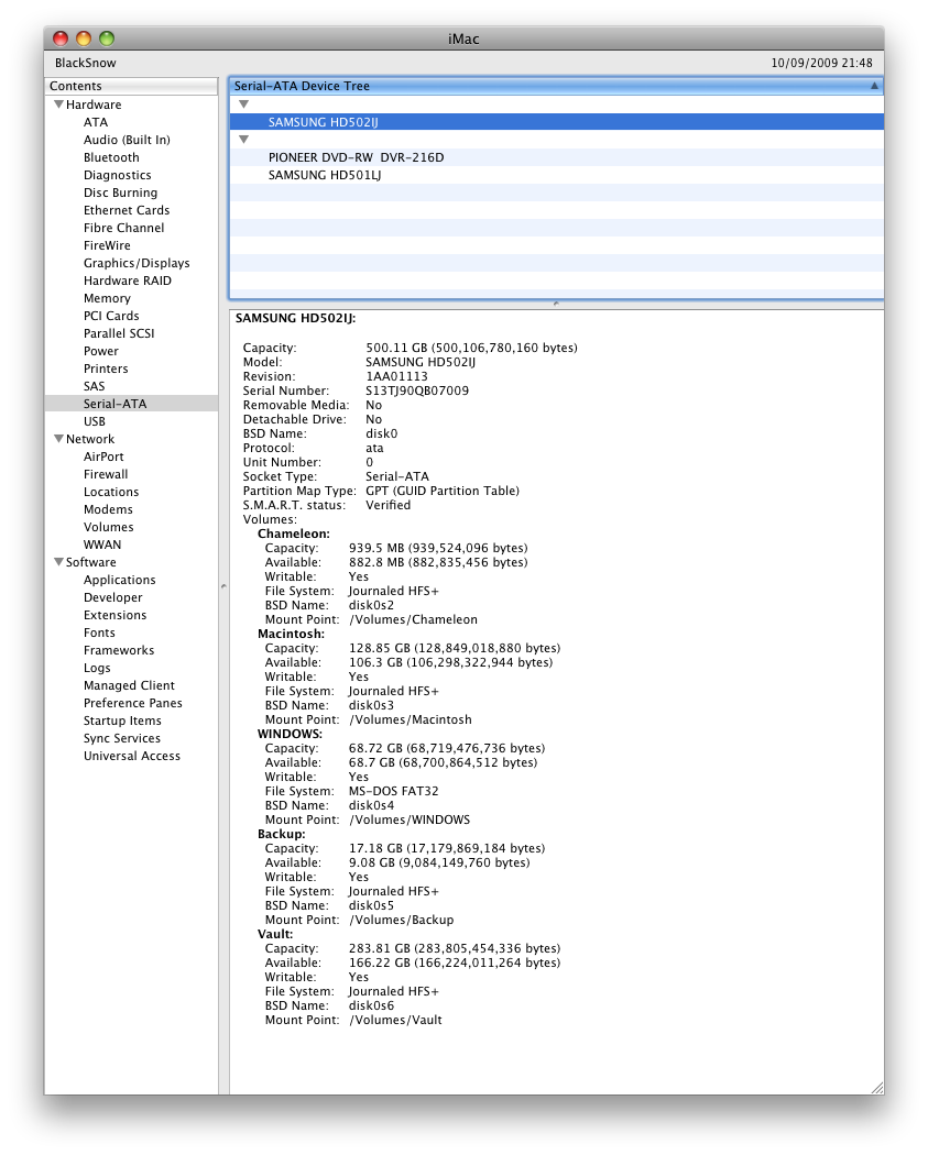

Thanks, I have just added AppleIntelPIIXATA.kext to my /E/E and I will try rebooting with BIOS AHCI mode disabled.. (not just yet, as I am doing some PHP coding, but in a little while)
EDIT: I have just done my tests with using AppleIntelPIIXATA.kext and AHCI mode turned off.
Well it does work just as -pacific-aya described, and boot time is faster but on my system, not by much.
But the problem I see with this, is you lose the benefit of AHCI. And one of the benefits is NCQ (Native Command Queuing), which increases the performance of SATA HDD's. Now whether or not this is noticeable in real world use is another thing, but personally I'll stick to running without adding it as I have SATA. But for anyone using ATA drives, then this is the way to use Snow Leopard.
See the attached screenshots from System Profiler with and without loading AppleIntelPIIXATA.kext at boot. Without it you will see OS X recognised the ICH10 on the GA-EP45-DS3L natively.

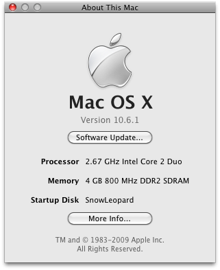

10.6.1 is out and available via Software Update.
As normal it's always wise to run the update to a backup/test volume first. I have just done so and it works fine ;)
Note: Make sure you have stuck to this install guide to keep the system untouched and not added extra stuff to /SL/E.

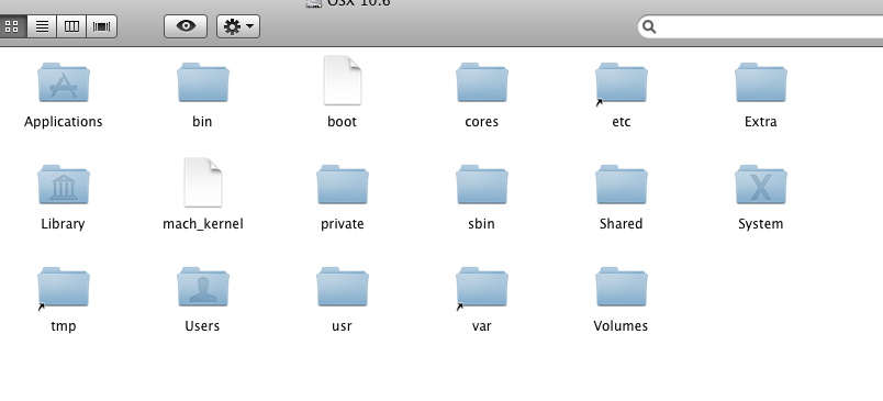

this is what i see in 10.6 when i browse my system volume with finder
does this look normal? when i installed 10.5.8 i didnt see the other directories (dev, net, sbin, cores... etc). I just had the special folder ones (system, library, applications and users).
Is this a problem? and how can i hide these special folders.
i had this same problem when i installed with the OSInstall.mpkg method. it has been determined that you should avoid installing with this method as it is known to cause issues/errors.
when i re-installed via the USB stick method, my folder structure looked correct (Applications, Library, System, Users).
try re-installing SL via a bootable usb stick and i think your problem will be solved, i know mine was.
