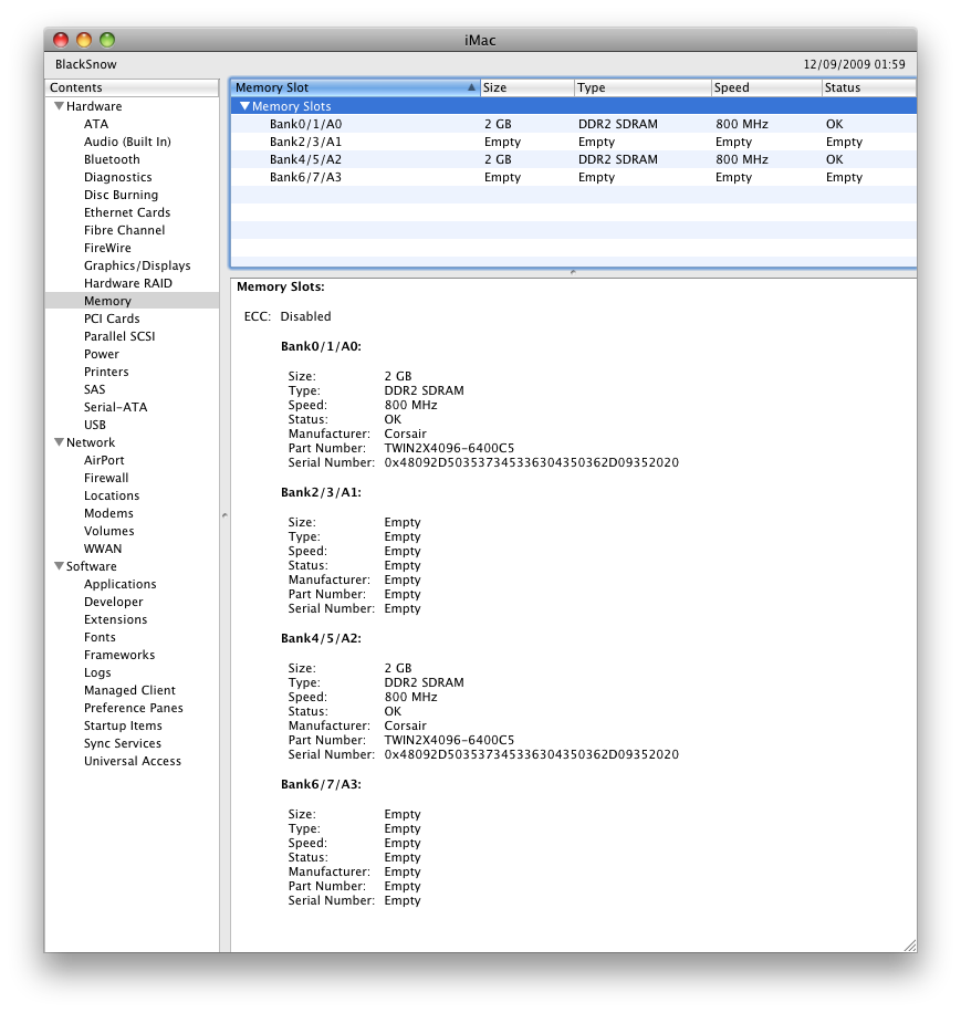

kreayshunist Posted September 12, 2009 Share Posted September 12, 2009 It seems to be the power supply. I opened it up and I realized that I still had a 430W unit in there. I meant to replace it with something beefier but never got around it. I suppose running two monitors on the power hungry 9800 with an overclocked CPU, 8GB of memory, two hard drives, and a phone charging from USB was a little too much for it. Does anyone have any suggestions for a good 550W - 600W class power supply? I've always used CoolerMaster and Antec, but I'm open to other ideas. Another thing I noticed: System Profiler now tells me "there was an error while gathering this information" when I view the Memory entry. Before with 10.6.0 and Cham RC1 with netkas' boot file it correctly identified all modules. Does anyone else have this? Or is this, too, a product of my own stupidity? lol Link to comment https://www.insanelymac.com/forum/topic/180954-guide-vanilla-retail-106x-with-chameleon-v2-for-gigabyte-ga-ep45-ds3l/page/34/#findComment-1262451 Share on other sites More sharing options...
blackosx Posted September 12, 2009 Author Share Posted September 12, 2009 At least you have tracked down the issue. I am using an Antec 500W EarthWatts PSU, and for me it's been great. I have also just tried to view memory in System Profiler and it tells me "there was an error while gathering this information" too. But I have been messing about with different SMBIOS's and the one I am currently using doesn't contain and info for my memory... so I don't know if that makes a difference. I have updated the Install Guide PDF to v2.4. Link to comment https://www.insanelymac.com/forum/topic/180954-guide-vanilla-retail-106x-with-chameleon-v2-for-gigabyte-ga-ep45-ds3l/page/34/#findComment-1262459 Share on other sites More sharing options...
kreayshunist Posted September 12, 2009 Share Posted September 12, 2009 I've removed memory information from the SMBIOS, too, but it just showed it as Apple memory with a serial number of ABCDEFGHIJ. The size and speed were correctly identified, though. I'll try netkas' boot file in a few. Link to comment https://www.insanelymac.com/forum/topic/180954-guide-vanilla-retail-106x-with-chameleon-v2-for-gigabyte-ga-ep45-ds3l/page/34/#findComment-1262478 Share on other sites More sharing options...
blackosx Posted September 12, 2009 Author Share Posted September 12, 2009 I have just rebooted using my original SMBIOS.plist I built and the Memory show fine now in System Profiler So yes, it's a SMBIOS issue. My SMBIOS contains the proper memory identification, manufacturer, serial numbers etc.. and it reads perfectly. I was just doing test earlier to see if a different SMBIOS gave me a different Geekbench result. Link to comment https://www.insanelymac.com/forum/topic/180954-guide-vanilla-retail-106x-with-chameleon-v2-for-gigabyte-ga-ep45-ds3l/page/34/#findComment-1262484 Share on other sites More sharing options...
