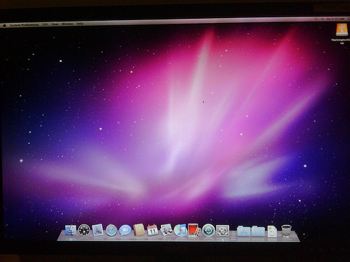

blackosx Posted September 11, 2009 Author Share Posted September 11, 2009 Got the bootCD to boot!! Confirmed needed a SATA DVD drive. Boots perfectly. Now to install Snow! I will post screenshot if I succeed, wish me luck! Great. I hope the install goes well for you I am trying the CD method, but I am getting the spinner and it goes on and on for ever.Please check my image out. Its been stuck there for hours now. What motherboard and hardware are you using ? @adrian mak - Same question to you.. Link to comment https://www.insanelymac.com/forum/topic/180954-guide-vanilla-retail-106x-with-chameleon-v2-for-gigabyte-ga-ep45-ds3l/page/33/#findComment-1261193 Share on other sites More sharing options...

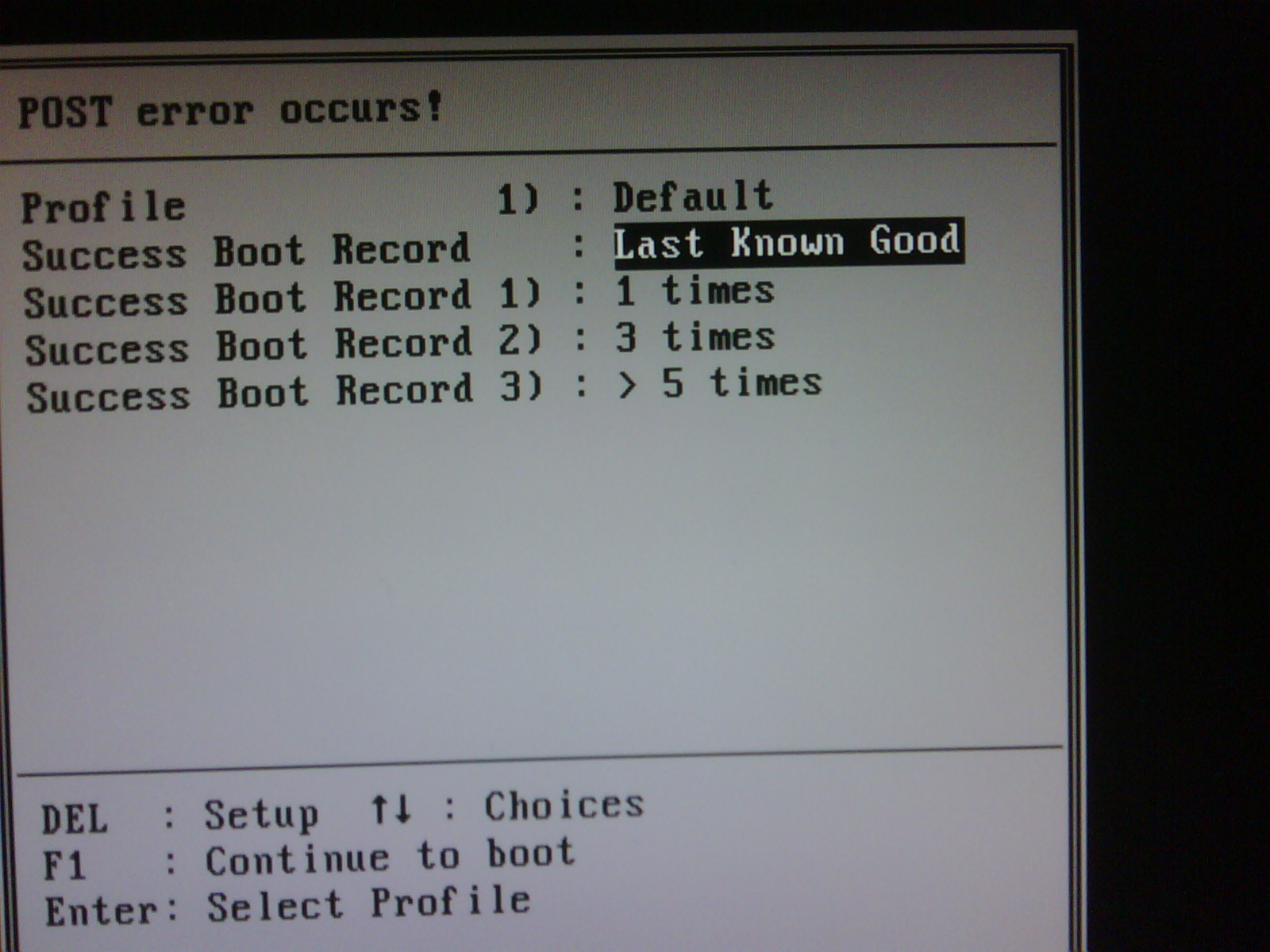

Carlos Taborda Posted September 11, 2009 Share Posted September 11, 2009 Great. I hope the install goes well for you What motherboard and hardware are you using ? I am using a Gigabyte GA-EP45-DS3L as well, same setup as yours. Also, I restarted it andI got the POST ERROR Occurs. Link to comment https://www.insanelymac.com/forum/topic/180954-guide-vanilla-retail-106x-with-chameleon-v2-for-gigabyte-ga-ep45-ds3l/page/33/#findComment-1261198 Share on other sites More sharing options...
blackosx Posted September 11, 2009 Author Share Posted September 11, 2009 I am using a Gigabyte GA-EP45-DS3L as well, same setup as yours. Try resetting your BIOS to defaults, then just enabling AHCI and HPET to 64-bit. Maybe try unplugging any other SATA HD's than the one you want to install to? EDIT: - Yes you will get a CMOS error. Read the guide!... So you only want to use the BootCD as little as possible. Link to comment https://www.insanelymac.com/forum/topic/180954-guide-vanilla-retail-106x-with-chameleon-v2-for-gigabyte-ga-ep45-ds3l/page/33/#findComment-1261201 Share on other sites More sharing options...

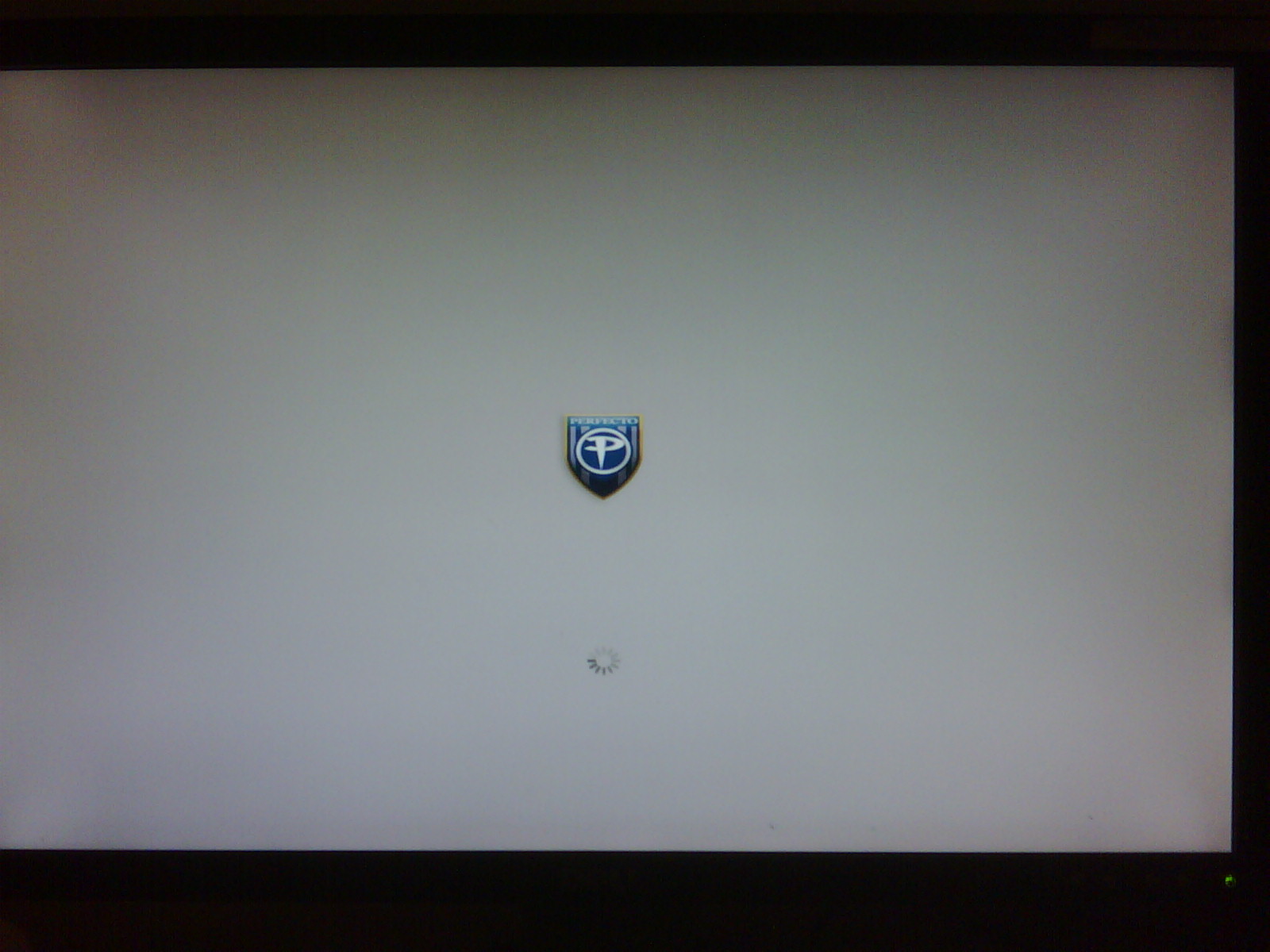

Godowski Posted September 11, 2009 Share Posted September 11, 2009 Hey there, Hope to get some insight from you. You installed using the 8GB USB disk mode, right? I am trying the CD method, but I am getting the spinner and it goes on and on for ever. Please check my image out. Its been stuck there for hours now. I have same problem weeks ago, it is same with Boot CD, with USB installation, OSinstall.mpgk. I can not boot Snow ... maybe here in southern Europe it is too hot for Snow Leopard Link to comment https://www.insanelymac.com/forum/topic/180954-guide-vanilla-retail-106x-with-chameleon-v2-for-gigabyte-ga-ep45-ds3l/page/33/#findComment-1261305 Share on other sites More sharing options...

Godowski Posted September 11, 2009 Share Posted September 11, 2009 Hi The Alchemist I have explained how to get ALC888 sound working for the GA-EP45-DS3L using my DSDT guide and this guide. If it doesn't work for you and you want to use a modified AppleHDA.kext then go ahead and find one that has been successfully reported as working for you mobo. Or you could always have a look at using VoodooHDA. Have a search for it. Again, for your USB. What I have in this guide works for the GA-EP45-DS3L. Any specifics for other motherboards belong in another thread. What do you mean? Are you saying you have successfully installed Snow Leopard but you can't boot it? I start from the scratch with new boot cd rc3, I switch the disk with Snow Retail hit F5 icons become refreshed and than start installation but stop at spinning circle. Cannot boot with arch=386 too. I tried to install with USB or OSinstall.mpkg and installation complete fine boot again stuck at the first boot on that spinning circle.. Link to comment https://www.insanelymac.com/forum/topic/180954-guide-vanilla-retail-106x-with-chameleon-v2-for-gigabyte-ga-ep45-ds3l/page/33/#findComment-1261421 Share on other sites More sharing options...
blackosx Posted September 11, 2009 Author Share Posted September 11, 2009 Hi Godowski Well done for including a signature of your hardware. First thing I notice is you'll have to find out how to patch your graphics drivers for your Radeon 4870. You will need to read here. Now I don't know if that's the cause of your failed boot, but it might be. Have you tried booting with -v (verbose mode) to see where the boot process fails? Link to comment https://www.insanelymac.com/forum/topic/180954-guide-vanilla-retail-106x-with-chameleon-v2-for-gigabyte-ga-ep45-ds3l/page/33/#findComment-1261463 Share on other sites More sharing options...
Godowski Posted September 11, 2009 Share Posted September 11, 2009 Hi Godowski Well done for including a signature of your hardware. First thing I notice is you'll have to find out how to patch your graphics drivers for your Radeon 4870. You will need to read here. Now I don't know if that's the cause of your failed boot, but it might be. Have you tried booting with -v (verbose mode) to see where the boot process fails? I have only one HDD at SATA0 and Pioneer SATA DVD at SATA3 1. I load default settings for bios ver.9, then set SATA to AHCI, enable HPET and set to 64bit, and I also must enable usb support for mouse and keyboard. Should I change anything else? 2. Start machine with new RC3 boot CD ... change with retail DVD hit F5, and then my icons rearrange - my DVD become last and change from P45-DS3L to Mac OS Install DVD.. 3. I run install and it freeze at the spinning circle.. I have tried with -v and saw that startup is freezing after AppleRTL8169 ethernet address: XXXXXXXX If I boot with arch=386 -v the first booting - installations stop at: AppleRTL8169 ethernet address: XXXXXXXX virtual bool IOHIDeventSystemUserClient:: initWithTask (task*, void*, UInt32): Client task not privileged to open IOHIDSystem for mapping memory Do you think that my ATI 4870 is problem? And if it is - than I must install from working Leo, because I cannot patch with boot CD? tnx for your time Link to comment https://www.insanelymac.com/forum/topic/180954-guide-vanilla-retail-106x-with-chameleon-v2-for-gigabyte-ga-ep45-ds3l/page/33/#findComment-1261489 Share on other sites More sharing options...
