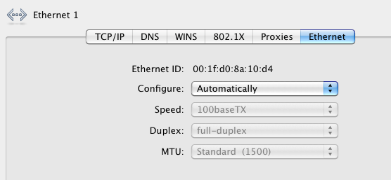

blackosx Posted September 23, 2010 Author Share Posted September 23, 2010 Hi Lnx2Mac - Thanks for coming back Hehe... Guess we Hackintoshers are all OCDs Lol.. yeah. something like that Indeed very low... Are you on Autonegotiated ? What does the Ethernet PrefPane show you as media ? I think I'm on auto negotiated? (my networking skills aren't the greatest).. Ethernet Prefpane here at work shows me: and I think it shows me the same at home. (Need to double check) If you have a 3rd machine it might help cross-testing to try to identify the culprit...Or could that be the switch ? I do have another PC running Vista at home, I'll have to re-test using that. I'm using this Netgear Rangemax ADSL Modem / Route That looks better, and could match a 100TX network... not a Gigabit.Yeah. Looks like it's negotiated a 100TX link... not a Gigabit. Cool. Yeah at work it's not a gigabit switch. So my results look normal here then? I was encouraged by the test with the iMac i7 to Windows PC test being the same as my hack though. netperf -D -l 60 -H 192.168.0.19 -t TCP_STREAM My Hack 8192 131070 131070 60.01 93.50 iMac 8192 131070 131070 60.01 93.91 This looks OK, and note it's mainly influenced by the CPU load of the machines. That's understandable and explains the differences. Hmmm... This one looks weird. Is this TCP_STREAM or TCP_RR ?Might be a copy-paste bug ? I'm not sure now!.. (Doh!) but the Windows version of netperf didn't allow the -D option saying it needed to be compiled with -DINTERVALs included or something like that. So that could be either.. I can check again? Hmmm.... Note also how in all cases with Windows, the Recv Buff is only 8K... Yes. I did notice some results only giving 8K. What could that be? So to summise from my testing today on the network at work along with your comments, I tihnk it's safe to say that my machine seems to score normal results expected for a 100TX network. So I just need to have a deeper look in to my home network settings? It's time for me to leave work now, so I'll hopefully grab a bit of time later tonight (or if not, in the morning) to double check my home network settings. Thanks again for your kind help and input. EDIT: I have tested with netperf at home from my hack to another Vista PC and this time the results as promising, which now means the issue lies with my Windows 7 machine! netperf -D -l 60 -H 192.168.0.2 -t TCP_STREAM Recv Send Send Socket Socket Message Elapsed Size Size Size Time Throughput bytes bytes bytes secs. 10^6bits/sec 8192 131070 131070 60.01 92.97 However the 2nd test showed a slight less convincing result? Transfer rate in the 100's not 1000's ? netperf -H 192.168.0.2 -t TCP_RR Local /Remote Socket Size Request Resp. Elapsed Trans. Send Recv Size Size Time Rate bytes Bytes bytes bytes secs. per sec 131070 262140 1 1 10.00 411.69 8192 8192 Regards blackosx Link to comment https://www.insanelymac.com/forum/topic/180954-guide-vanilla-retail-106x-with-chameleon-v2-for-gigabyte-ga-ep45-ds3l/page/129/#findComment-1553265 Share on other sites More sharing options...

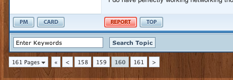

adamdaly Posted September 24, 2010 Share Posted September 24, 2010 Hey, I hope this hasn't been answered within the thread before but going through 161 pages would be pretty time consuming. Anyways i have a nvidia gtx260 and have heard problems with the screen going black after installing sl. But i got this problem just as the install DVD(retail) was loading its stuff. I got to the grey screen with the apple and the rotating thing and then blackness. The monitor stopped receiving data and went into standby mode. The dvd was still loading, its light blinking and the system was still running fine. Any ideas about why this would happen, is it a gtx260 problem. I probably have an old 7600gt lying about here somewhere i could try using. thanks adam Link to comment https://www.insanelymac.com/forum/topic/180954-guide-vanilla-retail-106x-with-chameleon-v2-for-gigabyte-ga-ep45-ds3l/page/129/#findComment-1553918 Share on other sites More sharing options...
blackosx Posted September 26, 2010 Author Share Posted September 26, 2010 Hi adamdaly InsanelyMac's search function makes it easy to look through the 161 pages of this thread. I'm using the 'Insanely Lucid' theme for this forum: And at the bottom left corner of the main window is a search box: Typing 'gtx260' in there shows me these results which I can quickly look through to find some answers. And from looking at it, I guess you will need to be using a recent version of Chameleon which should inject the correct system information for your card at boot. Link to comment https://www.insanelymac.com/forum/topic/180954-guide-vanilla-retail-106x-with-chameleon-v2-for-gigabyte-ga-ep45-ds3l/page/129/#findComment-1554583 Share on other sites More sharing options...
