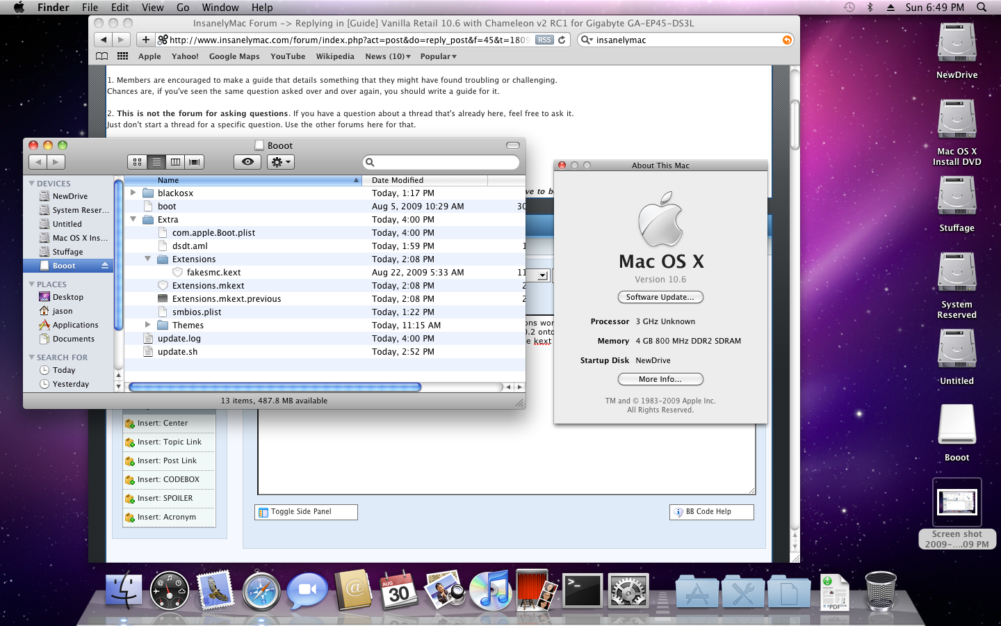

Maybe post a couple of screenshots of your root file structures in finder / Terminal. Is the KP the same as you had in your previous post?

Attachments: My Cham partition and permissions for it.
terminal.tifffinder.tiff

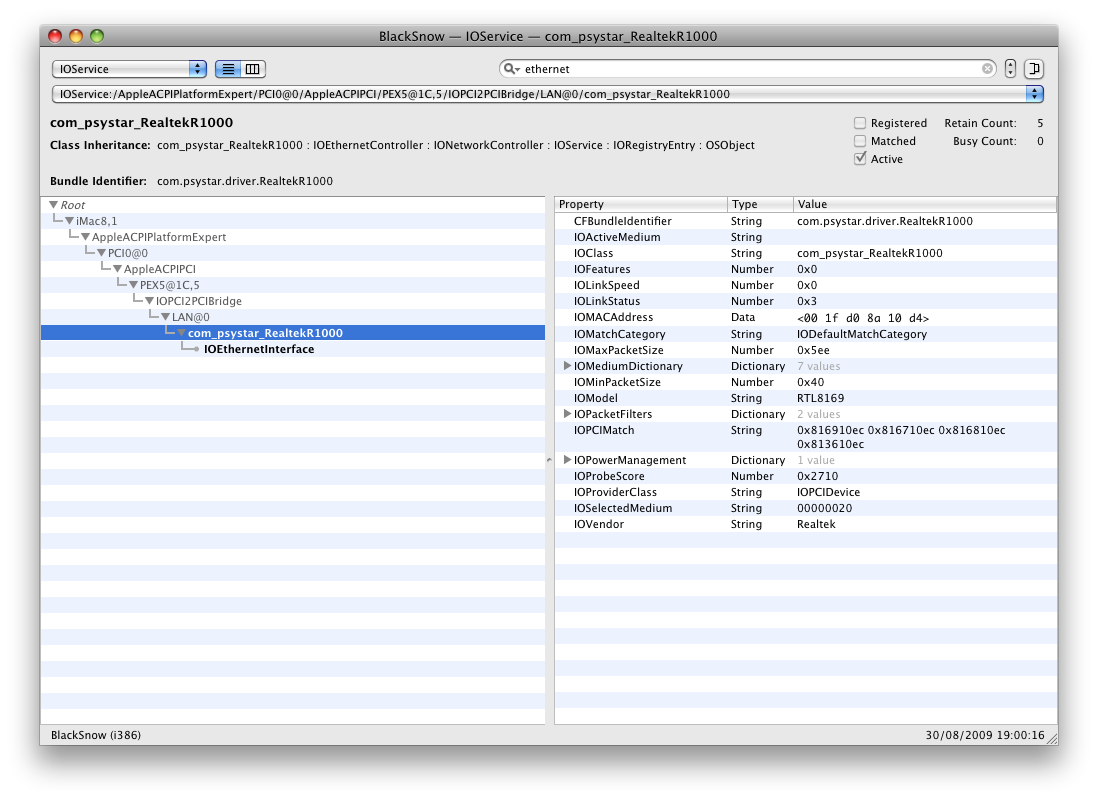

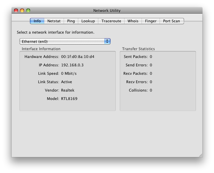

One other thing I noticed: IORegistryExplorer reports the network card as AppleRTL8169Ethernet with model RTL8168C. Is your computer the same?

For IORegistryExplorer, as I have got RealtekR1000 loaded I get this (see attached). I have also attached a screengrab of NetworkUtility. They both show mine as RTL8169.
That may be the reason Bonjour isn't working for me. Is there a way to force load a driver? Other than possibly installing RealtekR1000.kext in S/L I have no other ideas. Shouldn't Chameleon load it from E/E? Sorry if I seem a little clueless as the bulk of my experience is on Apple machines.

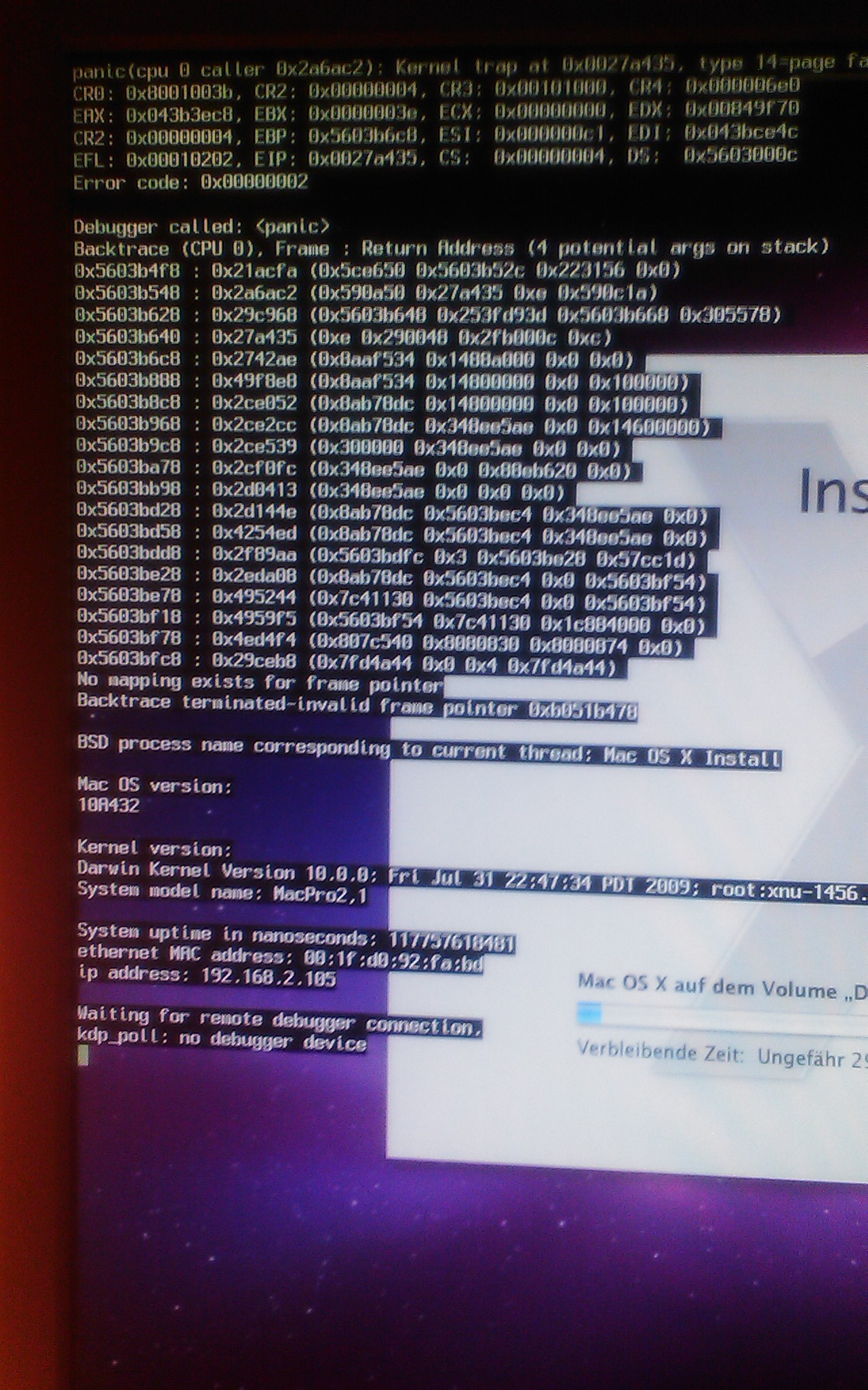

Here's the actual kernel panic I'm getting while installing from USB / HDD and actually in my working Installation, randomly. Getting really annoying. Already completely removed IOATAFamily.kext, but there's more to it..

  • So I have only 2 little problems. Bonjour is not working because I am using x64 version and afaik there is no known fix for that. What worries me more is that SPDIF passtrough is not working for me. I found similar cases but it was always needed to patch AppleHDA.kext somehow. Is there any way to make it work only via DSDT ?

I wasn't able to get Snow Leopard to successfully install from a USB drive, it would KP after a minute or two of installation. I'm not sure what was causing that: I tried installing it several time, all with the same options selected, and it would halt at different positions through the install -- bizarre.
I was able to get a working setup by using the method in which you install from 10.5.8. I repaired permissions by using the Kext Utility Tool in Snow Leopard after an initial KP. If anyone else is having trouble with the USB install method, maybe this is the way to go.
By the way, I'm using a tested DDST file, and running BIOS revision F8 on my EP45-DS3L with a EXGA 9800 GTX+ video card.
